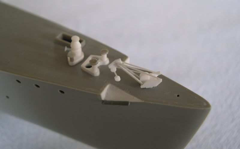

I could not do much in the last days, as I was fully occupied with the corrections of my students´ exams, but at last I could do something else -- capstan and anchor crane, and one of the most interesting pieces onboard this ship : the practice loading machine, a device whose use and usefulness is not clear for me, but that was onboard the ship.

 Post subject:
PostPosted: Tue Dec 26, 2006 7:45 pm
Posts: 10570
Location: EG48
Your work is really nothing short of inspirational.

Willie wrote:
>SNIP< and one of the most interesting pieces onboard this ship : the practice loading machine, a device whose use and usefulness is not clear for me, but that was onboard the ship.
That was used to help the crew train for loading the actual 5 inch and 3 inch guns on the ship, hence the name Practice Loader. Not having to use the real gun it made it easier for crews to not have to worry about accidents (not accidentaly shooting the gun during practice, or not making mistakes when actually needing to use the gun in combat.)
Hopefully that helps a little :thumbs_up_1:

 Post subject:
PostPosted: Wed Dec 27, 2006 12:29 pm
Posts: 681
Location: Vigo, Spain
Thank you all for your kind remarks on my humble work.
I presumed it had to do with artillery -- appart from the very shape of the thing, loading has a very restricted lexical field onboard a warship :cool_2: -- but I was not sure, though I can remember now that the Bismarck had such a device ahead of turret Caesar as well.
thanks for your kind explanation, and best regards,
Willie.
 Post subject:
PostPosted: Wed Dec 27, 2006 2:37 pm
Posts: 10570
Location: EG48
THe practice loader also helped prevent wear on the actual weapons. I've read stories of competitions where different gun crews would see which one could "fire" 100 rounds the fastest through the practice loader.

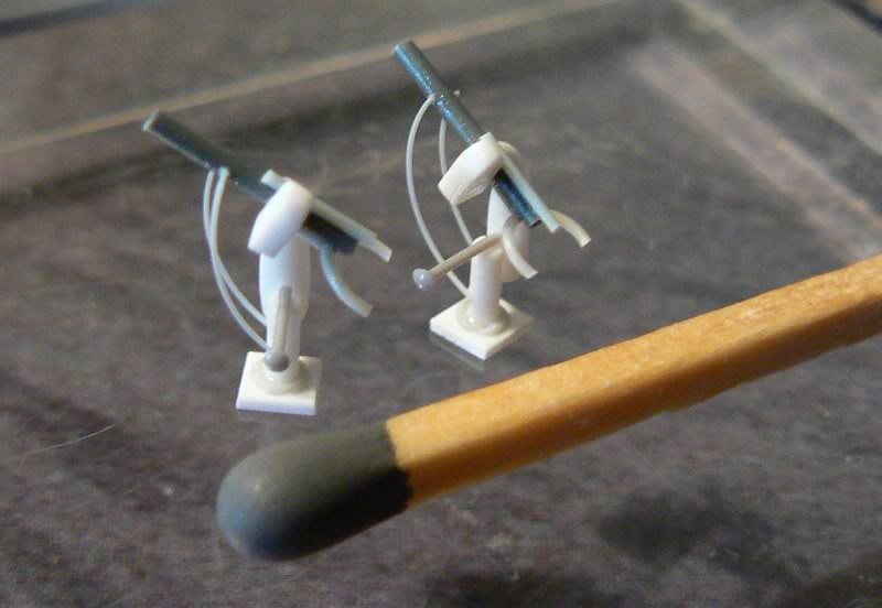

PostPosted: Sun Jan 07, 2007 9:19 am
Posts: 681
I was lucky enough to find a couple of reasonably clear pics of the .50 machine gun onboard a flushdecker, so the construction was not too difficult nor long.
And this is what I was able to produce:
I hope you like them.
Best regards,
Willie.
 Post subject:
PostPosted: Sun Jan 07, 2007 12:06 pm
Posts: 10570
Location: EG48
Very well done! I notice that the lines you have hanging down front are nearly a symmetrical curve; If this was to simplify construction all the better, but these were hoses for the water cooling and my only comment is that *if* you do more you might want to make them look a little more limp.
However, still very inspirational... makes me wish I hadn't already finished mine!
 Post subject:
PostPosted: Sun Jan 07, 2007 1:05 pm
Posts: 681
Tracy,
You are but very right.
I actually realized that these were the hoses for the water cooling, but I had to achieve a compromise between the lenght of the hoses, the rough shape of them when hanging and the tension that they suffer when they are first attached to the rod (or just the opposite) while the glue is not dried yet, as they have to be glued in two phases.
I have not put any kind of optics either (though they can be clearly seen in the pic as well), as I was not able to produce a round piece of plastic thin enough to suit this scale.
Very best regards from accross the Atlantic,
Willie.
