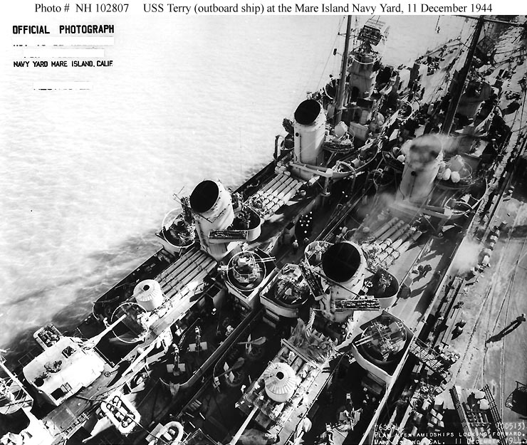

Detailing the funnels begins; insides first. The Lindberg funnels, except for the caps,
match the plans from Floating Drydock so I am using them. The caps need only slight
reshaping so are usable and need interior detailing. On a real Fletcher, there is a
platform inside the cap containing two openings for two uptakes per funnel separated
by baffle. The baffle on some ships was smooth, others were ribbed. The uptake
openings have a diamond-pattern grate mounted inside the uptake slightly below the
top of the opening.
The kit's funnel halves were assembled then the funnel caps were cut off using a razor
saw. The interior was the built up from Evergreen styrene and K&S brass photo-
etched mesh. The top of the baffle will be trimmed later and stiffeners will be added
across the top of each cap.
A real Fletcher's funnels are raised above the midships deckhouse by a rectangular
structure that acts as a funnel base. Lindberg does not include these funnel bases in their
kit. New bases were fabricated for each funnel from styrene strip.
The exterior of the funnels and their respective platforms will be detailed later.
Click on thumbnail to view larger photo
File comment: DD-804's funnels and funnel platforms appeared almost certainly as these.
Notice differences in these ships' 20mm Oerlikon positions.

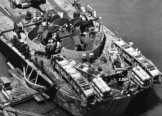

I think you nailed the identity of the depth charges. Here's a photo of depth charges aboard USS Kidd:
Thanks to Bruce Ross for the photo!

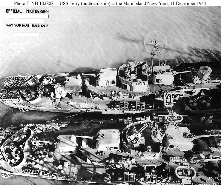

Aft, 20mm "Heart Tub" is installed. There are 37 pieces needed to build this feature.
Three 20mm Oerlikons and their associated crews were protected by this shield. This
splinter shield differed from ship to ship. On Fletchers built at Seattle-Tacoma like
DD-804, the shield was heart-shaped, enclosed three single mounts, and the reinforcing
ribs were welded to the interior. The other common variation was ribs welded to the
exterior. Check your sources carefully for the ship you are building.

Next update: intake vents on the funnels. There are 56 pieces needed to build the intake vents.

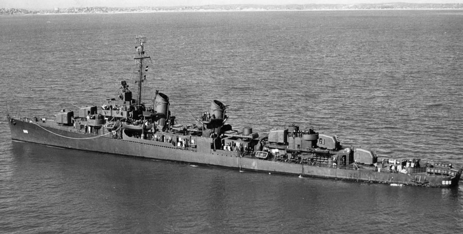

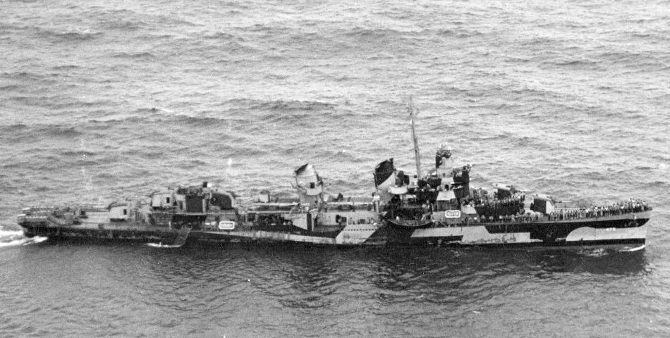

Reid wrote:
...do you anything about the aft shields from fletchers built in Boston?
Generally, the ribs appear to be fixed to the splinter shield interiors with some exceptions: it is difficult to make such a determination of rib locations on the heart tub splinter shields of some Square Bridge ships built at Boston from photos. The photo of USS Connor seems to show exterior ribs on the aft part but a smooth exterior forward. See: http://www.destroyerhistory.org/fletcherclass/582conner_01.html
According to DestroyerHistory.org the Round Bridge Fletchers built at Boston were:
DD-472 USS Guest
DD-473 USS Bennett
DD-474 USS Fullam
DD-475 USS Hudson
DD-476 USS Hutchins
According to DestroyerHistory.org the Square Bridge Fletchers built at Boston were:
DD-581 USS Charrette
DD-582 USS Connor
DD-583 USS Hall
DD-584 USS Halligan
DD-585 USS Haraden
DD-586 USS Newcomb
DD-662 USS Bennion
DD-663 USS Heywood L. Edwards
DD-664 USS Richard P. Leary
File comment: A clear photo of USS Haraden (square bridge built at Boston) shows that her
heart tub ribs were fixed to the splinter shield exterior.
File comment: Likewise, a clear photo of USS Hudson (round bridge built at Boston) seems to
show that her heart tub ribs were also fixed to the splinter shield interior.
File comment: A clear photo of USS Guest (round bridge built at Boston) seems to show that
her heart tub ribs were fixed to the splinter shield interior.

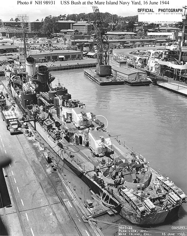

Funnel intake vents are fabricated and installed. There are 7 parts to each intake vent for a total of 56 parts.
Some final shaping and cleanup of the vents is yet to be done to even out their appearance in relation to each other
and there is much more detailing to be done to the funnels, platoforms and searchlights. The funnel caps will be
replaced with more accurately shaped caps later. A director platform will be added to the aft funnel. Both funnel
platforms will have underside structural members added as well as rails.
File comment: Notice the funnel vent style and the closeness of the individual louvers to one another.
