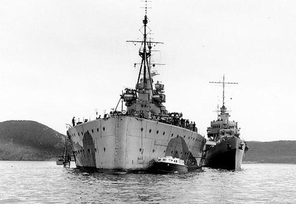

Yep, that pic is correct, here's a pic of PoW awaiting FDR showing A and B turrets, you can clearly see the Pom Pom fitted to B turret, which means the UP's were gone at that date and replaced with Pom Pom's. After the loss of Hood, all UP's were "quietly" removed from all RN Capital ships. The only reason they were fitted in the first place was because Proffesor Lindermann (the guy who designed them) was a personal friend of Churchill
also, if you enlarge this pic which was taken as FDR arrived on PoW, and look straight up from the upper rearmost starboard porthole, you can just make out the barrels of the Pom Pom on Y turret.

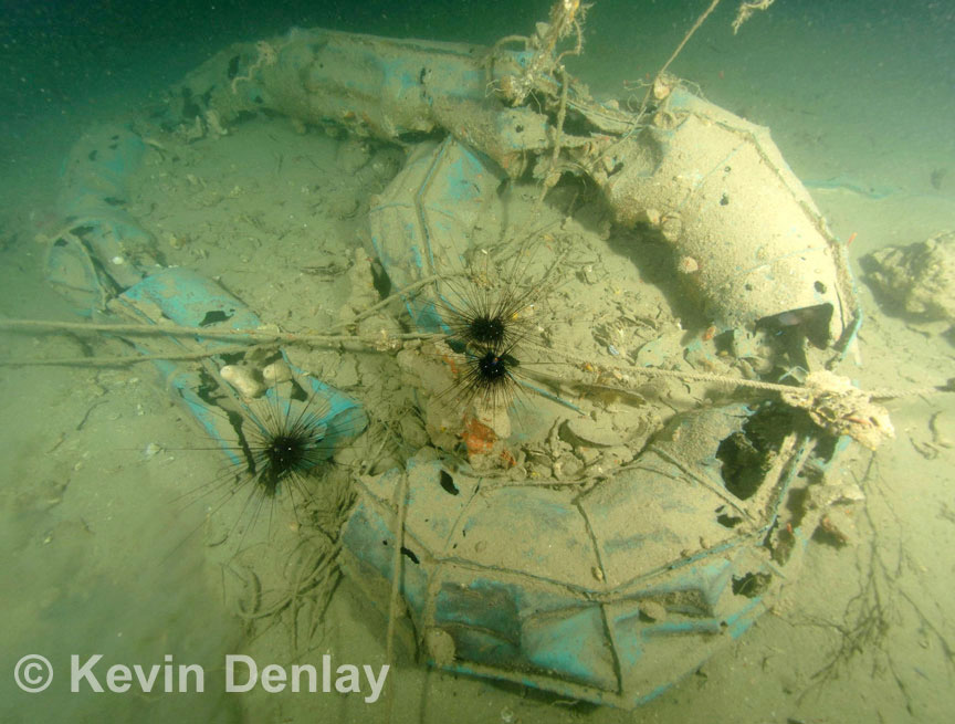

For the Prince of Wales at the time of her demise, would I be correct in assuming that from waterline up the ship is basicly 507c light gray (not the wood decks), MS1 dark gray for the steel decks, with B5 blue, B6 blue and MS1 dark gray added for camouflage ?? I understand that the PoW also had MS3, but that this was painted over in the summer of 1941.
What colour are inflatable lifeboats ??

Although showing some signs of age so to speak, a photo of the 'real thing' underneath the wreck of HMS Prince of Wales.

If that lifeboat has been on the bottom of the ocean for more than 60 years, it's looking remarkably clean.
But the photo shows it to be blue.

JCRAY
- Posts: 633
- Joined: Sun Feb 08, 2009 3:18 pm
- Location: Palm Beach, Fla
Re: Calling all HMS King George V class (WWII) fans
I suspect the pretty blue is the color of the plastic not paint. There is a great photo of a freshly painted Penelope in Nov. 1942, pg. 44, Warship Perspectives Vol 4. Note how the camo. cuts accross the float beside B turret, and the other floats are painted the color they are placed upon. Also see the note below it that refer to the official camo designs. jc

Apart from the spectacular photo by itself, those are some awesome-looking sea urchins down there. I certainly wouldn't like to share my Carley float with a few of those blighters!

Gents,
It is my understanding that the interior of the Carley float was 'solid' so to speak, so what you are seeing here is the 'blueing' of the hollow metal core from its prolonged immersion in salt water.
Now, while not a great believer in everything that Wikipedia says, the following does seem to describe the floats construction accurately. Later they may have been made of canvas, or something similar, but the ones on PoW are metal core. The crushing under pressure (from the water pressure at depth) of the hollow metal core can be seen in the image I posted lower right on float.
From Wiki
"The Carley float was formed from a length of copper or steel tubing 12-20inches (30-50cm) in diameter bent into an oval ring. The ring was surrounded by a buoyant mass of kapok or cork, and then covered with a layer of canvas rendered waterproof via painting or doping. The metal tube was divided into waterproof compartments with vertical baffles. The raft was thus rigid, and could remain buoyant, floating equally well with either side uppermost, even if the waterproof outer was punctured. The floor of the raft was made from a wood or webbing grating. Boxes containing paddles, water, rations and survival equipment were lashed to the floor grating. Men could either sit around the rim of the raft, or, if in the water, cling to rope loops strung around its edge."
