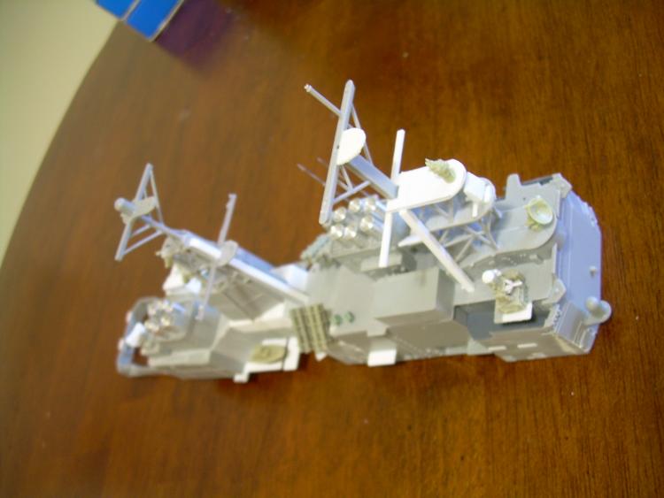

DDG-963 is starting to come together.
Here is the work so far on the super structure and masts. I still have some things to fabricate, but those should not be too hard. Still to fabricate are the NULKA launchers, the SYS-2 mid-course correction antennas, enlarge the top platform on the aft mast for the SPS-48, a lot of deck details, and the duck-tail/hydrodynamic wedge.
Thanks to CAPT Potter for answering a couple questions. From what I have been reading in Norman Friedman's US Destroyers and Amphibious Ships and Craft, it looks like because so many ships of the Spruance pattern DX (what turned into the ASW version) were going to be procured, when funds came available, expected to be 10 years into their lives, the ASWs would be converted to DXG (what turned into the Kidds), because the threat was suspected to change significantly in the coming years. This was all capable, because the ships were so modular in their weapon systems.
This leads me to believe that the ASW Spruances could have been turned into the base-line DXGs at the very least if their hulls were too weak to accept the NTU equipped Kidd capabilities. They could be converted from the ASW package to the AAW package during their lives.
US Amphibious Ships and Craft quotes that the prototype Mk71 equipping Hull only had 336 rounds of 8" and the Spruances could accommodate a 400 round magazine. There was desire for the support-ship version of Spruance to equip two Mk71s with 1000 round magazines. It looks like 400 rounds is what the Paul Foster could take right now as she sits.
On the Mk71 note, in Amphibious Ships and Craft, Friedman states that the inaccuracies in the gun were mainly caused by the USS Hull�s hull flexing too much due to the ship�s light-weight construction, and the Mk68 GFCS did not incorporate all of the 8� gun�s parameters. I can�t put my finger on it now, but I read complementary information that it was expected that the more rigid hull of the Spruance would hold the weapon steady, and the Mk86 GFCS would accommodate the parameters of the weapon.
It sounds like the dispersion observed in the 8� rounds fired by the Mk71 was due to several factors. 1. The weapon was a prototype so it had kinks such as internal strengtheners and bracing that held the barrel in place needed to be stronger. 2. The barrel needed to be a little more fortified to reduce whipping. 3. Even though the deck and frame work was braced against the shock the gun would produce, the ship itself bent and flexed too much. 4. The ship�s GunFire Control System was did not have the programming necessary to accurately aim the weapon with its unique ballistic performance.
It sounds like today the weapon would be pretty reliable, especially with guided munitions.
Anyway, here are some pictures of the ship!

Michael Potter
Posts: 484
Joined: Wed Jan 19, 2005 11:19 pm
Location: San Diego
Re: Reactivated and Modernized Spruance-class
Post by Michael Potter »
Nice work. Your correct alignment of parts is not easy in a scratch-build model.
Thinking more about this subject, you could suggest a situation where your ship could be acceptable as a modern combatant, despite being overloaded if it were a new ship. As an escort of MSC ships and other mercantile ships, it would be tactically acceptable if this DDG were little more survivable than the ships escorted. Since MSC ships will support the first wave of an amphibious assault, this doctrine would not take the DDG out of the action.
Since it is not a new ship, you could leave zero margin for future upgrades, on the ground that any newer equipment must have a very high priority to warrant installation at all, so that it would be acceptable to take off some of the installed equipment to allow it. This policy would free margins in hull strength, stability, and utilities to use now.
Since you could expect the converted ship to be retired in say ten years, you could posit that this ship would not be critical for some potential threats that might develop in that time. In particular, you might assume that during the next ten years a potential North Korean attack against South Korea or Japan would be detectable (indicated) in enough time to bring in other ships suited for cold weather, or that an attack on short notice would be necessarily small enough to handle with relatively nearby assets. Then you could reserve this converted DDG to operate only in warmer and normally calmer waters. That would reduce the potential demand for electrical power to de-ice the ship, and could allow for damaged stability in lesser wind velocities.
You could even accept damage on the basis that an elderly ship would not be worth repairing. Instead the policy could be to strike the ship immediately in the event of severe damage. Then you would need less margin to allow for damaged stability, such as from high wind after a torpedo or mine strike. DC equipment could be reduced to that to protect life during abandonment, with little need for shoring, emergency power cables, towing gear, etc. That has long been the policy for MSC ships and is one reason why their crew complement is smaller in numbers (and older in average age) than when the same ship was USN.
Some of these policies, including zero margins and acceptance of vulnerability similar to a merchantman, were the RN's actual practice in converting war-built destroyers to frigates in the 1950s.
