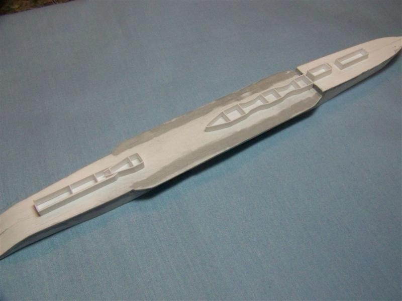

I'm going to try and finish a scratchbuilt IJN Kitakami 1945 Kaiten carrier for this build. I obtained several really good plans for the ship from a member of the site(Thank you!) and resized them to 1:700. Here are a few photos of the progress. I'm a bit further along than these show and will post more in a few days.

Great start AJ. :thumbs_up_1: :thumbs_up_1: Your pics are a great help for myself when I want to do a scratchbuild. :big_grin: I like what you did constructing the hull.
Bob Pink.
