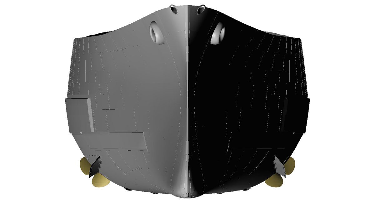

Here are some pictures showing the tumblehome. I have always been fond of ships with tumblehome - from the wooden sailing ship days. I think it gives a ship a "gothic" look, or something like that.
The bow and stern views show the way the armor belt was tilted out. A new knuckle was formed in the hull plating above the armor, and the plating sloped inward (tumblehome) up to the main deck. On the Brooklyns and Baltimores the hull sides were more or less vertical from the bottom of the armor belt to the main deck. The original Clevelands were too unstable after all the added antiaircraft armament was added. Broadening the beam at the waterline (just below the top of the armor belt) improved stability.
You can also see the radical inward slope of the hull at the stern in the stern view image. The starboard quarter image shows this even more. The hull formed a smooth curve at the main deck level, but the transom was squared off at the water line - this also increased stability and added buoyancy to support the weight of the aircraft catapults and crane.
The transition from sharp knuckle at the bottom of the transom to the smooth curve along the hull side was the hardest part to model (and probably the most inaccurate part). The blueprints show four contradicting versions, from a sharp point at the the outboard end of the transom to a broad curving transition. The hull plate edge sightlines in the Table of Offsets gave the curvature at the top of the strake at the outboard end of the stern knuckle. Fortunately I have photos of the stern while the ship was in drydock to help me interpret the drawings.
The knuckle below the armor belt gradually gives way aft to the smooth curve from the vertical sides to the bottom plating. Then the knuckle starts again at the bottom of the transom. The Baltimore hull was much easier to model because the knuckle continues unbroken all the way aft and under the stern.
