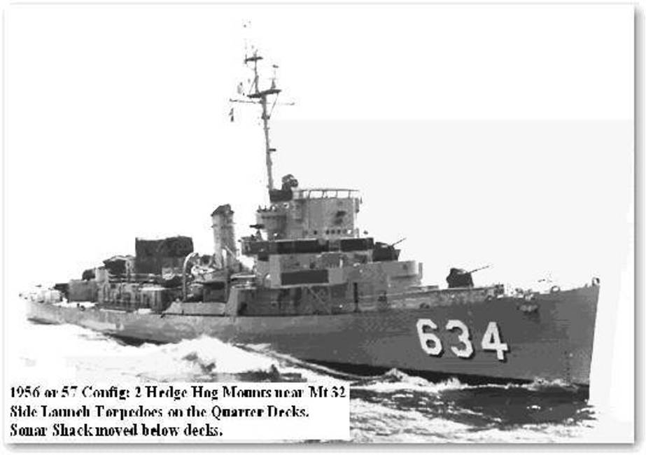

This is a picture of the USS Whitehurst after it was re-Commissioned for the '61-'62 Reserve call-up. It comes from the crew website, http://WWW.de634.org
With reference to ASW, the ship retained its DC racks and K Launchers. The Mk 11 hedgehog was removed from the main deck behind the 31 Mount but two were added to either side of the 32 Mount on the 01 Deck.
It is also noted in the site that if one Hedgehog bomb struck a sub and detonated, it would cause sympathetic detonation of the other bombs in the pattern.
So, how about getting rid of the 32 Mount and placing a Mk 15 launcher in that spot?
"The Hedgehogs were loaded onto spigots in a 4 x 6 pattern pointing forward at slightly different angles. Each spigot had a firing pin which touched the cap of a small charge. The hollow mounting tube and the charge constituted a rocket assembly which fired the bomb portion of the weapon into the air. Twenty-four Hedgehogs were electrically fired in rapid succession so that they sank toward the target in a 3 dimensional pattern. At his station behind the shield, the operator, turning the hand crank, matched pointers on a dial which responded to signals from the Sonar Control Room on the face of the bridge superstructure. This action tilted the bed of the launcher so that the Hedgehogs could be fired within an arc that extended several degrees left and right of "dead ahead". Whitehurst was built with one launcher mounted on the main deck directly aft of Mount 31. In 1956, this launcher was removed and two launchers were installed on the 01 level on either side and slightly aft of Mount 32."
