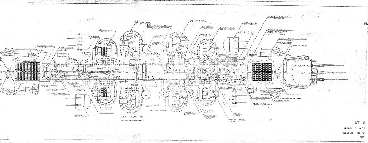

PostPosted: Fri Dec 10, 2010 11:14 am
Posts: 3127
Just in case someone forgot, this is what sex on steel looks like:
A concern with the VLS forward is that you have to worry about the tubes being a certain distance away from the bridge windows and a certain distance away from the back of the gun turret to provide enough internal volume to walk between the cells and the outermost bulkhead. There is enough room maintaining distance between the back of Turret 3 and the super structure. With this the forward VLS arrangement accommodates 48-cells, whereas there is the possibility that the aft can accommodate a full 64-cells. This enables the ship to take an entire 112 TLAMs into theater with 16-cells, or 32 ESSMs for self defense.
There will be additional structure added to the 01 Level aft structure at the base of the VLS similar to that forward. The extra internal volume would be used for UAV storage and workshop on the starboard side and a fantastic gym on the port side.
