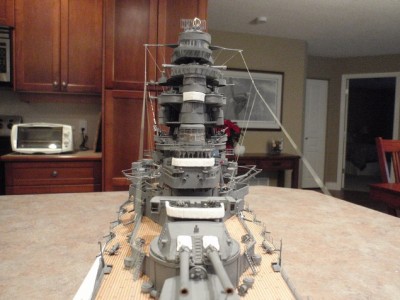

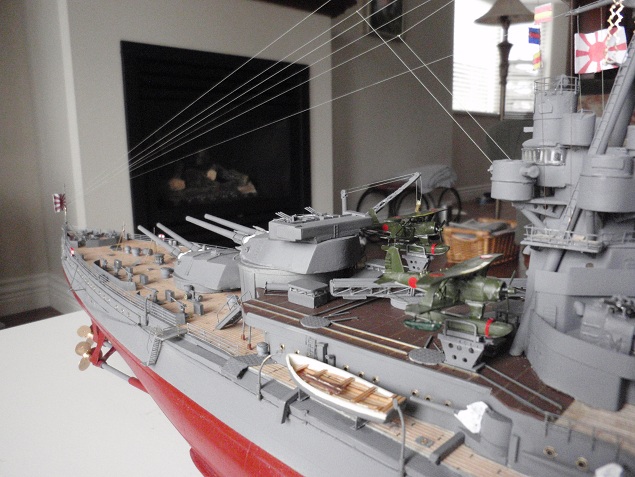

a little follow up on the rigging,the nylon paints very well,i just take a brush with a fair amount of paint on it and run it down the line.because the line is fairly strong there is no fear of braking it.,also a couple of pics of the signal deck.

Hi Russ Did you paint the line white? I've never used nylon line I tend to stick with metal thread under the trade name Krenik but the line you have used seems exceptionally fine, finer in fact than the metal thread. The Nagato is looking simply superb .Will you be mounting the model in a glass case? I have ordered the case for Kiev but I�ve yet to make the base.

hi dave ,yes i did paint the signal flag lines white,i think thay are rope and the other lines are more than likely steel cable , or wire rope.i will have to do some research on this because in them days it was more than likely manila rope which was probably a tan color,not white.the line i used is so fine it is hard to see it before it is painted,i realy had to squint my eyes to get the brush bristles over it

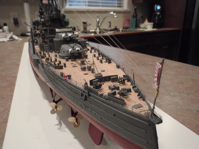

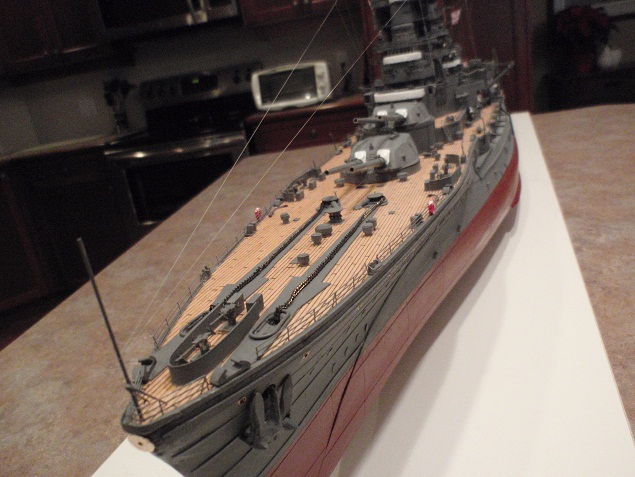

some pics of nagato finished.more in pic post and completed models.

Hi Russ scratch building at its best . This is a stunning model and at 1:200 scale . I trust that you are going to put such a beautifully crafted model as your Nagato in a display case ? The big question is what next?
