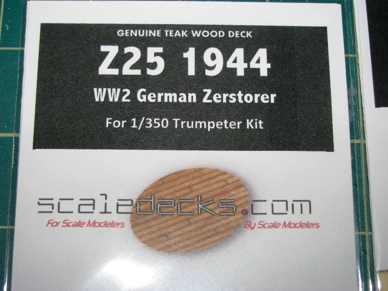

The decks arrive in a plastic wrapped sleeve with a thin heavy paper insert. The deck is on one side, the instructions on the other.
File comment: Teak, Maple, Photographic Paper in their packaging
The next few photos show each type of deck - a photo of the name and then a photo of the deck itself.
