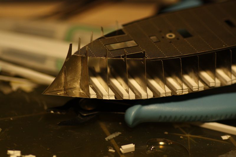

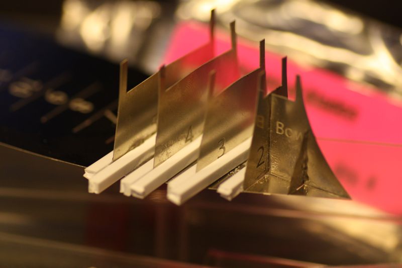

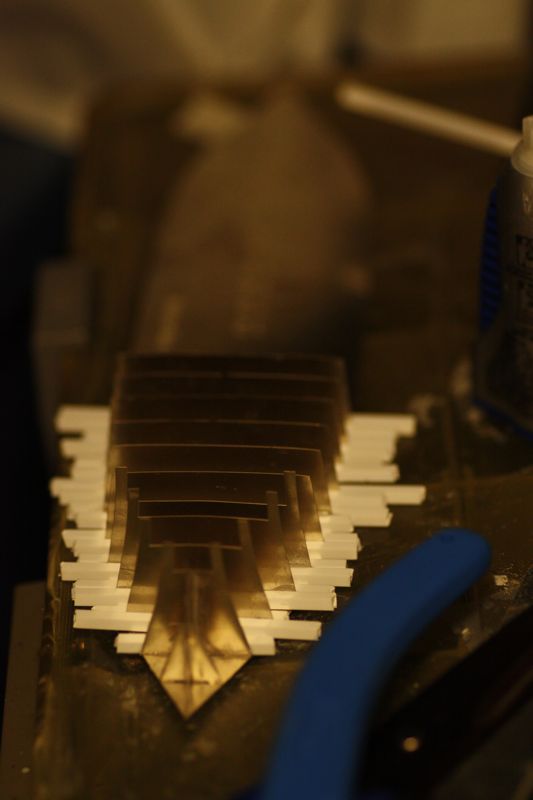

So instead I decided to lay styrene rod on either side of the section plates as I glued them to the base, to hopefully reinforce them and create a sturdy, stable structure.
The result was both strong and strangely flexible. I could take the completed base+sections and actually bend it slightly, or even undulate it in my hands if I wanted to...So far everything was looking good.

Relief-Etched Deck plate dry fitted to check alignment and compatibility.

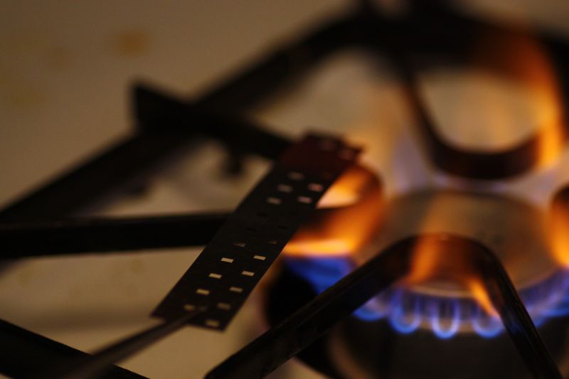

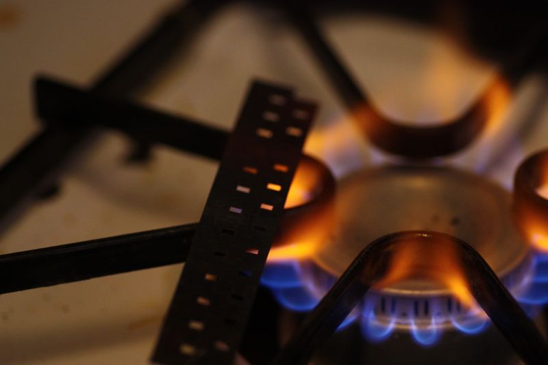

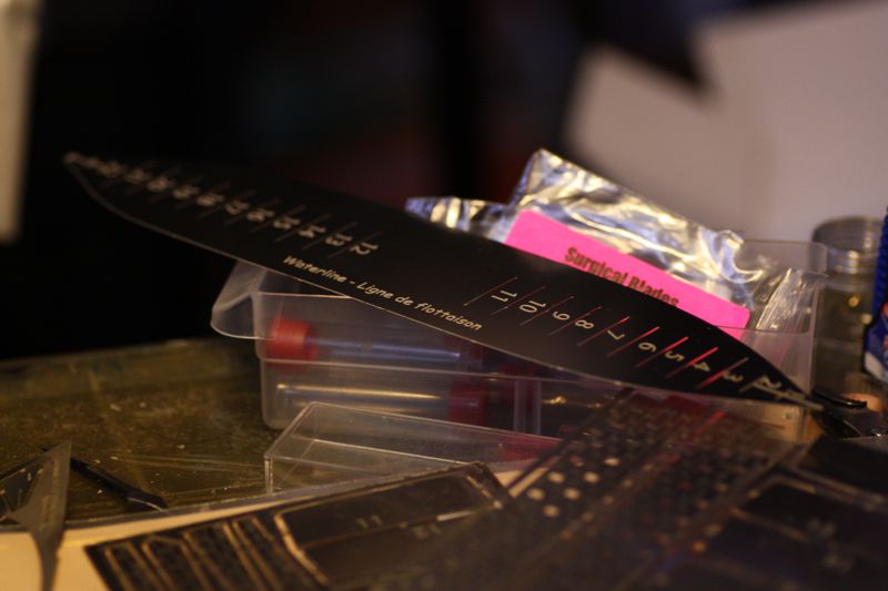

I told Bruno the deck and armor plates were very 'steely' and hard to work with. He explained to me that they would have to be 'annealed.' :heh: heated up until they were red-hot and then allowed to cool. He said once they were cool they would be as soft and easy to work as brass... He was right, as usual. :thumbs_up_1:
This was a new experience for me, and my daughters were very curious to know why I was 'cooking' model parts over the stove. I tried my best to explain it to them, but I think they just filed the whole experience under 'crazy things Dad does for his models...' :big_grin:
After these shots were made, I realized if I took the grating off, I could put the parts right in the flame and get them hotter quicker.
Complete set of armor parts+deck plate ready to work into the hull structure. Notice how the deck has been distorted by annealing. Because of its large thin shape it was more difficult to anneal than the others. It tended to get very hot very quickly in one spot, causing the distortion you see here. Hopefully I will be able to make it work.
Annealing also burned the color of the parts from silvery steel to a dark 'burned metal' sort of color that was very similar to the color of Armor... after a little bit of thought, I realized it was precisely the same color as armor, and for the same reason. :cool_2:
Why fit the armor plates now? Why not wait until after the hull has been filled in to make a solid block? Well... I didn't want to have to drill and shape each gun port in the hull after filling it in. Not only would that be difficult and tedious, but since the port was already there in steel, it would mean that my knife would be periodically scraping that steel, which would be bad for the blade, bad for the steel, or both. What I decided was that I would need to create a kind of 'cofferdam' or 'square hole' for each of the gun-ports from styrene, essentially a 5-sided box that fit the exact shape of each port prior to filling out the hull. That prospect did not excite me much either, but it seemed better than the alternative.
Sometimes the alternative to 'tedious and difficult' is itself tedious and difficult, but I think I have actually come up with a solution. This is the state of the build as of now. I'll post back when I've tried out my idea for making the gunport casting boxes. Wish me luck, and happy modeling! :wave_1:
