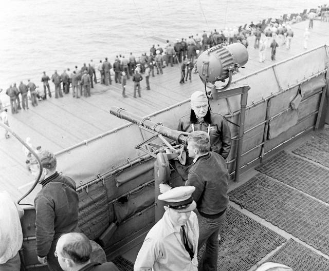

Joreon, if you are doing a Midway version, the second set of photos do not apply. CV-6 had additional 20mm added around her sterrn ramp after Midway. For Midway, you have correctly noted a single 50 cal at each corner of the flight deck catwalks. The 20MM at Midway are as follows, 5x20mm port forward catwalk just aft of the 5 inch battery. 5x20mm aft port catwalk in front of aft 5 inch battery, 5x20mm stbd side forward catwalk between the 5 inch battery and the fwd 1.1 inch mounts. 3x20mm in the catwalk aft of the island and two more single 20mm tubs in the catwalk bracketing the top of the stbd side hangar deck boat crane. Additionally, there were 2x20mm in the bow tub on the foc'sle and there were two single 20mm's on the fantail at hangar deck level. There were 8 x 20mm's along the starboard side of the island on the former boat deck. Total at Midway was 32 plus at least the 4x50cals.on the corners. Might have been a few more ad hoc 50's mounted in odd locations, but they were strictly lashups. The corner units were "official" ones and had plumbing for the cooling jackets. None of the 50's had shields. The forward units lasted a lot longer, showing up in photos into 1943. I think structural /weight/size concerns at the forward catwalk corners may have been an issue. Some say these were upgraded to 20mm as well, but I have yet to find a photo that confirmed that. The fwd positions remained as you see them in these shots and these are too small for a 20mm. The photo that has you guessing, with the 20mm at the stern ramp, was taken several months after Midway, on the return from Eastern Solomons. CV-6 had armament upgrades at almost every visit to Pearl Harbor (except, curiously, the three day quickie before she sailed for Midway, when CV-5 had the yard's full attention). It is critical to understand the proper dates and timeframes of the photos you are looking at.
Mike

The "fantail" is the very back of the hull at the hangar deck level. A photo that clearly shows one of these 20MM is the top post on page 12 of this same thread. A couple of posts down is an identification of what might be the other fantail 20MM. Our speculation is that both Yorktown and Enterprise received 20MM in this location as a temporary measure. The final location for these two guns was probably the cutouts in the after flightdeck rounddown, but Yorktown was lost before that could happen. Enterprise did not get the mod until after Midway.

Dick, thank you so much for the help. Studying the pictures on page 12, at first I could not really see the weapons. Then I started looking at the Yorktown just a few hours ago on the photo-cd an found this...
Can't get any clearer than this. Again many thanks :thumbs_up_1:

I had originally thought they might have used the Mk10 tripod mount based on that fuzzy shot Dick refers to, but they were in fact Mk 4 pedestals. My thanks to CDR Pete Clayton, USN (Ret) for this photo. This should firmly clear things up:
Mike
