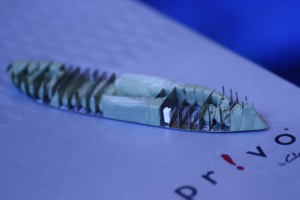

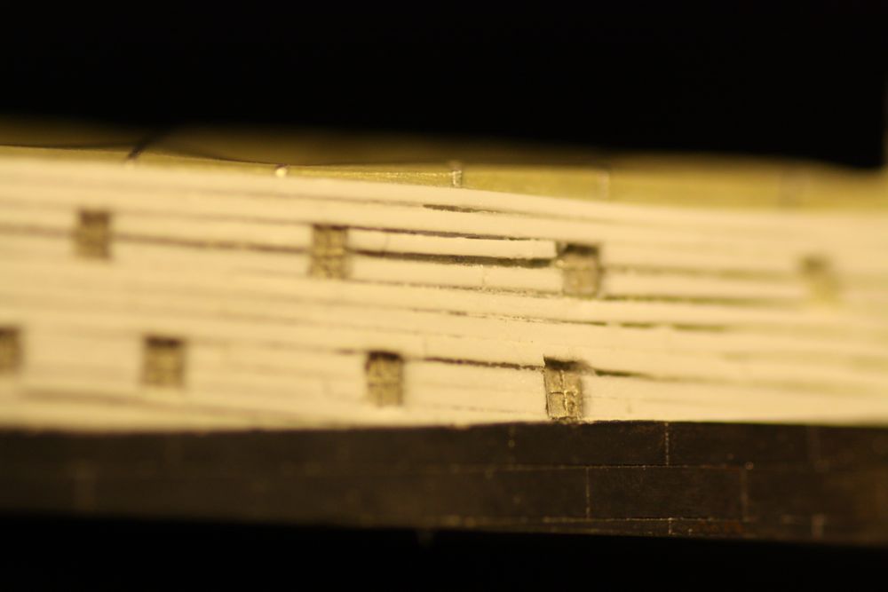

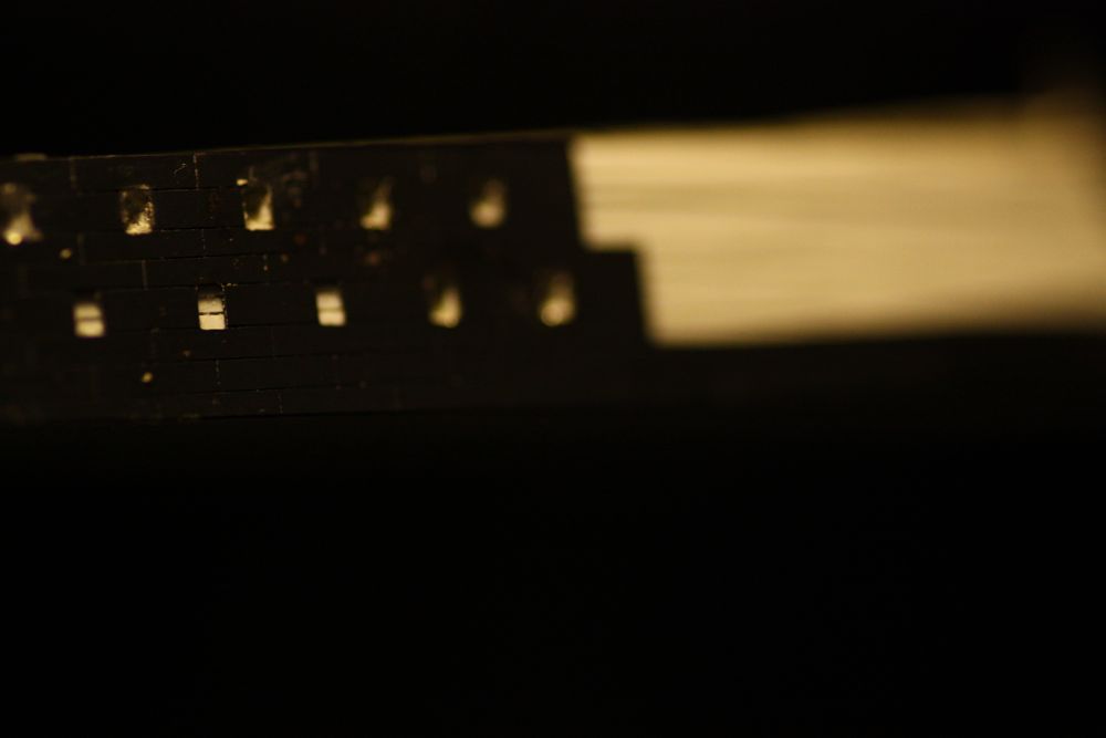

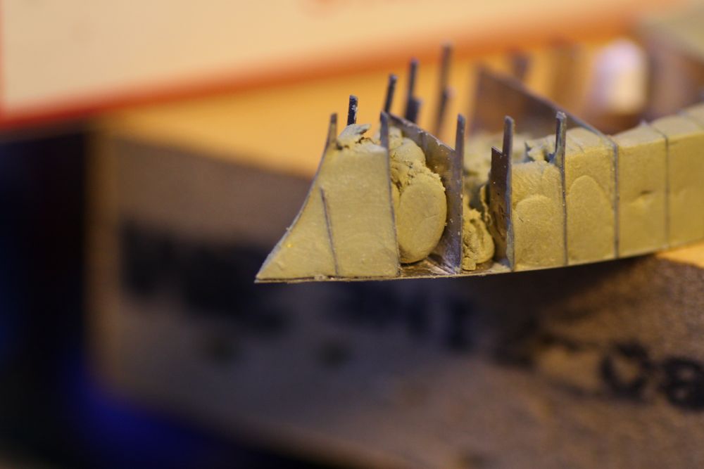

At the request of the La Rochelle Office, I chose to start on the 700th scale version, as Bruno is thinking about whipping one up for Telford... He gave me until the end of September! :heh: Actually I think I might just be able to pull it off. Here is the progress so far. Starts out looking almost exactly like the 350th scale version, except it's 1/4 the size.

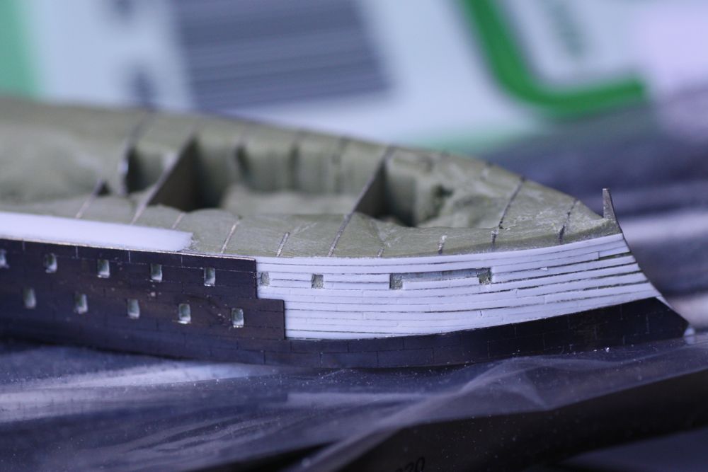

Due to the arrangement of the hatches in the weather deck, it was necessary to cut away some of the interior of the frame plates. This is something I neglected to do with the larger model, and (I fear) may give me trouble later. I used sheet metal sheers to do this, and it worked well, although they were so large it was hard to control the cutting, and in one instance I cut completely through the outer edge of the frame. You can see this one is bent out of shape from the treatment. All of them required re-flattening, but this wasn't any big deal.
Bow section...
note penny for scale. Compare that to the 350th version above... Big difference!
Putty!
I hate putty, actually. However, for a number of reasons, I felt this would be the best medium for filling out the hull. It proved troublesome, as you will see. You'll notice that the bow frames broke off as I began attaching putty to the frames. They were glued back in place later, but the hard steely medium of the frames, glued insecurely with super-glue to the waterline plate interacted with the soft and somewhat springy putty in unpredictable ways.

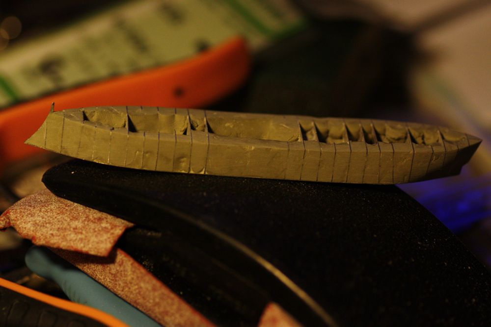

I found it more or less impossible to sculpt the precise shape of the hull sides from wet putty, so decided to 'oversculpt' the contours and then sand and file them down once the milliput had hardened.
Here you can see the results of my sanding/carving efforts on the port amidships, so far so good. There is a bit of gouging at the top edge, but nothing that can't be fixed with more putty. However, later on I was to run into more serious difficulties with the putty. :heh:

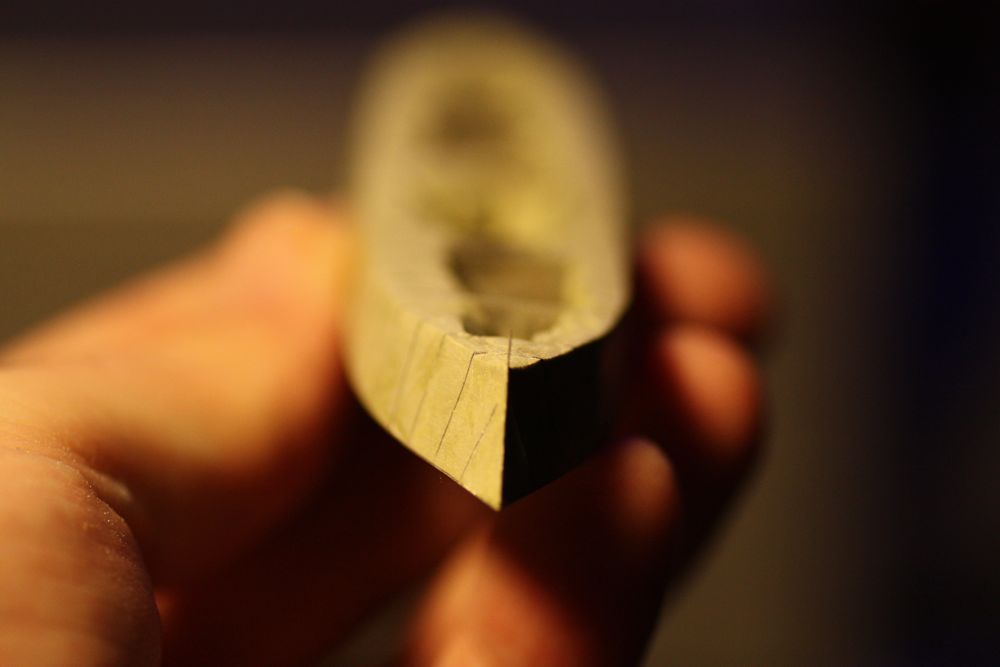

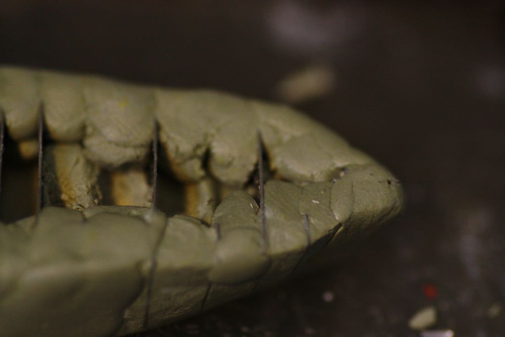

Continuing to fill out the hull... Spacer blobs were needed to re-enforce the section plates for the putty that would form the sides of the hull.

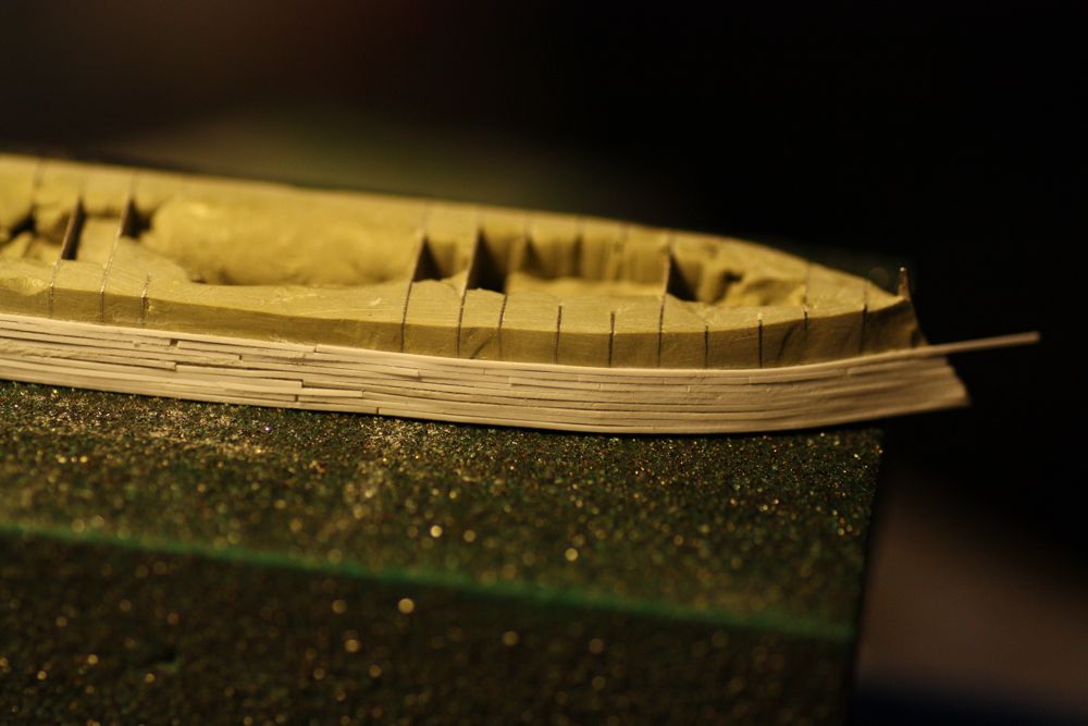

Here is the bow after filling, sanding and shaping... I felt like it was looking pretty good at this point. I did my best to carve 'into' the curves a little bit so that they had a nice gentle concavity to them.
What Is That???? :eyes_spinning: :huh: Even my daughters, who are way more warship-savvy than they ought to be, couldn't figure out what their dad was doing with the metal plates and the putty. I think it looks like a rotten meat canoe, personally. :crazy: :dead:
This was the completion of the putty for the hull contours. Once again I 'oversculpted' so I could hopefully carve and sand the shape flush once the putty had hardened.
I hate working with putty. :heh:

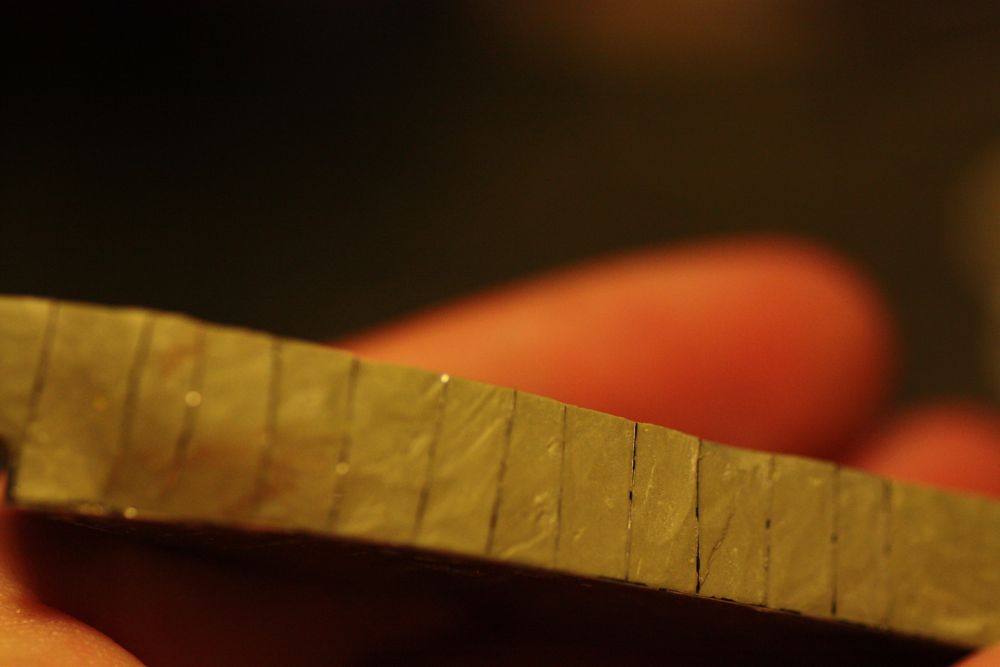

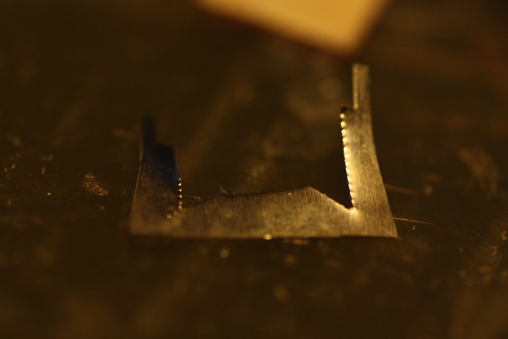

Now to carve away all that putty, and hopefully get a beautiful and shapely shape... :cool_2:
Ouch!!! :heh: "Dull blades are more dangerous than sharp ones..." and btw putty will turn the former into the latter quicker than anything I know. :censored_2:
shaping the stern... the reddish hue is a personal DNA sample I spontaneously chose to donate to the project. :Mad_6:

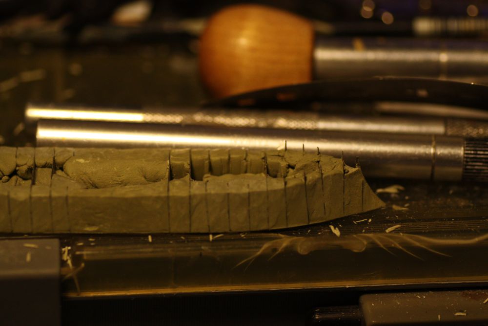

Ahhh... now we come to the crux of it. Do you see what has happened to the frame sections? They have been distorted by the pressure of the putty between them, and now, as a result are not only inaccurate, but asymmetrical... very bad form. :mad_2: :Mad_5: :Oops_1:
You can see that the end of the stern does not fit evenly beneath the deck plate. Also it seems too wide. I ought to be able to fix this by sanding/filing down the stern, but it will be an 'eyeball' situation, rather than working from the section plates. I'm beginning to think that, no matter how accurate or perfect the components you are working with, there is always a degree of 'eyeballing' that goes into any model.

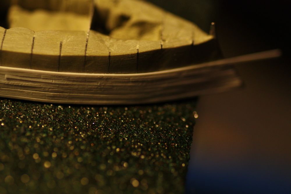

Although the putty proposition did not go as well as I had hoped, I anticipated that I might have difficulties with it. (did I mention I hate putty?) As many of you know, there is a 2% shrinkage that occurs between the dimensions of a casting master and a resin copy of the master. (the cast will be roughly 2% smaller) Since Bruno did not mention enlarging the dimensions of his PE by 2% I suspect he created the parts at exactly 700th scale. I am going to use that 2% leeway to my advantage by laying styrene planks onto the exterior of the hull and then laying the armor plate on top of that. This will give the armor the appearance of being laid on top of the planking (as indeed it was) as well as giving the ship a nice planked texture in the unarmored areas, similar to my carrack models. In addition it will regularize and hide the defects in my putty carving etc. One thing I've learned in modeling is, if you're trying something new, try to take steps to hide your screw-ups if you are able to. :thumbs_up_1: The next time I am able to assemble one of Bruno's magnificent PE skeletons, I will probably use a different method. :big_grin: C'est la Vie!
Well that brings us up to date, although I will be working on Solferino 700th this week and week-end, so I will have more pics soon. Hope everyone is enjoying their projects. Happy Modeling! :wave_1:

Hi Neal!
My friend, I'm afraid you didn't fully catch my method...
I used construction board for the filling because this is SOFTER than the nickel alloy frames and it has NO shrinking effect.
Evergreen (styrene) filling also works fine but with a tendency to melt when sanded, requiring WET sanding.
Balsa wood also works.
I described this in detail in my Minneapolis/ Tulagi thread.
With construction board or Evergreen:
1- As it doesn't shrink the final block/ hull is fully accurate to the tenth of mm
2- As it is softer than the frames you have just to sand it, waiting for the "rattle" sound which tells you're arrived... without measuring.
With Milliput (I hate this product and bought it only once... in 1992) you can't do this correctly:
1- This epoxy compound shrinks down during curing, ruining the dimensional accuracy. It's a chance your hull didn't go the banana way!
2- Epoxy is harder than construction board or styrene and too close to the metal frames: when sanding the hull you won't hear that rattle sound and have to check, check and check again for not to sand too much and ruin each frame profile. This will be far more difficult. I hate checking and checking again when I can do better without... checking.
It's too late for your 1:700 scale hull, but please DON'T use Milliput or any epoxy compound filling in your 1:350 scale: I can guaranty you'll ruin it.
I can etch you a 1:700 replacement hull framing if you need one... Just ask!

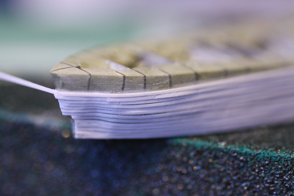

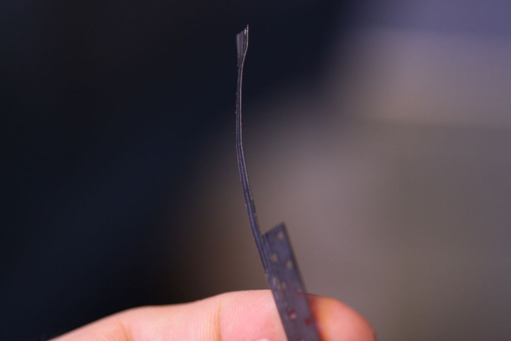

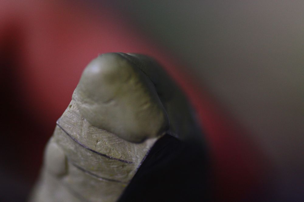

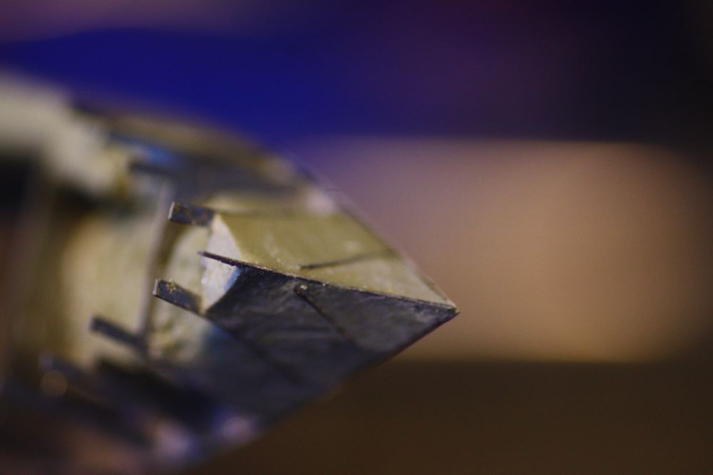

So I got this wild hair idea to put the knife down and start sanding the model... What do you think? And you know what? It was amazing! The sanding started to even out the imperfections of the carving knife! ... :big_grin:
Oops! Snap! the epoxy separated from the steel... But a little bit of CA in the joint and we were back in business.
I felt silly for not having tried this before... :heh:
Aft sheer looks pretty good... but amidships it's a bit dodgy. However the armor plate would help me to establish amidships deck line.
Pessimists see the world as it truly is...
Optimists change the world.

By this point I felt like maybe I had pulled the model out of the fire. Between sanding and adding a layer of detail, I thought I might have a chance at a workable casting master after all... So I decided to proceed with the plan.
Laying the First Plank Line! :thumbs_up_1:
More planks...
The planks were laid a bit rough amidships, but I didn't worry too much about it since I knew the armor would completely cover this area.
Shaping the armor plate. Now that it had been annealed it was as soft as brass, but shaping the flat piece to fit the 3-d curves of the hull was still tricky...
The starboard armor plate installed. Unlike the 350th version, this was all in one piece.

I began by gluing the amidships to the styrene planks. Lots of glue to ensure a good hold. I then did some final shaping to the ends. Very tricky to get the armor both bent to shape and lined up so that both ends met the perpendiculars without going short or overlapping. I was very pleased with Bruno's engineering once I was able to get it all installed. And that armor plate has the individual plates etch-relief exactly according to the original archive plans. If all goes well we will have an exquisitely detailed hull thanks to my French friend. :woo_hoo:
I hollowed out the gun ports beneath the armor by pulling up the plank styrene there, making them slightly deeper than they would otherwise have been.
