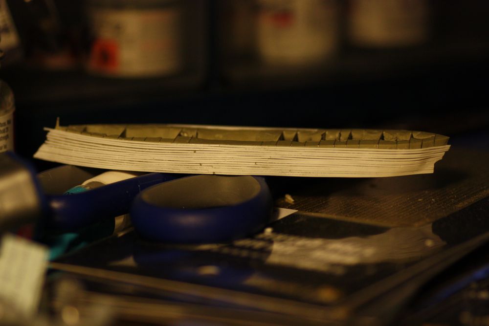

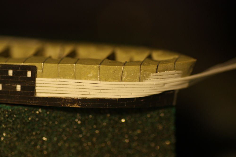

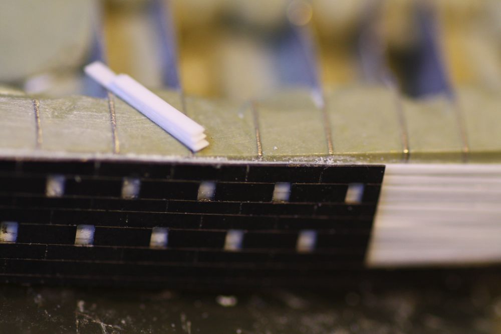

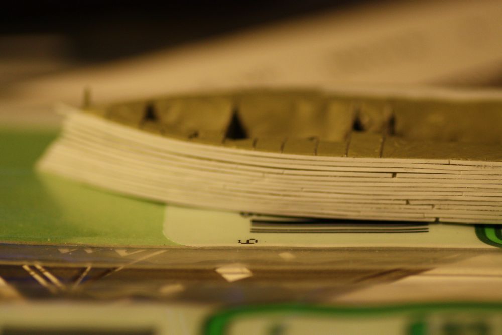

Planking up the port side. Very challenging to get the planking patterns to match Port and Starboard. The tumble-home of the bow, and the undercut of the stern caused problems in the laying of the plank rows, which I was able to counteract on the bow by carefully spacing the upper rows of planks slightly to keep them level with the horizontal plain of the ship. The stern however was another matter...

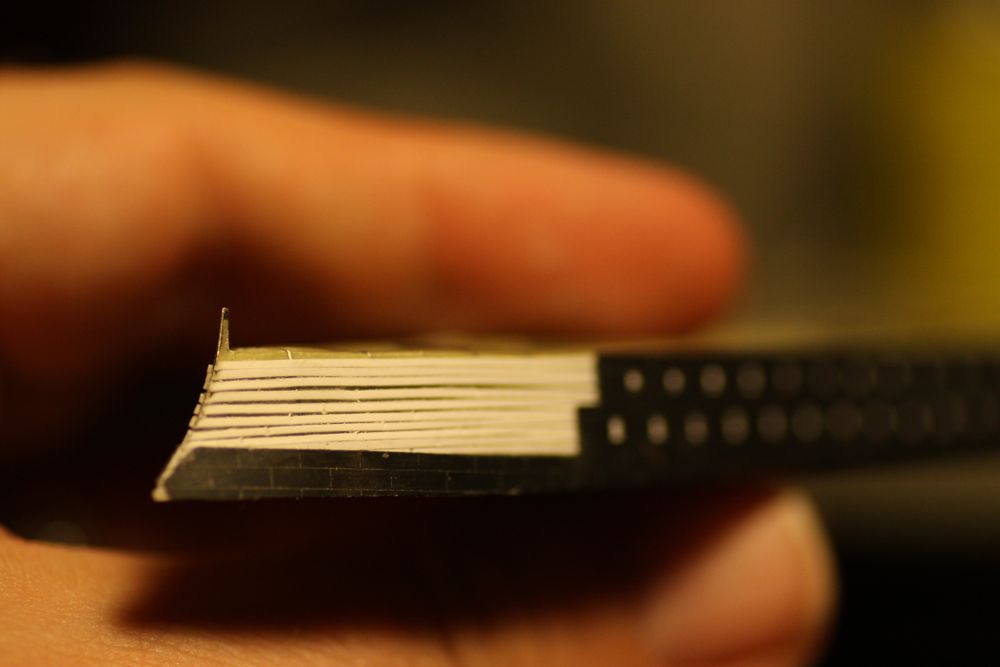

Port side planking complete. A little rough amidships but no matter, as the PE armor plate covers this entire area.

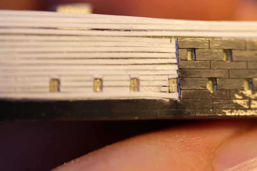

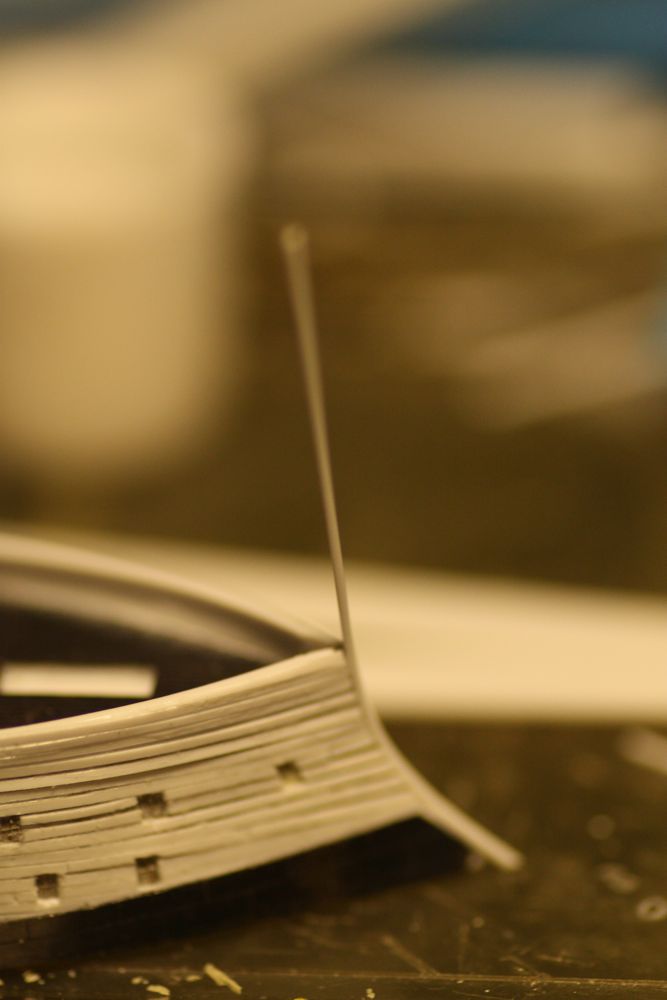

Here you can see the problem with the stern. The undercut shape caused the plank strakes to curve downward from horizontal as they followed the shape of the hull, ultimately causing a 'hogged' appearance to the hull. For several days I rationalized this, as eventually there will be quite a few window ports, an admiral's walk, and numerous boats suspended from davits immediately above this area, which, in the final analysis would probably hide the defect... but it still bothered me. The real clincher was in considering the shape of the stern, which I had gouged out a little bit too much between the last two frame plates in trying to blend the fineness of the waterline plate shape with the fuller plan of the deck piece. In looking at the stern I realized the shape was slightly 'pinched' and as a result the PE stern walk would probably not fit properly. In considering this problem, I realized I could kill two birds with one stone by stripping off the stern planks, but leaving them in place in the depression, and then sanding them to blend the depression with the hull. I could then re-apply a new set of planks, being careful to keep them level this time... That was the plan, anyway. :big_grin:

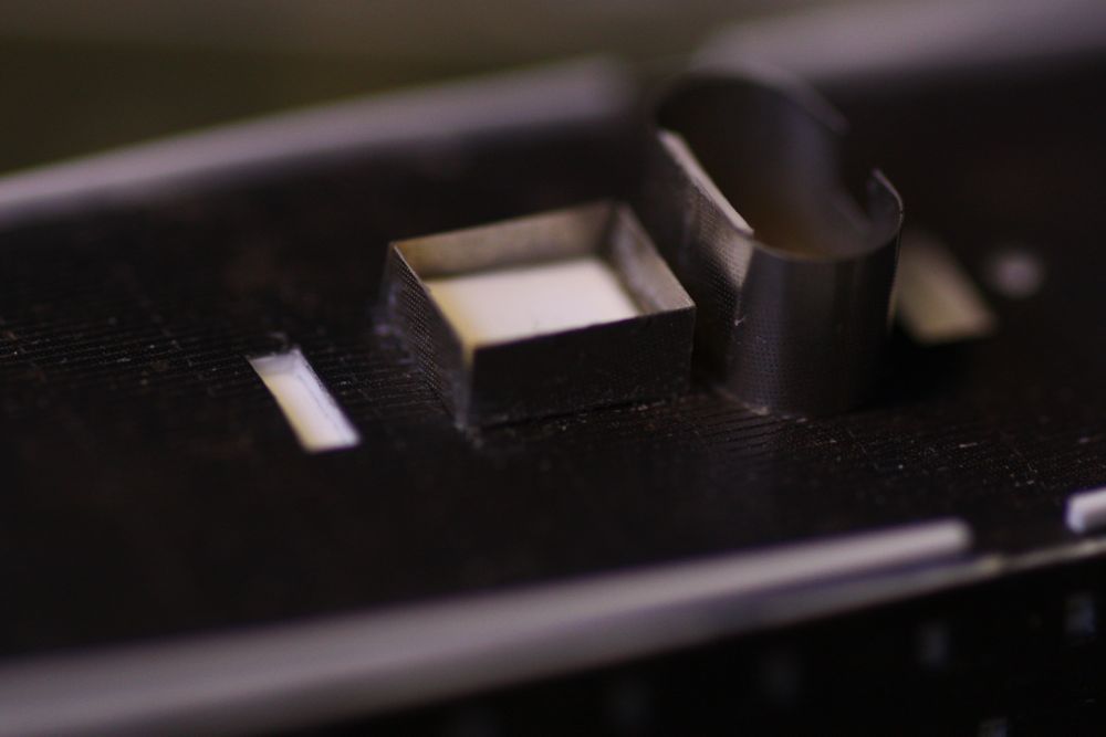

Building a box around the stairs underneath the plate. The Box is not accurate strictly speaking, since the stairs go down to 'nowhere,' but it is a necessary convention so that the resin mold material will fill the companionway and show the steps, but not seep into the interior of the master and cause problems.

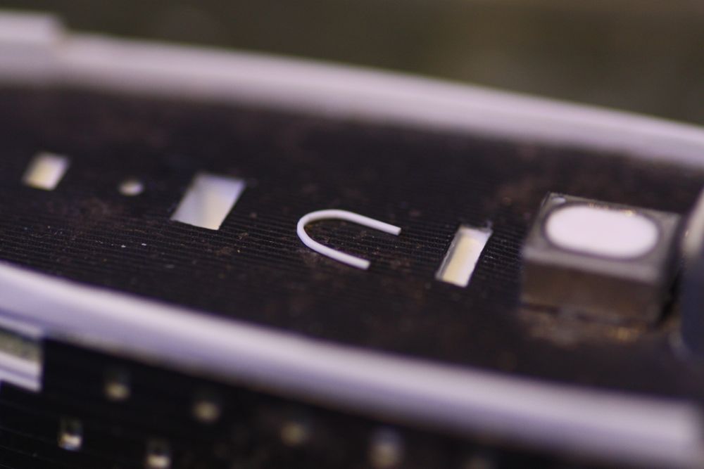

Centerline openings in the deck plate finally finished. Grating-covered hatches fitted with shallow boxes, companion way openings completed to the depth of one deck.

With this build I am gluing styrene to steel and putty, which necessitates the use of CA, which, as I'm sure you know sets quicker and more suddenly than plastic cement. On reflection I realized this is caused by the shape of the stern and the bow, which have more surface area because of their shape, so a row of planks that covers all the area from waterline to gunwale on the vertical plane, will be insufficient when the hull develops a significant incline towards the horizontal, which is the case with both a tumble-home bow and a cut-away stern.
The question then is, what to do? With both the bow and the stern I was forced to allow gaps to develop as the plank strakes progressed towards the extremities in order to keep the plank strakes horizontal. It's more obvious with the Bow than with the Stern, partly because I redid the Stern and partly because the shape of the Bow makes this issue more apparent. My only other options would be to insert 'spacer' wedges between the plank strakes which I felt were problematic from a detail standpoint, or to create planks that had a very slight gradual increase in width, which would have been difficult to do uniformly and consistently. So, I have decided (for the time being) to live with the gaps. They are actually more apparent to the camera than to the eye. Keep in mind the hull is only about a centimeter in height at the moment. Also the dark color of the putty against the white of the styrene makes it more noticeable as well. I think on the final model, with all the detail in place and with the hull painted black (or rather some shade of dark grey) the gaps will not be particularly striking... at least that's what I'm hoping! :big_grin: If not, there is always the option of putty in the gaps, etc.

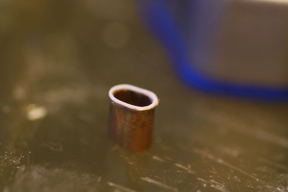

Funnel time. :thumbs_up_1: A couple of options here... sand down a plastic dowel? Bend and shape thin sheet styrene? Build up from layers? All have their pros & cons, but I thought I'd start by going to the old tubing bin and seeing what I could find. Several times over the past couple of years I have found myself compulsively snapping up tubing from the local hobby shop... only to take it home and set it aside without using it. You know how it goes... you buy something for one purpose, later change your mind, and then eventually use it for something else. So the question is... can I somehow find tubing that by dumb luck might turn out to be the right diameter? This first copper job was too narrow.
Try again...
Brass, slightly larger.
Lucked out with the size on that one. It fit perfectly over the outline on Bruno's funnel base.

I thought I would try and show the process of cutting a window port through the hull. A tricky procedure for a couple of reasons.
Here you can see where I have cut the window into the existing planking. This must be done carefully, both to avoid cutting adjacent planking, and also to keep from loosening the surrounding planking if it is not firmly glued to the hull. The realization that it would be possible to re-position the window ports came after several 'between window planks' came loose and had to be replaced.
Next step is to prick and pry the cut planks free from the hull, creating a recessed port into which Bruno's PE windows can be set. Another motivation for cladding the hull in planks.
Sometimes all three planks would come off together. Sometimes they would come off individually, and sometimes I had to do a bit of carving to get the port hollowed out.
Here is the recessed port, ready to receive a PE window. I tried to cut the ports on the small side and then carve them larger, so as to avoid cutting a port too large for the window.
Here you can see planks have come loose from between the windows.
