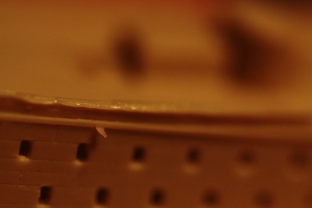

You may notice in some of these photos that the last large window in the upper deck are not aligned. (stbd is higher than port) I didn't actually notice this until I began laying in the upper wale strips...
laying in the upper wale strip. This was to be a base for two very thin brass wires to run almost like a de-gaussing cable right round the hull as per Bruno's plans.

Like a lot of my efforts on the Solferino this was a real challenge. Some of these wires had to be pulled off and re set before I could get them matching on both sides, the quick set up of the CA didn't help things...
Trying to capture the brass rod running along the top edge of the bulwarks... camera focus field not very effective in these shots, unfortunately.
