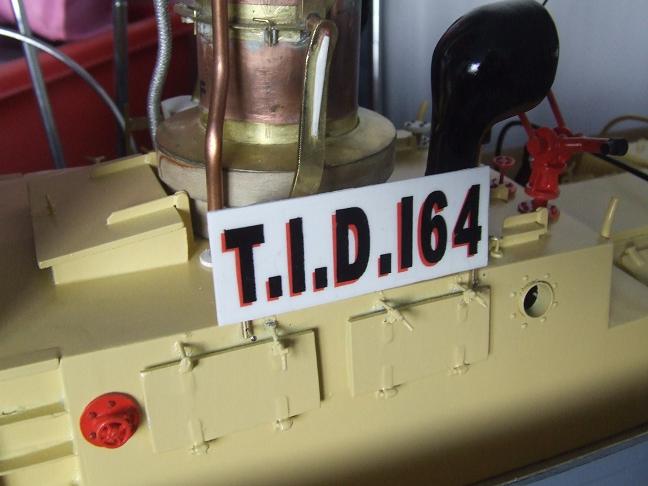

I have been making the two name boards that are mounted either side of the funnel. First I cut out the board from 1mm thick plasticard and the soldered together the brass support frame and locating brackets.
Next I had to produce the lettering T.I.D. 164 so I used my PC to create the artwork and then printed them onto some waterslide decal paper. The lettering is black with a red outline so I created two sets one black and one red. The red letters where applied first and the the black over the top.
Tiny

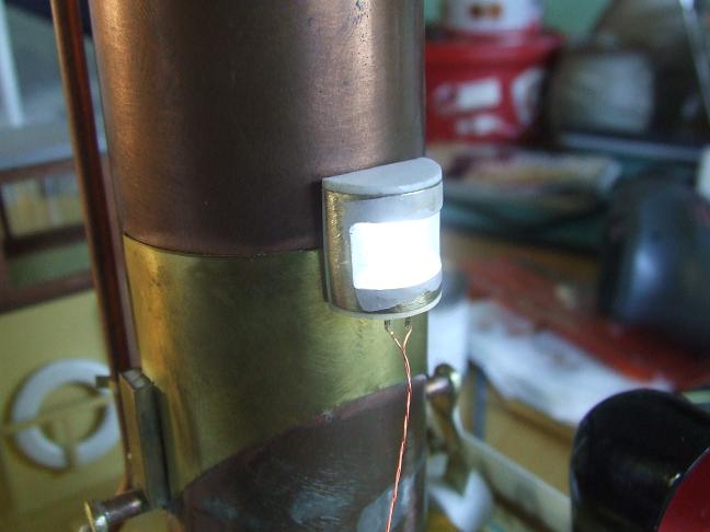

The port and starboard navigation lights are brass tube with brass sheet soldered on top which I then filed to shape. The lights are clear LED 8mm diameter which light up either red or green. The lightboxes are just thin plywood painted black inside and either red or green.
The funnel mounted stern light is made from 13mm diameter brass tube cut in half to give the half round shape with 1mm thick plastic sheet for the back and end pieces. The light is a clear 5mm diameter LED with thin magnet wire soldered to the cathode and anode and twisted together to simulate a flex wire. The magnet wire has a lacquer coating so not electrical short occurs.
Tiny
