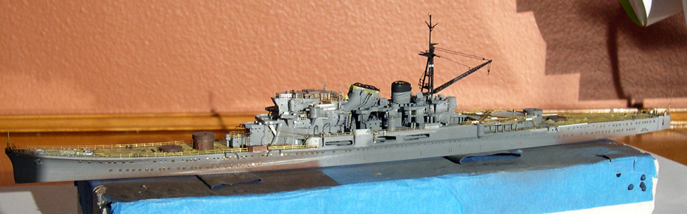

My offical entry photo of Maya, taken a week ago. She's now ready to paint, as seen over on my build thread.
It would be nice to finish her in time to do my own Aikoku Maru.

pagodaphile wrote:Sounds like I've had the same problem. I was using the Prismcolor pencils, but the color won't adhere well. Maybe something to do with the surface preparation ?D-Boy wrote: Deck coloring looks lovely. I tried colored pencils once on an older mold IJN battlship... did not lay down as nicely as yours appears to have done. I see they are Prismcolor pencils can you specify what type (there is extraordinary variety out there!)
D-Boy
Thanks Guys -
The deck was sprayed with Humbrol #94, then drybrushed with Humbrol #93 (which I would probably skip next time since the colors are too close). Artist's pencils are Prismacolor in "goldenrod" and "sand" from Michael's craft store @ $1.65 ea.
I did not use a straight edge but just followed the plank lines in the deck freehand which kept the marks straight. Important to draw over flat paint since a gloss surface will not have enought bite to make the color stick. They seem to hold up pretty well, under masking tape (so far).

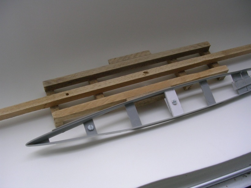

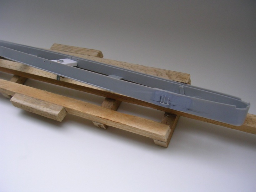

The Albany is a very nice ship.
The Pittsburg has been put in the dock for its construction. Preparation of the hull and prop guards with sprue.

Kometa, not to take away from your work on the Albany, but can you post materials used and measurements on makeing that jig. It looks perfect for working on 1/700 ships!
