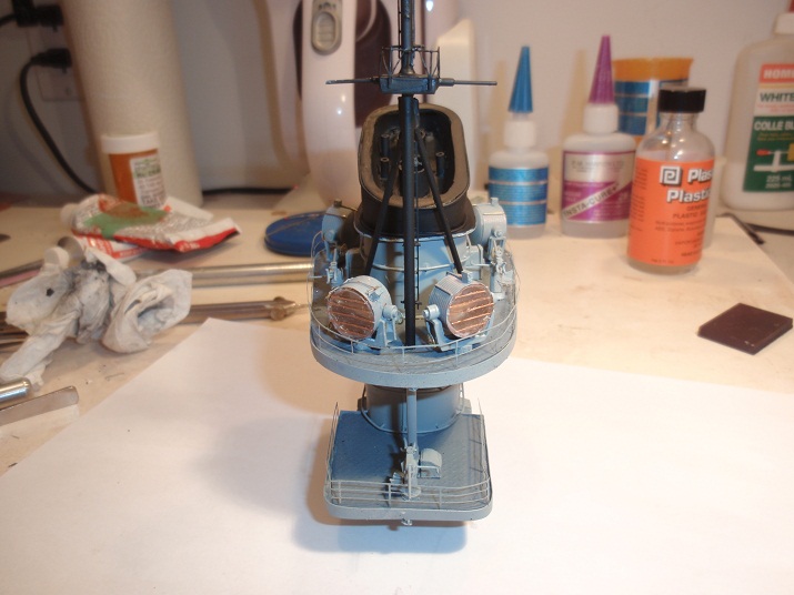

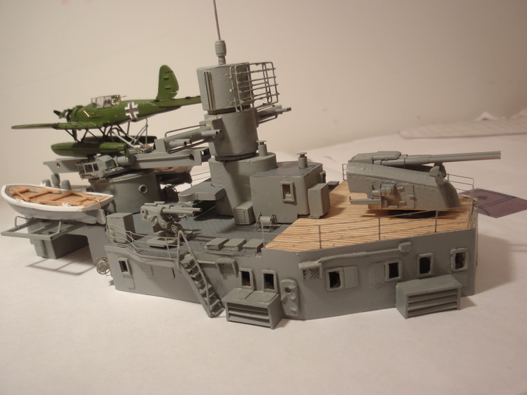

thanks song,jose,richard ,admiral.the back stucture is now finished,finely got my camera fiqured out,the color of these pics is right.some of my pics where coming out to blue.here's some pics.sheer is getting close to being done.
