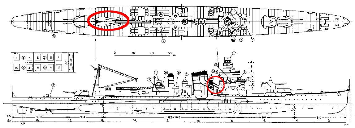

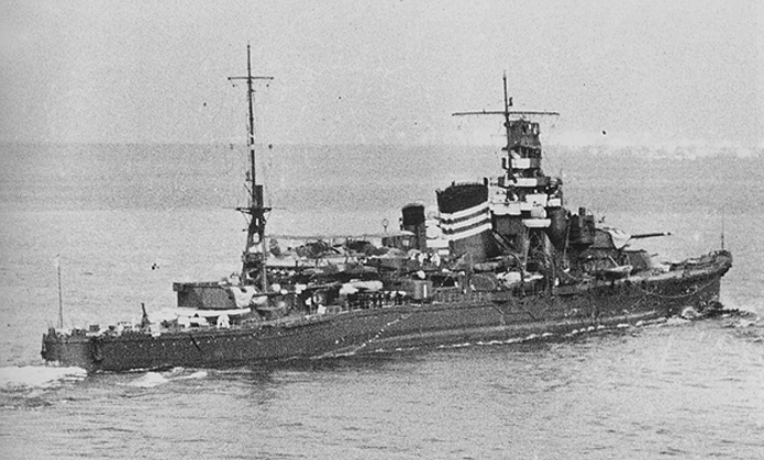

File comment: Furutaka in 1942 according to Profile Morskie 46 with marked suspicious sections

Thanks Peppe for very interesting posts. What is puzzling me again is the difference between the two Model Art drawings you posted (r1 and r3) in the vents on the back of the bridge (marked red in my previous post above) - these are clearly present in r1 and absent in r3. Also, they are absent in Lacroix p. 252 (Furutaka after 1939 modernization). However, they are part of both Hasegawa 1/700 and Blue Water Navy 1/350 http://www.steelnavy.com/BWNFurutaka.htm kits.
There is another difference between the bridge on r2 in your post above and in Lacroix on p. 254 - see below (shape of the fwd platform carrying the two dual 13mm machine guns, railing vs. solid wall).
Last but not least I noticed remarkable difference in the aircraft handling deck shape (under the mainmast) as it appears in the Hasegawa kit (looks similar to the one at r1 picture above, i.e. before modernization) and the one shown at r3, Lacroix p. 252, Profile Morskie and also the Blue Water Navy kit. The latter shape is much narrower and also the aircraft handling rails make more sense to me that way (unlike in the Hasegawa kit).

This
posted by Peppe is the correct drawing. In my visit in Japan the 1/700 Hasegawa's team said that they used the official drawings from the Tokyo maritime museum archive for IJN Furutaka and IKN Kako models.
Plus some new photos that they where available when the book "Japanese Cruisers of The Pacific War" was published. So the aircraft handling era is the correct on Peppe's second pictrure and Hasegawa's models. I guess the incorrect image of the aircraft handling era came from absence of overhead pictrures and hard to access drawings from the Tokyo archive.

That time the double 20 cm turrets replaced the single ones. The drawing on page .252 on the book "Japanese Cruisers of The Pacific War" is wrong as it missing the vents on the back of the bridge and it has the aircraft era the wrong shape.
The first drawing Peppe posted is correct.
I meant this one:
This is based on the official Kure Navy Yard drawing from 1939 where IJN Furutaka got her reconstruction.

Notice the height of aft main mast. Hasegawa is correct only for IJN Kako, you need to modify IJN Furutaka's to recemble the one on the drawing.
