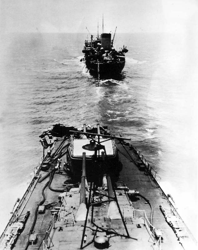

Posts: 1381
Off the current topic. Do any photos exist of the damage from her collision with Mikuma?
Gabriel
PostPosted: Tue Jan 10, 2012 3:56 pm
Posts: 1975
There is at least one photo of Mogami's forward deck, taken from her bridge, after the damaged bow had broken off. I don't know any online link to that photo.

1 or 2.

PostPosted: Tue Jan 10, 2012 4:43 pm
Posts: 1381
Wow that is a huge chunk missing!!!! Thanks Dan. If you guys have any other information on this (or the collision damage to Mikuma) I would appreciate it.
