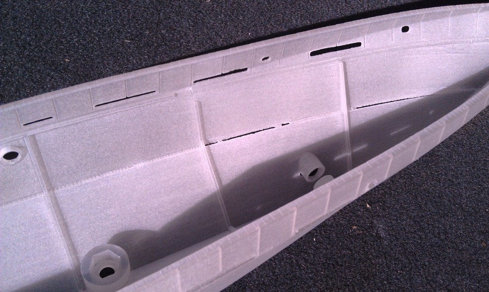

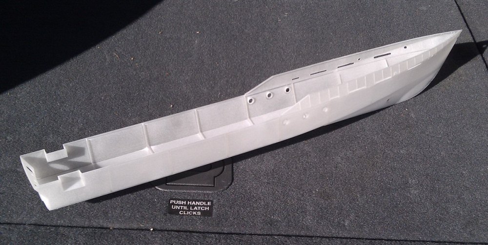

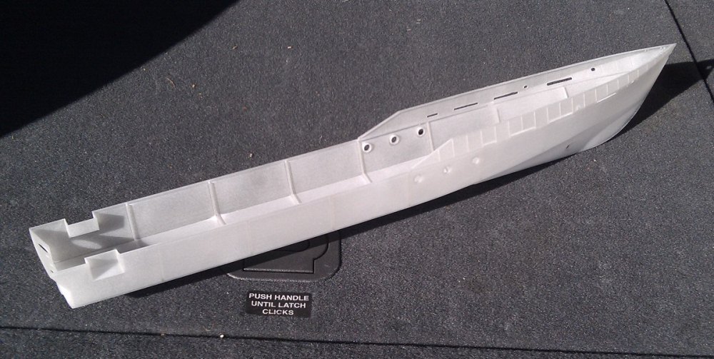

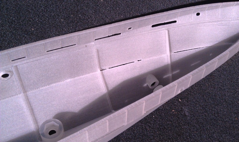

Here's my 23 inch long patrol boat hull, printed in SLA (stereolithography, where a laser draws the shape in a pool of liquid resin). This process, in large format, became available to me through a source other than Shapeways.
Looks pretty good for a first part of this complexity and size in this material. Part is straight & true.
One notable issue/design consideration:

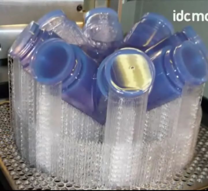

The SLA process includes creation of an integral support structure under the part. This is pretty fragile and is torn off the model by hand, then any nubbies are hand finished smooth... see the example part image.
But if you try to save on material with very thin walls, you might suffer some damage when the support structure is removed. This happened on my spray rail (the step at the chine), and around a couple of the freeing ports.
No problem, I can repair these... but I'd beef up those areas in future designs.

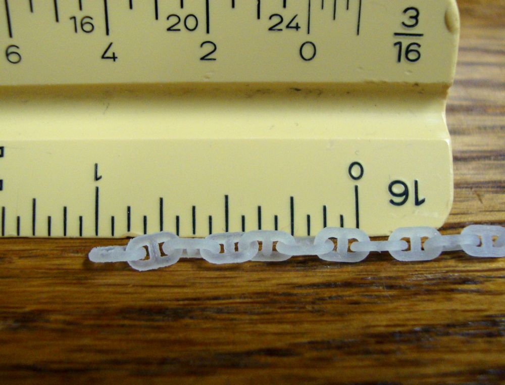

OK, here's something you might appreciate... 3DP stud link chain!
This is 36" of 0.9mm "wire" links (5.4mm overall length for each link). This about the right size for 1:96 battleships. This is a true 7 links per inch. The smallest metal stud link chain I'm aware of, from Cornwall, is 5.5 links/inch:
http://www.cornwallmodelboats.co.uk/aca ... hains.html
Tomorrow, I'm getting some at 0.6mm wire, 3.6mm link length... which is the smallest Shapeways will agree to print for me. Can't wait to see THAT!
Now, maybe you'd like to cut little pieces of wire to solder inside your open link chain, instead? :thumbs_up_1:
