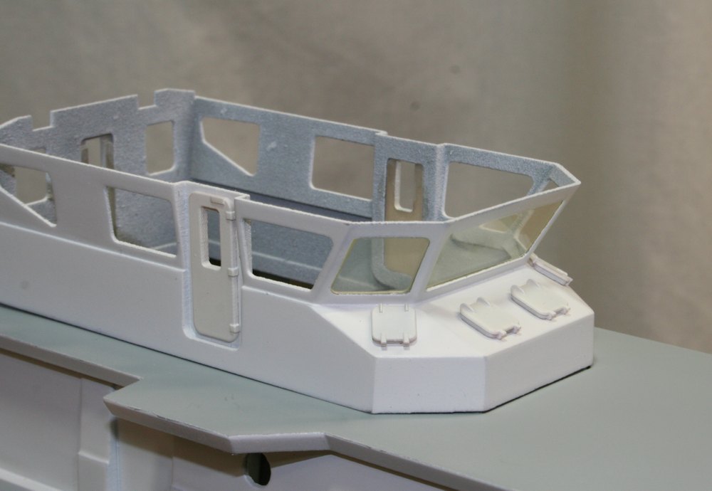

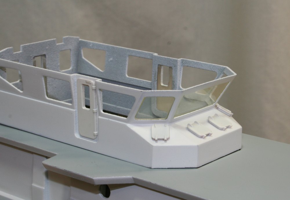

Working on the windows for the pilot house. These were printed in Shapeway's "clear detail" material, which is actually slightly yellowish. The as-printed surface finish is nowhere near optical... so all the windows were roughed flat with 400 grit, then taken to near optical with 6 grades of Micromesh... each pane polished on both sides.
The panes are all precision fit to the matching openings in the pilot house, with the right thickness to make a flush fit outside. A flange on the inside allows for solid location.
We're thinking to NOT do an interior, and since the greenhouse will be so transparent, the windows will need to be dark tinted. The last picture here is the builder's model, which appears to have either painted-on or sticker windows... I'll try to improve on that look!

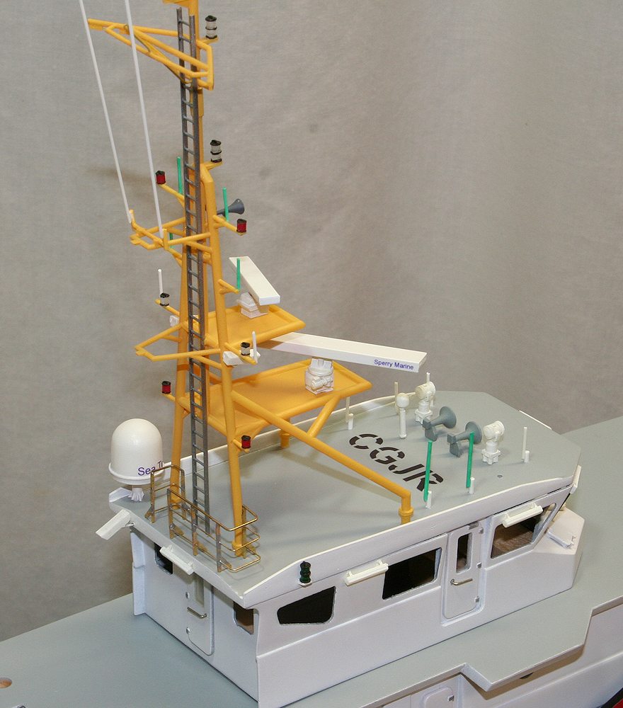

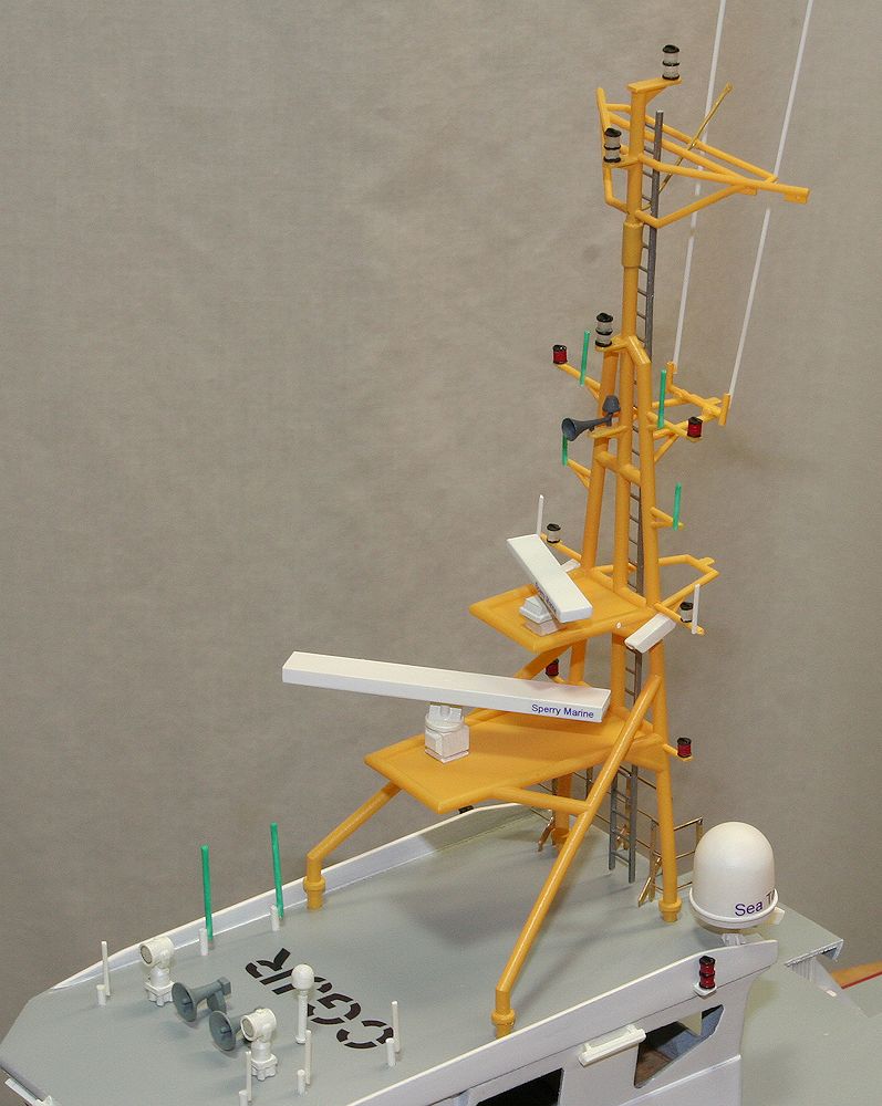

The mast is starting to get there... still need to make and add a few doo-dads that stick out here and there.
Everything is 3D printed, except the ladder (HO scale molded part), the whip antennae, and of course the PE stanchions.

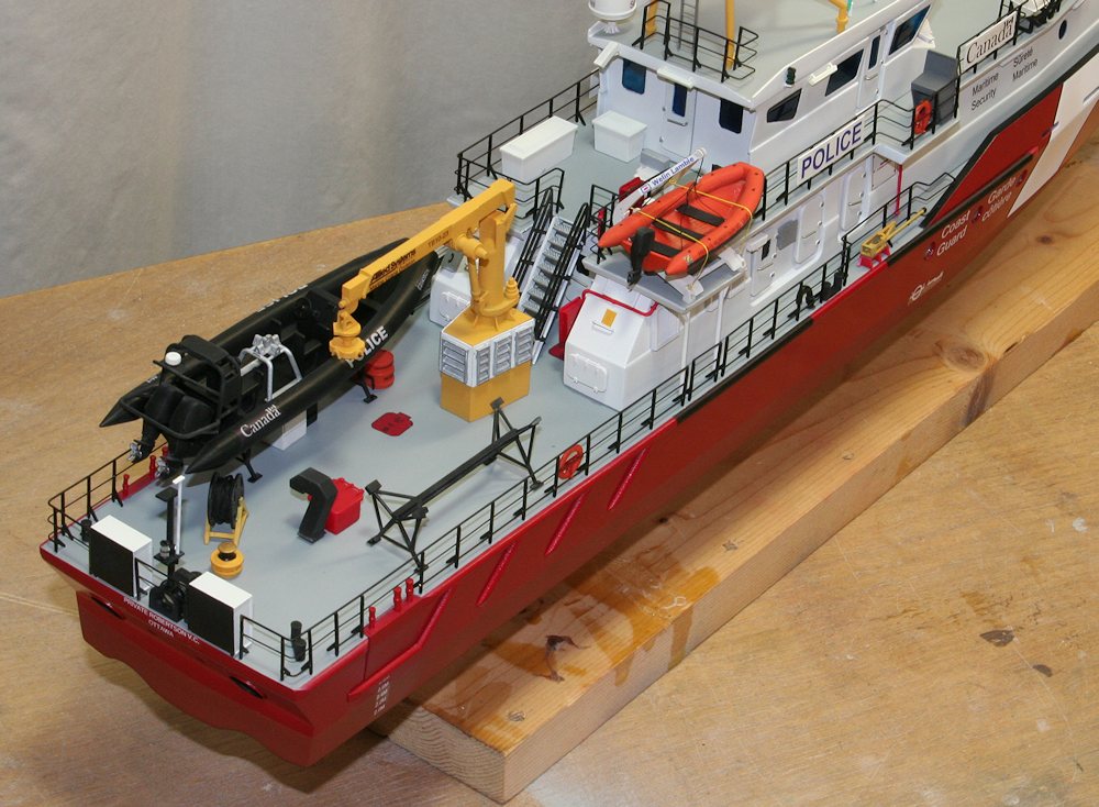

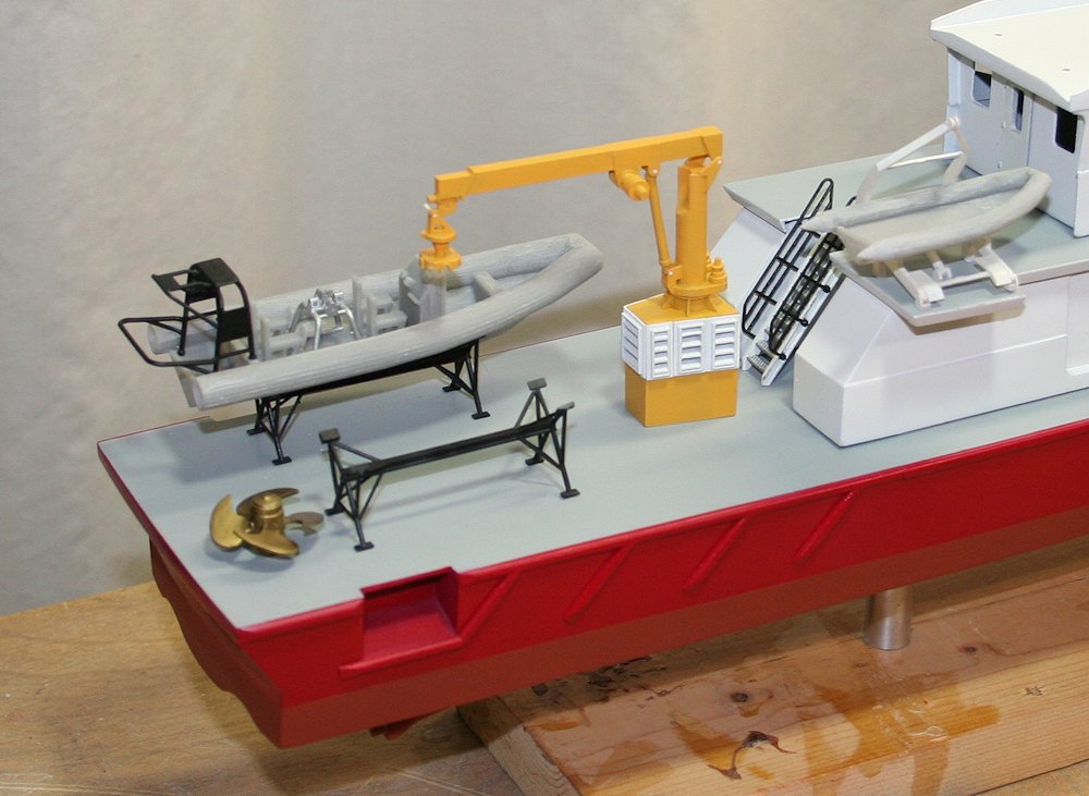

Filling up the after deck with printed RHIBs.

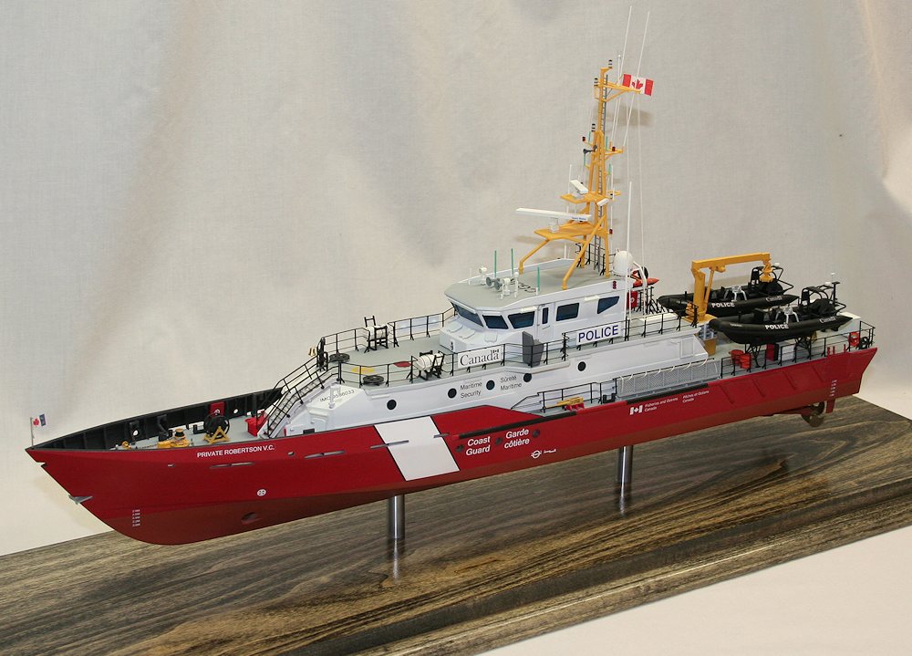

Almost there!
I goofed on sizing one of the decals for the hull side, have to wait another week or so to get a replacement, drats.

Thanks Tim, and it's been my pleasure... especially the part where I was given the opportunity to visit ship and crew, and to fill up my camera.
The model is a commission, and it won't be long before it goes to its new home.
BTW, I am compelled to point out that not everything on this model is 3D Printed plastic... I just turned the ship's bell tonight from brass!

And, done.
I'll forward more pics to the Gallery...
