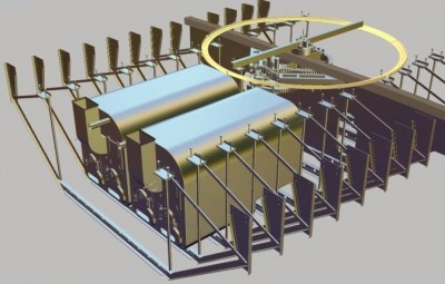

Here are two open views of the boiler installation, one from above the engine room and from below the galley. Each boiler was 8 feet wide and 9 feet tall, not counting the chimney. Only one wooden deck beam is shown, the one capping the central bulkhead. The rest are turned off for visibility. In the third image the deck beams are restored. The chimneys exhaust vertically to the deck between the last two aft deck beams shown. The fourth image shows the machinery in the context of a roughed-in hull. The side plates flanking the boilers are the walls of the coal bunkers. Michael

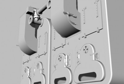

Here is a test fit of the two safety valves. The valves are mounted above the main steam lines out of the boilers. Each valve is intended to limit steam pressure in the boilers at 40 psi, maximum. The 6-inch blowoff pipe running between the two valves is to be connected to an exhaust line
The lead cubes weighting the valves are putting about 210 lbs of downforce on each lever. Each seated valve, assuming a 40 psi boiler pressure, produces an upward effort on the lever arm of 784 lbs. The length of the lever arm, measured from the fulcrum to the weight, is 15.86 inches. A 15.5 inch value is reported in Peterkin as the distance from the valve center to the weight, but re-calculation of the lever's properties suggests about 15.5 inches is actually the full length of the lever arm. This is a good thing because a longer lever would not easily fit in the tight available space.

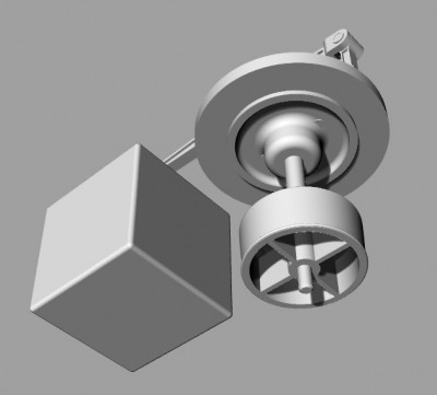

Here is one of the two valves seen from below:
The position of the weight, straight aft of the valve, is conjectural, but it is the only way it can be made to fit in the available space without rotating it off-axis. Note that in an emergency, if you needed extra horsepower, you could probably tie down the safety valves with a loop of cable over the lever arm and under the steam output pipe. Here is the mechanism with the outer castings turned off:

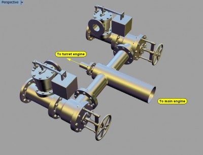

Immediately aft of the safety valve for each boiler is a main steam valve, in draft form in here:

The basic steam system for the turret engine is beginning to emerge. Before I drew this I had wrongly guessed that the fitting behind the big T-tube was a control valve for the turrret engines. It is just another juncture with a ring of bolts. This suggests there is probably a valve to start and stop the turret engines in the galley.
Here is a pictorial of the completed main steam and safety valve system and some of the piping.

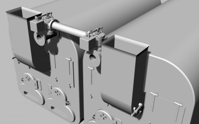

Top view shows how the valvework is notched between two deck beams and between the smokebox chimneys.
