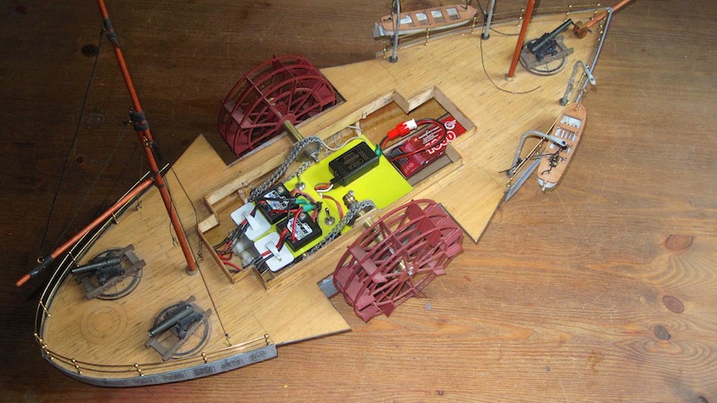

Not an ironclad as such, USS Coeur de Lion was a lightship tender loaned to the Navy Dept. in 1861 and converted into a gunship. She patrolled the Potomac and other rivers in Virginia, destroying or seizing several ships attempting to break the blockade. She also engaged two forts, forcing one to surrender. She also had the distinction of towing Thaddeus Lowes's balloon barge, the George Washington Parke Custis, considered to be the first "aircraft" carrier. My model is 22" in length (1/55 scale) and is inspired by a paper model designed by the talented paper modeller, Magnus Morck, now sadly deceased. I would describe all my models as stand off scale, and this is no exception, it is radio controlled, steered by 2 independent motors and although I have altered/ added items as I see fit, I hope I have remained true to the spirit of the original ship. Sharp eyed will notice that the davits have been moved forward, this makes the removal of the superstructure easier. I have added stanchions/rails - these are not obvious in the photo of the original, but I have difficulty believing that what was once an ocean going ship would not have guard rails, especially on the hurricane deck. The hull plating is an indulgence, I suspect the original was wooden hulled, yet I am unrepentant! The walking beam is operated by a servo that has been modified for continuous rotation, this is Y'd into receiver output for one of the paddles and although the response is best described as sort of proportional, it does allow the beam to rock at a dignified rate. I am also building the balloon barge to the same scale and hope to tow it around my local pond. If everything works out I should be able to raise? and lower a helium filled balloon using another servo converted to act as a winch in the barge. We'll see.

That's really beautiful work. Love anything with a paddle wheel!
It's really odd that you posted this today. Earlier this morning I was thinking of the George Washington Parke Custis and wondering what ship would go with her as a towboat. I guess that I had known that Coeur de Lion towed her, but I'd forgotten it.

Great model. Paddle wheels rule! How did you arrive at that scale? I am also curious as to what the hull looks like below the barge. I can't find any info on that. Could you post a pic?

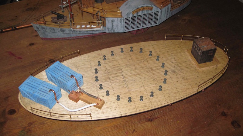

Thanks for the comments.
Hi Rusty, re your queries:-
(i) I too have been unable to find much information about the design and construction of the GWPC. We know she was a converted coal barge and most barges, as utilitarian working craft, tend to be very basic in design, at least on this side of the Atlantic. I did find one picture of a vintage, US. coal barge on one site, it showed a blunt, slab sided vessel, and this is the design that I have adopted - it also has the virtue of being the easiest to build! I attach a photo of the hull. Incidentally, there is so much deck overhang the hull is barely visible from most standpoints.
Floyd Houston made a beautiful model of the G.W.P. Custis for the Naval Historical Foundation -(I haven't posted a picture in case I break copyright) - the hull shows fine lines, but this could be artistic license.
I have attached another fanciful? drawing of our craft, it shows very pronounced sheer in the stern and the hull could well be clinker built. I can't help wondering if this artist ever saw the ship.

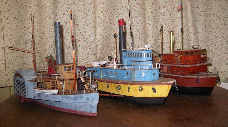

(ii) I didn't choose the odd scale, I decided on the length/size which happened to give a scale of approximately 1/55. I don't want to sound antisocial, but I do a lot of solitary sailing on a local canal, my boats are relatively small so that I can carry/launch/retrieve them easily without help. I attach a photo showing my paddle fleet, similar sizes but different scales.
The middle model is a freelance quarter wheeler paddle tug, unusual in that the drive to the paddles is via worm gear.

Excellent work on USS Coeur de Lion & GW Parke Custis!
I've had a file on this for several years thinking that it would make a fun project that I'd probably never get around to so I'm happy to see someone else was thinking outside the box.

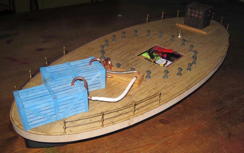

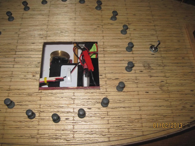

I attach a few photographs of the latest additions to the GWP. The skirt around the deck is 1/32 ply, cut across the main grain and steamed to shape. I was afraid that this might present a few fiddly problems, but using a thick cyan glue it went together quite nicely with no tearshttp://www.shipmodels.info/mws_for ... 52&t=4712#. With a little bit of judicious sanding the joints should be barely visible.
The other photograph shows the means for raising and lowering the balloon - I initially intended to run a lead from the mother ship (CdLion) to operate the balloon winch, but the wiring became a bit obtrusive so I opted for a separate receiver in the GWP operating on a spare channel. The hatch however was originally designed for access to the servo winch, it now has to accommodate the receiver and the battery for the receiver as well - it's all a bit gynaecological!
