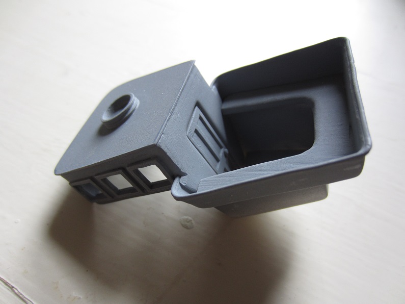

The �salami slice� construction continues.
Ok I have compressed the �on line� construction time for this model, but it did go together quite quickly. The design of the initial moulds and master patterns took about 50% of the total build time (approx two months), but once I had done these, the actual construction of the model itself did not take too long.
Back to the build.
The edge of the cockpit understandably had some sort of wood or metal edging. This shows up clearly on contemporary photos. Strip plastic could have been used to reproduce this but in the end I used fine lead wire, which was easily formed to match the curved corners. CA glue fixes this well.
The cast resin covers for the steering cables were also glued in place (red arrow). On the prototype vessels these covered the steering cables where they ran from the wheel to the deck edge, and thus reduce the �trip hazard� for the crew.
The other pictures show how the rear wall of the cabin is installed and how it slots into the front section of the cockpit. A little careful trimming was again required, but when I was happy with the fit these two sections were glued together with solvent weld adhesive.
You will notice that the model reproduces the small "sump" at the bottom of the cockpit just in front of the cabin door. I made sure that this was a waterproof seal as any water shipped into the cockpit would end up there (just like the real vessel). I wanted it to stay in the cockpit so it could easily be tipped out rather then seeping into the main hull space.
The edge of the cockpit was finished off with fine lead wire stuck in place with CA glue.
The cabin and the cockpit slot together.
Having slotted the components together they were glued with solvent weld adhesive.

Hi all
The two cabin/cockpit components were now glued together. You can see the small gap under the door which needed to be filled to prevent water ingress.
The cabin had to be reinforced slightly along its lower edges. Two small strips of plastic were glued along the inner edge (red arrows).
This also increased the surface area to be glued to the deck when this component was installed. I was sure that just gluing the thin edge of the vac formed cabin straight onto the deck was a recipe for disaster. The cabin roof will be removable to access the on of switch and as the roof was a interference fit I did not want to end up pulling the whole cabin off the deck!
Two reinforcing strips were added to the lower edge of the cabin.
