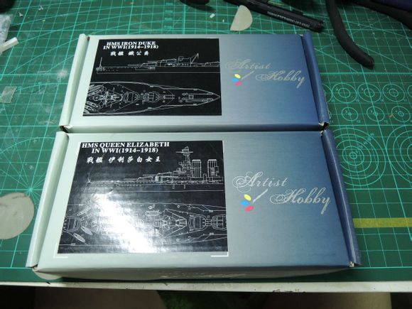

this review is translate from my friend's writings.
at first I will give a poster.

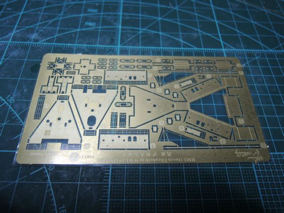

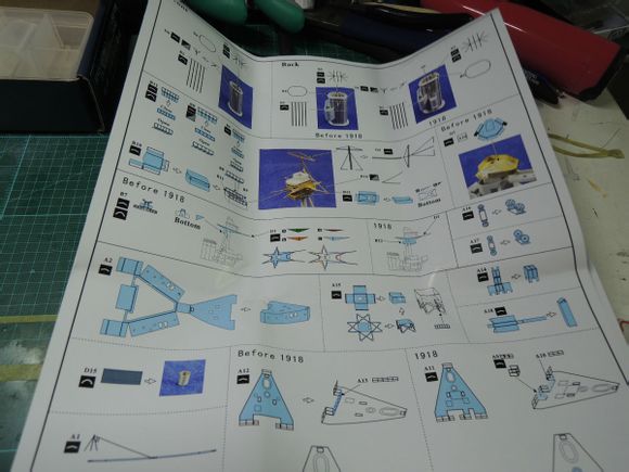

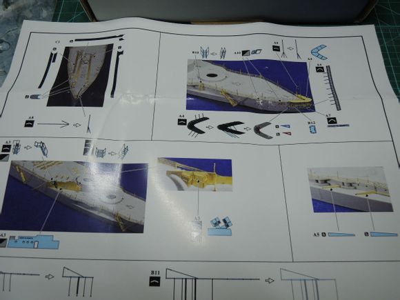

then is the instructions leaflet and the contents

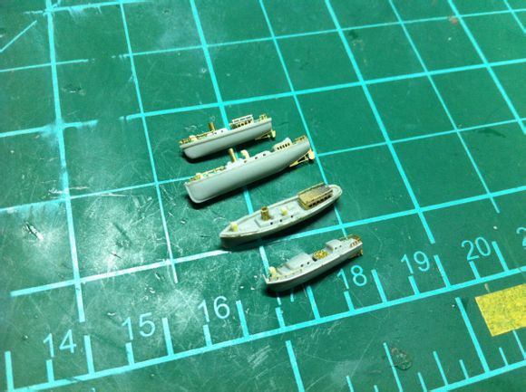

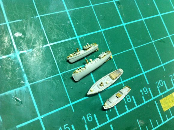

more details
blw

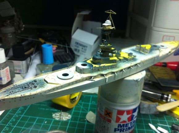

Works in Progress

Completed photos

Nice complete model! I really like the paint job on the deck.
I notice that this sample has a warped hull too - even more than mine, which is quite obvious nonetheless. I guess I'll have to put it in some warm water before I do much more work on it.
... Brian

Do you want to know how did he paint the deck? if you want I will ask for the photo about paint deck.
I think you look really carfully,but in fact? the plastic show box bottom become bend....
In my opinion?you may fixed you ship on the bottom of show box by screw. hot water may let your pe fall down or make your ship bend worse.....
