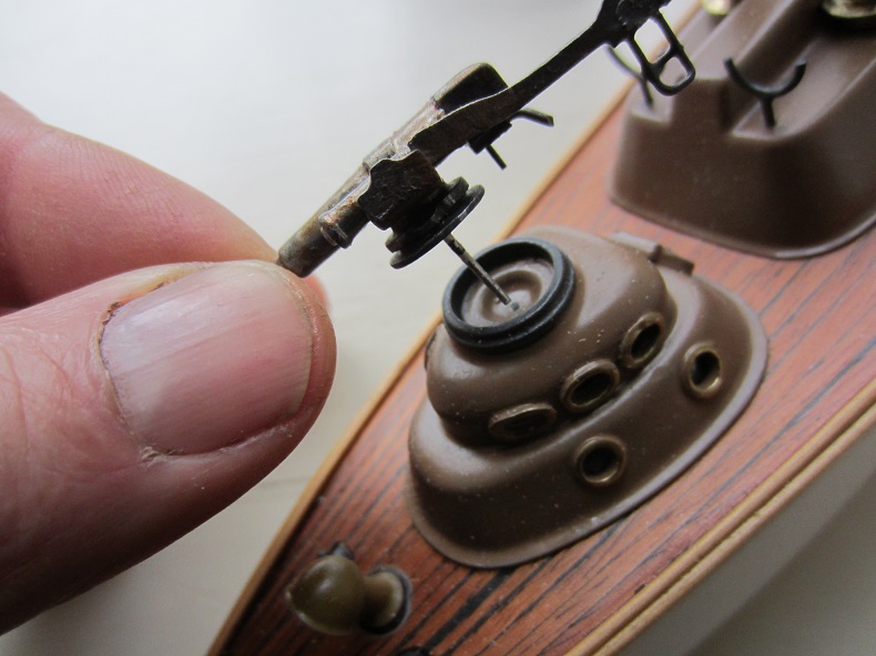

The three pound gun was painted in a smart "Edwardian" polished gun metal colour with a slightly different bronze colour for the breach block, operating handles and barrel tip. The shoulder stock had a padded roll along the part that fitted into the gun layers shoulder. These were sometimes covered in a rope binding or sometimes a padded canvas roll. They would often be "blanco white" to make them smart. I painted it off white on this model.
A small hole was drilled into the "fustrum" so that the wire threaded into it. I did not glue mine in place, but I left the wire quite long to reduce the chance of the gun falling overboard. I could therefore sail (or display) the model with or without the weapon. I could also remove the gun if I was carrying out any internal maintenance to give me a bit more room.
The mounting wire for the gun was left quite long to reduce the chance of the weapon falling off.

Hi all
Well after the brief look at the civilian version of a steam picket boat, here are a couple of pictures of the nearly completed RN version I am building.
It only remains for me to add some minor small fittings and these will be covered in my next few posts.
Hope you like it so far.
RN Picket boat model 1/48th scale.
