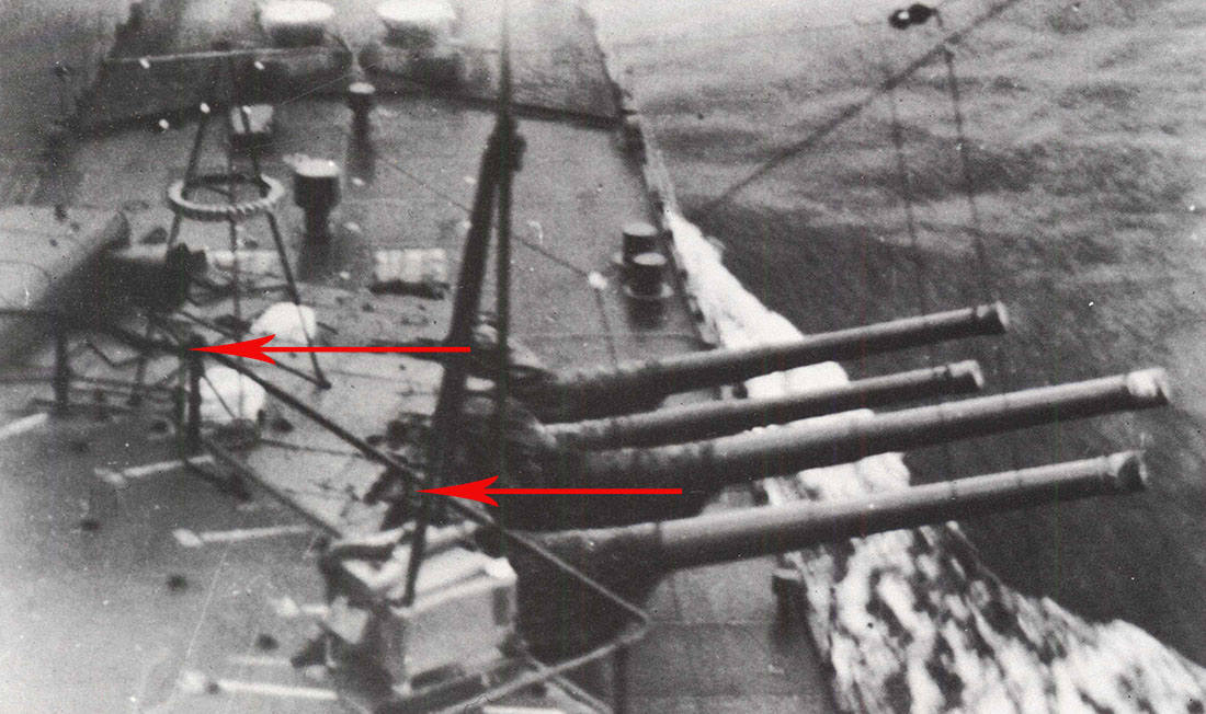

Unfortunately, all my reference photos of Kinugasa are not clear enough to show the presence of the thermal baffle coverings. Nor do I have any later than Oct., 1941. I would not be surprised to learn that Mucho has access to references that I don't. :smallsmile:
However, if you accept the premise that the IJN upgraded sister ships to the same level of fit, particularly before the war, then I believe that a view of Aoba answers your questions. The photo below was one of a number taken aboard Aoba enroute to Cape Esperance in Oct. 1942. In the cropping, the bottom red arrow points to some of the thermal baffle openings on turret #2. The angle of the turned turret makes it difficult to determine if this set of openings is to the outside of the starboard 20cm gun, or lies between the two barrels.
The upper arrow points to where the hood of the training box should be, but all I see is a plated over cover.

That´s ,,,,,Kinugasa in action on the photo.
/mutsuo s.
