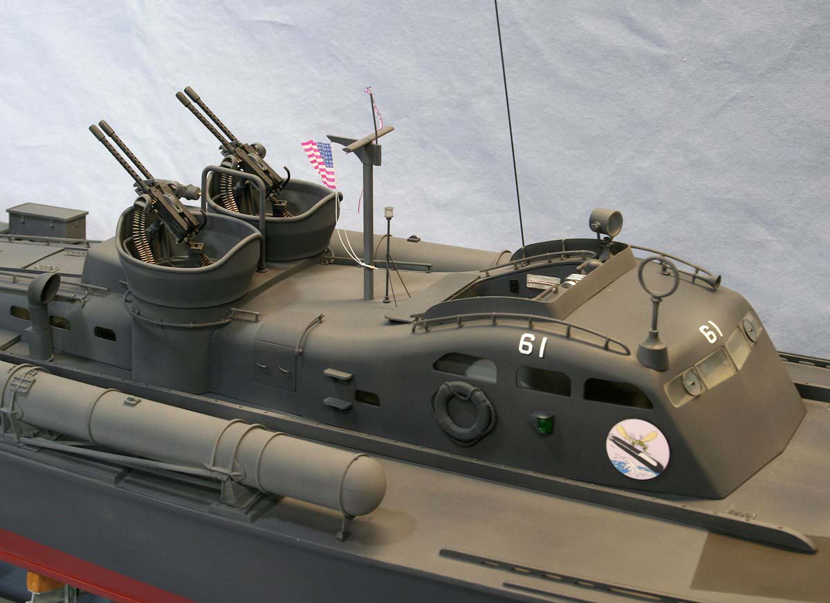

FUD details on my latest 3D Printed model in 1:24 scale (cabin was made with yet another process, "stereolithography"):
