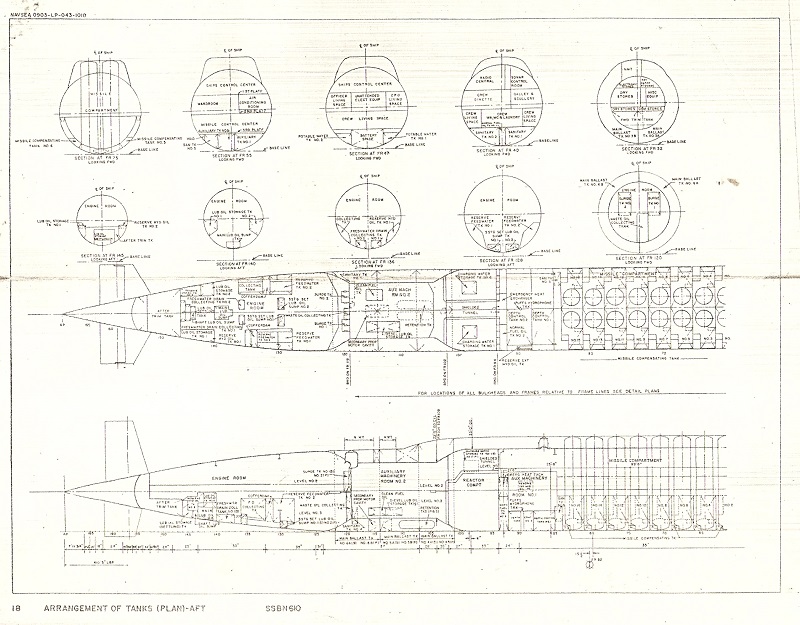

Dear all,
I just had the pleasure to construct the recent 1:350 MikroMir Lafayette, along with the George Washington of the same manufacturer. It struck me that the missile tube section of the Washington was much shorter (12.5mm or half an inch) than that of the Lafayette. Well, I figured: isn't this almost exactly the length difference between the Ethan Allans and the Lafayettes? :eyebrows:
And then checking the references: as the Poseidon missiles were 6'2"in diameter versus the Polaris 4'6", this differences could very well be accountable for the length difference between the Allan and Lafayette boats, and also the explanation why the Allans couldn't be upgraded to carry the Polaris missiles. Here's the math: there are eight missiles lengthwise, each Poseidon missile adds 22", so that makes 176" in total. The difference between the Allans and the Lafayettes is 180", so only 4 inches not accounted for, or less than .3mm on 350 scale...
It seems the Lafayettes (and Madisons and Franklins) had been designed from the outset to take the larger Poseidon missiles, and needed an adapter tube to carry the smaller Polaris missiles. This picture tells it all:
The Allans only had the smaller tubes, similar to the Washington, and no room (lengthwise) to allow for the larger Poseidon tubes.
So: am I right to conclude that for building an Ethan Allen from the Lafayette kit, I need only reduce the length of the missile compartment by 13 mm (scale 15 ft), and make a new deck with smaller tube covers, similar to the Washington's, but with the width of the Lafayette deck? Anyway, the length reduction isn't in the tapered area as Tom Dougherty suggested. :cool_2:
Of course the rudders need also be somewhat reduced in size. Btw: I found slight errors in the MikroMir kits: the lower rudders need to be reduced in height as the shouldn't protrude below the keel line. The draft marks on the upper rudder tell the story, how high the upper rudder rises above the keel line. :thumbs_up_1:

PostPosted: Sat Dec 19, 2015 4:18 am
Posts: 1813
Most authoritative sources quote the length of the Ethan Allens as 410 feet 4 inches, so the difference with the Lafayettes is only 14 feet 8 inches, or 176 inches. This equals therefore exactly the added increase of the diameter of eight missiles.
I was convinced, so I bit the bullet. Here's my Ethan Allen, in company with a George Washington and a Lafayette model, with the missile compartments aligned:

I'm only somewhat uncertain about the location of the hydrophone stump on the bow, it seems somewhat closer to the sail than on the subsequent Lafayettes. Can someone shed some light on this maybe?

" [And then checking the references: as the Poseidon missiles were 6'2"in diameter versus the Polaris 4'6", this differences could very well be accountable for the length difference between the Allan and Lafayette boats, and also the explanation why the Allans couldn't be upgraded to carry the Polaris missiles. Here's the math: there are eight missiles lengthwise, each Poseidon missile adds 22", so that makes 176" in total. The difference between the Allans and the Lafayettes is 180", so only 4 inches not accounted for, or less than .3mm on 350 scale..."
The Poseidon is 6'2" or 74 inches and the Polaris is 4' 6" or 54 inches. The difference is 20 inches, not 22 inches. Where does the extra 2 inches come from?
Eight tubes times 20 inches is 160 inches, not 176

You guys got it wrong. Upgrade from Polaris to Poseidon made no difference to the boat length whatsoever. They simply took out the inner 'launch' tube from within the 'mount' tube to make the transition. This happened during a scheduled yard period.
Trust me, I was a Launcher Tech (Torpedoman) on the WEBSTER for nine patrols.

Hi David,
Thank you very much, the point is very clear! The Lafayettes could all be upgraded the way you described.
But the Ethan Allans couldn't, as these had only the smaller tubes similar as the Washingtons. That was the whole point of my conversion description. And therfore the length of the Allans was shorter than of the Lafayettes.
