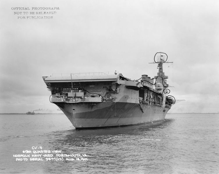

Some more photos scanned at NARA II. These were all taken on August 18, 1942, according to the notations on some of the photos. Two interesting things - note the RNGR still visible on the flight deck and the unfinished camouflage on the hull (looks like there is a band of Ocean Gray running all the way around the ship).
File comment: CV4-BS32930
File comment: CV4-7490
File comment: CV4-BS32927
File comment: CV4-BS32926
File comment: CV4-BS32925

Tracy White wrote:
MIne's due to arrive tomorrow and I'll give it a good look-see. I'm not as familiar with Ranger's changes but am studying her today when I get time.
I'm figuring on a '40 or early '41 fit, with Mahogany flight deck and yellow-winged, green-tailed Wildcats. It looks like it will make little difference if you start with a '44 or '42 fit of the ship, as it's almost entirely about leaving off or removing things, you just leave off a little more from the '44 version.
A few key points:
The kit comes with 9 5"/38 gun mounts (3 ea. on 3 sprues), but these are not for use on the '44 fit and are clearly meant for the '42 release. However, they are incorrect for the '42 fit as well - Ranger only ever had 5"/25s, from commissioning till they were removed in '44. The sponsons for the 5" guns were not removed from the ship
As built, Ranger had 40 .50 Cal. machine guns in her catwalks and open railings, with small angled bump-outs at each gun. (See here: http://www.navsource.org/archives/02/020458.jpg but note that in this very early fit, each 5" sponson only carries 1 mount instead of the usual 2; the other mounts are on the forecastle and stern decks) In early '42 the catwalks were extended out and scalloped, splinter-shielded, round platforms added for 20mm single mounts, owing to the guns larger size. In '44 several more of these same scalloped tubs were added. The kit comes with plenty of 20mm guns, but only 4 of the .50 cal mounts (probably some holdovers from her pre-war configuration, meant for the '42 fit kit.)
The deck structures fore and aft of the island were added in the '42 refit for 1.1" quad mounts. Prior to this there was nothing fore or aft of the conn. (See the picture cited above)
So, to convert:
Deletions: You'll need to shave off basically all the splinter shields and cut back decks added for 20mm & 40mm mounts. Carefully shave/sand away the raised locating tabs for the flight deck gun support structures and scribe-in the missing deck detail (small amount; not as bad as it could be.) Several components of the conning tower will be omitted, and some modified. Leave off the life rafts.
Additions: Add angled sheet plastic extensions at .50 cal positions. Get eight 5"/25 mounts (Veteran makes these; maybe others are out there too). Get forty .50 cal. water-cooled machine gun mounts (3D Model Parts has these), Get Trumpeter aircraft as needed for your preferred time period. Get more PE railings - most of the kit's catwalks are time-appropriately splinter-shielded, but backdating it requires open railings for all of them. You'll need several additional ship's boats (Not sure where to get these, of the types needed.)
All-told, probably one of the easiest (aside from acquiring the ship's boats) yet dramatic backdating conversions you can do in 1:350. And aside from the '42 fit kit maybe giving you 5 each of TBDs and F4Fs (and perhaps some SB2Us?), it really won't place you any closer (in terms of work involved) to a pre-war Ranger than the currently-available '44 fit. So, I went ahead and grabbed it. :)
- Sean F.
I haven't finished my study of the ship yet. but there's a couple of other details to consider, depending on how the kit is done.
She had two different aft round-downs; a "longer" one similar in shape to the Lexington class (photos here, here, and here) and a constant radius "short" round down similar to the Yorktown and Essex class visible here. I don't have the exact date of this change figured out yet but it was at least by the May - July 1944 overhaul where her flight deck was modernized and strengthened.
Her stern AA fit changed as well, two 5"/25 guns pre-war switched for quad 1.1" mounts with two Mk 51 directors in between in 1942 (if not before - at least by April of 1942) and then a single quad 40MM with two 20MM guns outboard and a single Mk 51 director forward ("behind" the mount when looking forward from behind the ship) of the quad.
Minor detail notes:
* The platform for the smoke canisters under the aft end of the flight deck was cut down at some point. It's nearly full width early on but about half that width, port side only after her 1944 refit.
* The secondary control station (see Martin's photo here was cut back and the square windows changed to round portholes at least by January 1943.
* pipes for her steam whistle were run on the port side of the island from launch until probably the 1944 refit. These are visible directly under the chock a sailor is carrying in this picture. This was found to be "less than optimal" as at least one TBF crash into the island severed these pipes and they were moved to the starboard side, running in the same pattern as far as I've been able to trace.

Good point about the round-down, Tracy. The kit has the later type. I don't think it will be very hard to modify, though: no planking there at either configuration; cut off along a straight line, build a differently-shaped piece out of sheet plastic and glue it on.
The originally fitted bow and stern pairs of 5" guns ( http://www.navsource.org/archives/02/020458.jpg ), were moved up to join their partners at the four corners of the flight deck at some point in the mid to late '30s. See: http://www.navsource.org/archives/02/020403.jpg - I think that might be a canvas-covered practice loader in the port-side one. Funny thing, those four platforms were always big enough for two mounts each, though the ship complete with one in each, plus the pairs at bow and stern - did they perhaps originally plan for 12 mounts?
This August '42 photo: http://www.navsource.org/archives/02/020420a.jpg shows the referenced stern 1.1 quads & director positions nicely, and the pairs of 5" mounts in the same positions as the previous photo - and note the letters RNGR still in use that late! (But certainly not in bright chrome yellow by that time)
Funny thing with the 5" mounts: the instructions point them out as "Options" in all eight locations (instruction pages 20 & 23). Seems the instruction writer wasn't so confident on the AA fit. Anyway, it looks like the key shape & size of the 5" platforms changed little, if at all, during the ship's lifetime; just what was placed there, in what quantity.
Correct about that aft platform; kit has it small and on port side (part D2, instruction page 20), as you've noted. Making a larger one will be easy. Some smoke canisters would be a nice detail to add, too: http://www.navsource.org/archives/02/020421.jpg The kit has a set of vertically-standing gas cylinders (part E4, page 20)
You're right, the early-type secondary control station would need to be scratchbuilt; the relevant kit part (H4, instruction page 23), is a relatively small rectangular box with three portholes across its front face. From photos, it looks like the early-style might have been present through '42. Also, '42 photos show the ship with at least half of her 1930s boat complement, so if the '42 kit is done right there would be some advantage to starting a backdate from there after all.
As for the steam pipes, the kit doesn't have them on either side, nor does it provide PE pieces for them. Brass-rod detail addition here, for whichever fit you do.
- Sean F.
