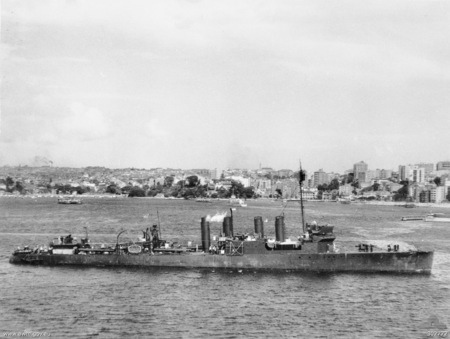

And here is WHIPPLE at Sydney later in 1942, showing a very dark Measure which was certainly not applied during her Asiatic Station days or the Java Campaign. (Photo from AWM, ID no. 302772)
Had such darker colors been available to the Asiatic Fleet DesRon 29 fourpipers during the Java Campaign, I suspect they would have gladly utilized them, as it would have provided far better concealment in their nighttime engagements...much unlike the pale whitish-gray paintjobs they were compelled by circumstances to accept.

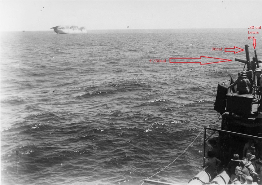

I have a question about .30 cal locations. I'm working on a model of USS Peary (DD-226) as she looked in the early autumn of 1941, just prior to her collision on 16 October with USS Pillsbury. E. Andrew Wilde, Jr's compilation "The USS Peary (DD-226) in World Was II" gives her armament, besides the usual 4" and torps, as four water-cooled .50 cal and four .30 cal machine guns. (There was no 3" AA gun.) I know from the various accounts in Wilde that the .50s were all on the galley (midships) deckhouse and I assume they were on the corners. I also know that there was at least one .30 on the fire control station (the platform above the nav bridge) and at least one and probably two on the after deckhouse. I have seen nothing that describes the .30 cal mounts but the written accounts always are phrased as if they were single mounts. Walkowiak's plans of USS Pope (DD-225) indicate locations for three .30 cal mounts: one aft and a bit to starboard on the after deckhouse and two on the after corners of the galley deckhouse. I'm going to assume that Peary used the same aft deckhouse position but that leaves a lot unanswered: were the mounts single or double? Where was the mount(s) on the fire control station? Do any of you know?
The starting point for my model is Tehnoart's 1/8" scale Ward kit and I'm nearing the end game. I'm going to paint it 5-L (using the "early 1941" color from my Snyder and Short paint chips). My authority for this (weak though it is) is the light color in the famously mislabelled photo of Peary with the mashed bow. I'm pretty sure that that photo was taken at the Cavite Navy Yard following the collision with USS Pillsbury on 16 October 1941. Peary was never again completely whole after that collision, which is why I've chosen to model her on a date just before.
PostPosted: Mon Dec 04, 2017 12:37 pm
Posts: 79
Good luck with this quest. I can tell you a little, but doubt you will find the details you want to the exact level of precision that model builders now seem to desire. On the positive side, no one alive today can come forward and dispute many of your choices very convincingly.
PEARY is especially difficult in some regards because she was modified more than any of the other Asiatic Fleet fourpipers due to 1) her damages at Cavite on Dec. 10, and 2) her ad hoc camo-painting after that, for her long, ugly odyssey to the 'safety' of Port Darwin. (Where to find the right color of "ARMY Green" that she used, for example? etc.)
But, she is easy to model in the absence of a true mainmast with aerials & a crow's nest, etc.
I can tell you that if she had .30cals in the locations you noted, they were highly likely singles and AFAIK Lewis guns on simple, vertical pipe mounts. (Did they even have other types of .30cal MGs available to the navy at that time?) I don't think it likely they had the kind of more sophisticated tripod mount as shown in Dwight Messimer's excellent book, PAWNS OF WAR (1983). There's a great description of an Asiatic sailor rigging up ad hoc MG mounts in Dan Mullin's book, also. That these guns did not have good clear arcs of fire is verified in the diary of Bill Kale from STEWART who recorded that her MGers shot down some of their own aerials in the Gaspar Strait sortie of Feb. 1942.
The poor guy who was tossed overboard from PEARY as she sought to evade air attacks off Manado, Celebes, Billie Green, was a machinegunner, and atop the after deckhouse. I thought his was also .50cal mount, but I would need to dbl-chk my sources to confirm that. Just the fact that he managed to fall overboard suggests the rails there were perhaps not as high as those elsewhere, or had gaps in them.
There are very good, close-up images of such after deckhouse .50cal mounts in the G. Arnold book, BTW. Whether PEARY's were like that--on tubs that extended out beyond the aft deckhouse, I cannot say. (Seems unlikely in view of the rapidity with which PEARY had to be buttoned back up & sent south.)
Re MG atop the FC station, that area was notoriously overcrowded during Action Stations, and rigging up water-coolant lines, etc, would have been more hassle...so no .50cal there. It was probably just a simple single mount for another Lewis gun.
On galley deckhouse, we do have some good photo evidence; it looks like the .50cals were on the aft edge (?). The only clear wartime image of a fourpiper's light AA armament is in the pic of WHIPPLE leaving LANGLEY. (See below; I'm not positive about the original source, but it is nowadays recorded as NH 92474.) That appears to show the guns on her port side, fwd of torp mount no. 2, if I'm not mistaken.
