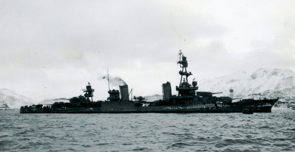

Salt Lake City in Alaskan waters, March 1943:
PostPosted: Fri Oct 27, 2017 5:55 pm
Posts: 575
Location: Peach State
Can I assume this photo was taken before the Battle of the Komandorski Islands?
There was a time when NARA printed photos in-house and you could request for them to print for detail from the negatives. I did that a few times back then, but I haven't ordered prints recently. Martin's photo would have been a great candidate for that. Sadly, I believe they're all out-sourced now, so I don't know what kind of latitude you have with ordering prints.
PostPosted: Fri Oct 27, 2017 9:40 pm
This photo of SLC was taken just after the Battle of the Komandorskis...
