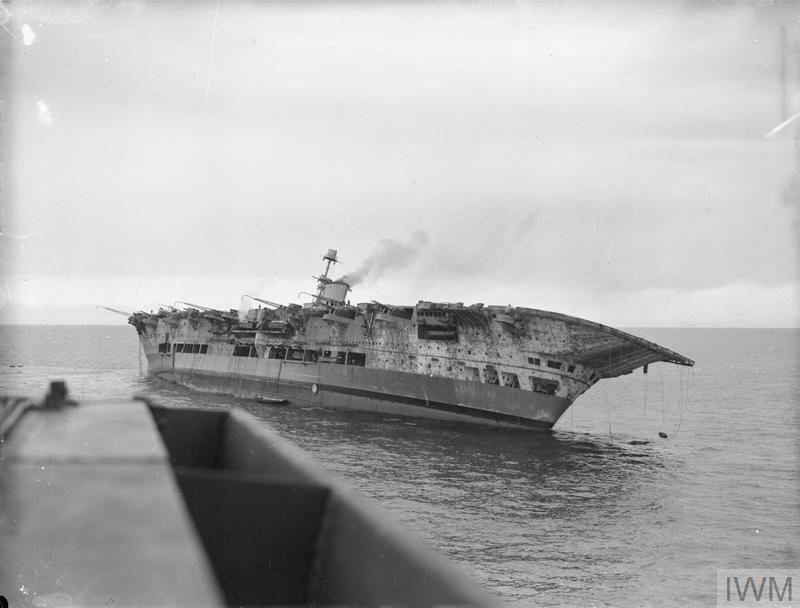

I have no opinion but it does seem the top coat has degraded a lot, where the coat lower to the waterline has not. Perhaps the damage was more extensive there and received a local correction. Could it be a single-colour system with severe wear showing the previous coat and then a lot of patchwork thrown in?
A great subject to apply the hairspray technique on...
If a model is to be painted as sunk, then what is necessary is a 507A base coat with severely distressed 507C above the knuckles but worn away amidships. Most ship modellers don't seem to be too interested in painting effects, but armour modellers are good at it and aircraft modellers often have a go. Three methods to achieve distressed 507C like this are:
1) Hairspray chipping
2) Salt chipping
3) Applying the 507C with a sponge
The demarcation simply isn't there when the knuckle isn't there to create it. It's clearly absent amidships. Where my large green arrow is it's plain that it's a single (dark) tone from boot topping to flight deck level. To mask a line around the hull at knuckle level and paint it dark below and light above will not result in what's evident in the photographs.
What's lacking here is a photograph clearly showing Ark Royal in two-tone but with the paint in reasonable condition. Was it ever deliberately in two-tone paint?
Given the lack of 507C below the knuckles fore and aft, and the poor condition of what remains, it's clear that the paint was applied in a rush without the full washdown procedure and drying times. We need to ask which is more likely:
1) that the sea has been thorough in removing what 507C it could rub against and it has paint stripped most of the hull or
2) that there originally was a deliberate hard demarcation at lower hangar deck level yet not a trace of it remains amidships
There is evidence to support single tone schemes, and there is evidence of a severely battered Aker Royal sinking with overall 507A and some flaky 507C high up fore and aft. What we don't have is evidence of a finish with two paints in anything close to a reasonable condition.
There are two paints on the ship there, I agree, but I am arguing that there is no evidence of a two tone scheme. The sorry remnants of 507C clinging to the bow and stern above the Ark's knuckles prove nothing other than that they're all that's left of some 507C applied in a rush.
We need evidence of a demarcation of where that 507C ended and there isn't any - it's been feathered away by the sea wherever there wasn't the knuckle to protect it.
That's a cracking photo EJ.
I think this would be a very rewarding subject to paint as a model, but we need to paint what we see rather than painting what we assume it originally looked like.
At the very stern, the demarcation is at lower hangar deck. Following the lower hangar deck along all those cut-outs we soon find there is no demarcation at all. It almost looks like there *might* have been a demarcation one deck up part of the way, but that would imply a dogleg in the demarcation line which is unlikely to have been deliberate.
We can see both 507C and 507A present, but as per my last post, this doesn't prove what it looked like when the newest 507C went on - it only proves what little is left of it.

PostPosted: Fri Apr 20, 2018 7:25 am
Posts: 2874
1940 footage, skip to 1:07
Also 1940, paint already coming off. Not so much below the knuckle!
Image FLEET OPERATION IN THE MEDITERRANEAN. NOVEMBER 1940, ON BOARD THE DESTROYER HMS KELVIN.. © IWM (A 2375) IWM Non Commercial License
Light tone coming through at lower levels too:
Image THE SINKING OF HMS ARK ROYAL. 13 NOVEMBER 1941, OFF GIBRALTAR. THE AIRCRAFT CARRIER WAS TORPEDOED BY THE GERMAN U-BOAT U-81 AND SEVERELY DAMAGED, SHE SUNK THE FOLLOWING DAY.. © IWM (A 6315) IWM Non Commercial License
Image THE SINKING OF HMS ARK ROYAL. 13 NOVEMBER 1941, ON BOARD AN ESCORTING WARSHIP, OFF GIBRALTAR. THE AIRCRAFT CARRIER WAS TORPEDOED BY THE GERMAN U-BOAT U-81 AND SEVERELY DAMAGED, SHE SUNK THE FOLLOWING DAY. THE DESTROYER HMS LEGION TOOK THE SHIP'S COMPANY OFF THE SINKING CARRIER.. © IWM (A 6337) IWM Non Commercial License
If this happened on my model I would call that a disaster during painting... top layer not setting as it should.... blame Humbrol, thinner, air brush setting, cat sitting on the compressor...
Anyway, in my opinion paint usually comes off gradually and that appears to be the case? I don't know much about what primers where used in these days, perhaps a more strict paint scheme was used near the waterline?
