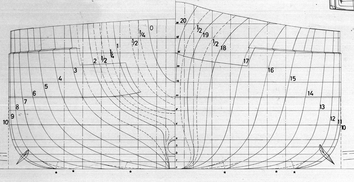

A little advice on my Bismarck, the Bulkhead Line Drawings has 28 Bulkheads, for scratch building is the amount of bulkheads on the drawing enough to suffice or do you create additional bulkheads to support the planking?
The next thing I am struggling with my line drawings show a camber which I assume is the camber of the deck for water run off, but I will be making my bulkheads like ribs and will be flat so that I can then put a deck on top of this which will deal with the camber but I am struggling to find how to adjust my Bulkheads Drawings so that I can have a flat area for putting the deck onto, how do you guys deal with this?

My plan for the deck is to find a base line that runs the entire length of the keel that is totally flat and have the ribs come to this point, then I will create a separate Deck that goes on top of this, finally I will work the camber on the deck when I do my hull planking, for example say at scale the middle of the ship the camber is 3mm high, then goes down to 1mm at the outer edge, then I will lay various thicknesses from 1mm up to 3mm planks then sand to get a nice smooth gradual camber from 1mm - 3mm. Hope this makes sense and is a decent way to do this?
I am just sorting out my templates for cutting and have come across a slight issue, where the stars are on my bulkhead drawing do I follow the solid line for the bulkhead shape or do I follow the dotted line?
Sorry for the horrible scan.

Its not the full dotted line bulkheads I am worried about at 1/4 and 1/2 positions, its the Bulkheads located at 12, 15, 16 ,9 and 6 as they have 2 contours, 1 if you follow the solid line and another if you follow the dotted line at the bottom.
Ok, my only concern with putting in the camber at this stage means I will not have a flat surface for my superstructure.
Kane
