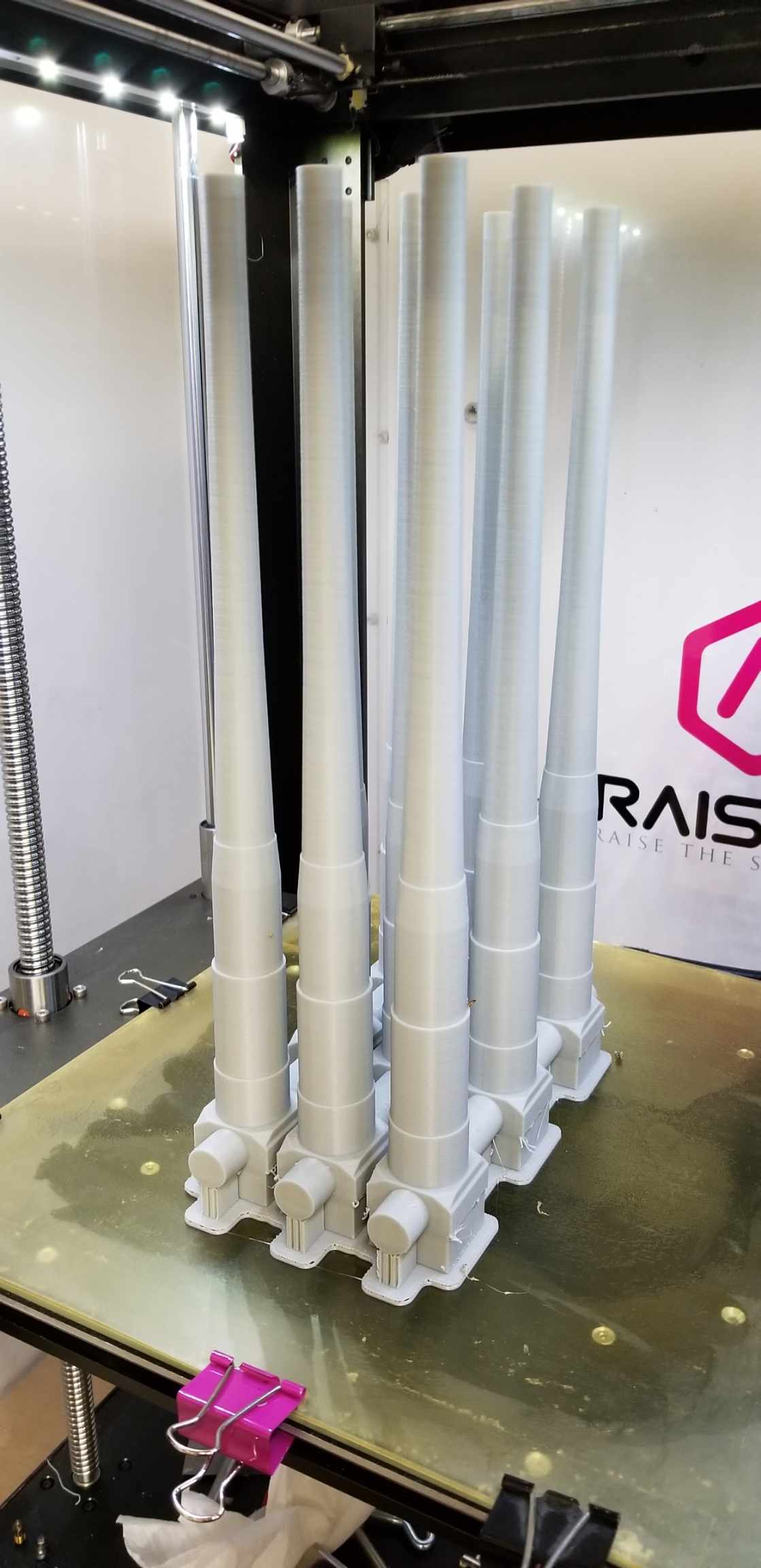

Nice work, Brian, enjoying the discussion and your efforts!
If there are any Model Monkey products you would like made available in 1/120 scale to save you some time and effort, just let me know. Products in big scales can be done. For example, a client in Washington state is presently building a USS Iowa BB-61 model in 1/48 scale. Yes, really, 1/48 scale. The turrets, directors and some fittings for his ship are all Model Monkey designs.
Here are the 16"/50 barrels for his model:
DrPR
