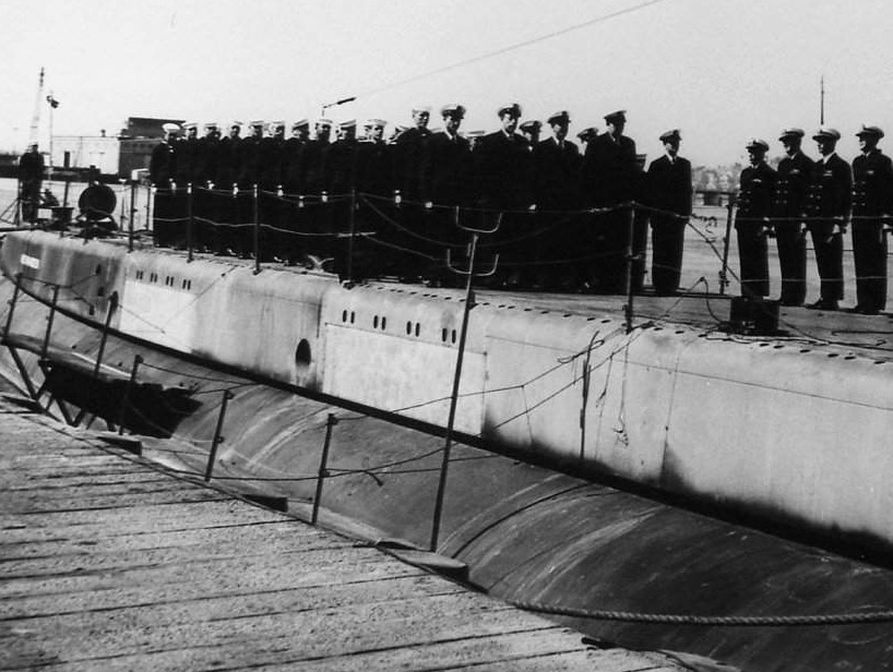

Doing a little photographic detective work and looking for confirmation of my conclusion. This is a photograph from HyperWar labeled as the USS Rock, SS-274.
The picture indicates no AA armament platform at the front of the fairwater. NavSource has several other pics that show such a platform on Rock, including that she was launched with one in place. So that rules out this being Rock with a Mod 2A fairwater, which I think was discontinued before she entered service.
I have seen some photos taken at such an angle that it makes the forward AA platform almost disappear, but not quite this cleanly. Therefore, my conclusion is that this is a picture of Rock that has had the forward AA platform censored, for whatever reason.
How sure are you that this photo is indeed of ROCK? As you note, the fairwater is intact (forward) on the photo -- all the photos I can find of ROCK show the forward platform cut down and prepped for 20mm installation. I personally have never seen evidence of censors retouching submarine fairwaters (though I'm sure it's possible).
It seems much more likely to me that this is a boat with the "Mod 2A" fairwater that was mislabeled as the Rock. Mislabeling photos isn't unheard of. For example, this photo is often said to be the Barb:
Wikipedia says she's the Barb, and there are photos signed by Eugene Fluckey himself:
But if you look at the limber hole pattern, she is clearly not the [img]Barb[/img].

If it was a 2A, wouldn't there appear to be less space between the gun and the fairwater from that angle? Similar to this:
http://navsource.org/archives/08/183/0825916.jpg
The amount of space between the two in the "Rock" photo is one of the things that made me think it had been altered. I believe I originally saw the photo--or one very much like it--in HT Lenton's "American Submarines." Don't have the book handy, but I do recall the photo leading me to chop the forward AA platform off a sub model I was working on at the time....
Edit: Just found this pic, labeled as USS Hake, on uboat.net which also seems to me to have the forward AA position edited out:
