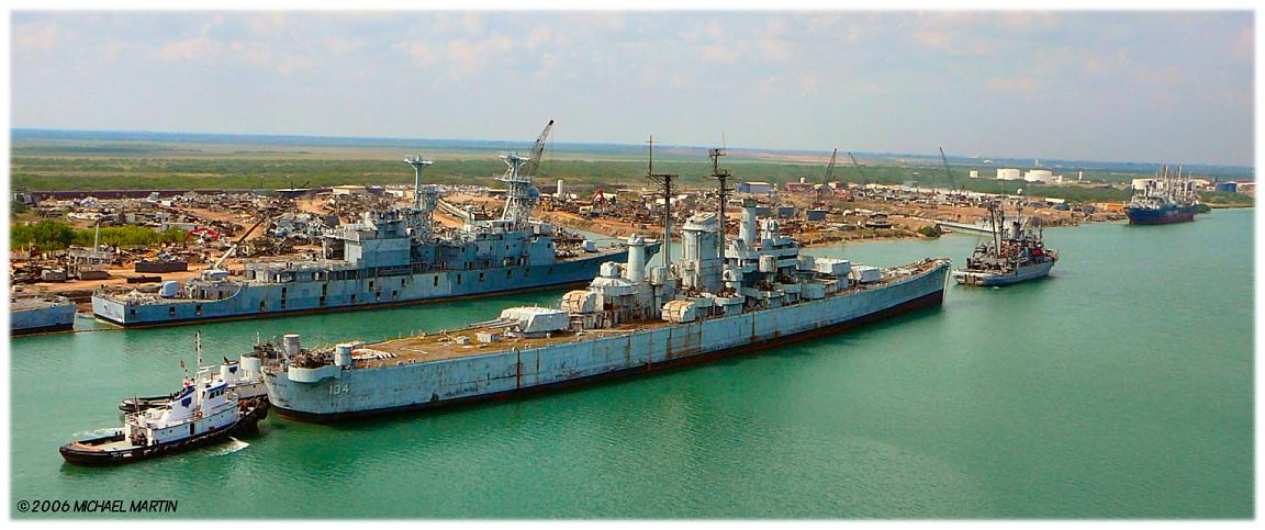

Here's the Des Moines being pulled into my shipyard for modernization. Watchout 2011. Sometime later this year, guess who's coming back to town?
Oh yeah, and that Sprucan in the background, yep she's at the shipyard for the same reason :heh:

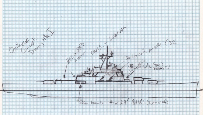

Okies here is my early concept drawing for my future 1/72 build this will be all I draw for now until my broken wrist is fully healed!! Its 2 difficult/painful 2 draw with this lump of a cast on my arm..
Please offer constructive ideas on placement of secondary weapons/sensors, etc.
Bridge design is loosely based on the Concept art Dave posted of the AEGIS conversion proposed for CGN-9 USS Long Beach.
My initial design has 32 strike length VLS per side(64 total) with a 16cell tac length VLS in place of the twin 5"turret[with ESSM's], possibly have a 5"mk45 62cal either side fwd of the VLS.
Still need 2 fit some 'poons in......
Cheers Bruce :cool_1: :cool_1:
Question: how much room/deck space is there either side of the aft turret?? What sized chopper could be squeezed past if the midships hanger is at deck level??

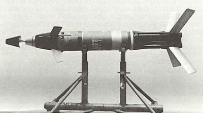

Just imagine what it sounded like when the Mk71 blew the ex USS Burns to pieces with laser guided inert rounds and when it landed 8 out of 10 rounds directly on target on San Clemente Island.

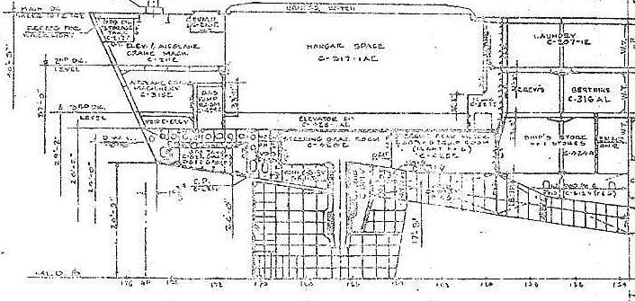

According to Friedman's US Cruisers, it turns out that the Albany's and Chicago's floatplane hangers were converted to accommodate 2 HSS-1 helicopters. They were the same size as H-60 helos. That means that the very same modification would enable them to accommodate 2 H-60 helicopters. Totally feasible and totally awesome. :thumbs_up_1:

I was also incorrect about the lengths! When both are folded, the SH-60 is about 3' longer than the HHS-1. Probably not a problem. If it is a hair too long front to back, I am willing to bet that the SH-60 could be pulled diagonal on the elevator and fit.
The scan has distorted the numbers a little, but it appears to be between 18.5' and 20.5' tall. Either of these numbers is consistent with ship decks being between 9' and 10' tall.
The Baltimore-class USS Chicago modified to handle the HSS-1:
As you can see, the hangar goes all the way to the starboard hull; unfortunately no pictures of portside.
There is still a lot of space in there. A friend of mine who was on Newport News said that the hangar went all the way port to starboard like on Chicago. Chicago just has a bunch of magazines and stuff off to the port side.
carr wrote:
Also, there's a significant weight difference with the HSS-1 being 7900 lb empty and the SH-60 being 15,200 lb which might impact whatever hangar lift mechanism you're thinking about.
I imagine the elevator machinery would have to be replaced one way or the other. It's age would likely be up for replacement. I believe the interior of the hanger would need to be modified like having new racks or other fittings welded to the bulkheads to hold spare rotor blades, wheels, and other bulky spare parts.

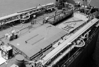

Also a huge issue is the hatch and maneuvering the helos around on the flight deck while the birds are on deck. See? It does not look too conducive to moving helos around.
This is how I have planned to make the sliding hatch usable on any below-deck hanger CL, CA, or CB, and if I were to do a new-build battleship it would also incorporate this design.
To do it justice, I am going to have to make a drawing of this, but I have a way to make it to where the reliable, water-tight, sliding hatch can still be used instead of resorting to the Virginia-class CGN design where the elevator elevates all the way. I will try to generally describe it. A flat cover would have to be fabricated over the top of the hatch so a helo could roll across it and so the elevated helicopter landing pad raised to be flush/level with each other. Like on the Iowas, the helo landing pad would have to be elevated anyway for AFFF plumbing to be installed underneath it. The top of the hatch and the raised deck would be flush and provide for a landing area that would accommodate a sliding hatch. This enables the hangar to be closed with the elevator down, and it would keep water out of the hangar.
