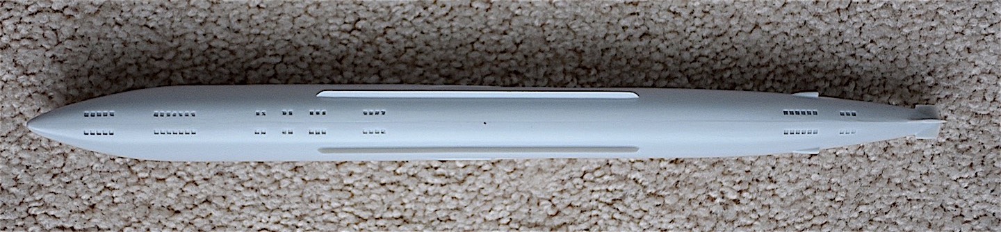

I'm working on the Blue Ridge Halibut kit, and they unfortunately there is very little detail below the waterline. Does anyone know how the flood holes and other outboard details were arranged? The only source I have is the Jim Christley drawing in Friedman's U.S. Submarines since 1945. I think I can make a reasonable stab at the MSW and ASW seachest locations based on drawings I have of the Skate, but I would have to totally guess on the flood holes.

The old Pitroad/Torpedo resin Halibut kit has the MBT vents along the bottom. As far as I can tell, they line up with the MBT (Main Ballast Tanks) in the interior cross section diagrams. I am not sure how you would cut these oblong indentations into the existing Blue Ridge resin kit; if you have any ideas, I would love to hear them. See attached photo for MBT vent positions. The Pitroad kit has no other markings, such as condenser inlet and outlets, etc.
The other issue to deal with in placing the vents is the difference in size of the two (reportedly) 1/350 scale Halibut models. See the side by side comparison photo. I am sorry to say that the older Halibut kit scales out just about right for the reported 350 foot length as opposed to the Blue Ridge kit. You would have to adjust the positions slightly for the Blue Ridge kit accordingly. I can scale out the positions for you on the two kits, if that helps.

Tom, I took the liberty of modifying your photo of the two hulls. I found that if I positioned them stern to stern, the hulls matched pretty well for much of their lengths, up to the small gap in the limber holes (shown by the red line). I then stretched the forward part of the Seawolf kit so that the stems matched. The end result matches the Blue Ridge kit pretty well.
That doesn't help explain why there is the discrepancy though.

Interesting work in "cutting" the hull and matching them up. I think you mean "Halibut", not "Seawolf" in your explanation.
I have both model kits and placed side by side, the Blue Ridge is noticeably larger. The older Pitroad kit is almost exactly 12 inches in length, which in 1/350 scale would scale to a submarine 350 feet long. That is indeed Halibut's length. The Blue Ridge kit comes out to 361 feet in length in 1/350.
Now, the Blue Ridge kit is a whole lot more versatile than the old Pitroad, and has far more options and topside detail. And, I really like the Blue Ridge submarine kits very much! But, I am puzzled, since every other Blue Ridge submarine kit I own has MBT flood ports on the bottom, as to why they were omitted from this kit.

Thanks for the photos Tom! The aft MBT flood holes seem to broadly correspond to the Skate flood holes, so I think I'll base my flood hole pattern on the Pitroad kit. I'm going to assume the MSW and ASW ports are the same as the Skate.
I'm not sure how I'll accomplish drilling or scribing flood holes. I could 3D print a template that would allow me to use a dremel to excavate the holes or scribe them. If/when I get around to it, I'll definitely document my method and post any useful templates.

Yeah, Halibut is basically a modified Skate class, with the section after the inserted missile hanger pretty much an unmodified Skate. The forward floods were modified with the addition of the hanger section, and there are ballast tanks around the hanger section itself. She was going to be a "one off" modified Skate, with a totally new design for four single Regulus II missile hangers in what going to be called the Permit SSGN class. Polaris development was accelerated and the Regulus and Regulus II programs were terminated with the Permits becoming Thresher class SSNs.
Of course Halibut was then modified and repurposed as a one off Special Projects boat.
Let me know if you need any measurements or better photos of the Pitroad kit floods. At one point, I was thinking of taking Plastruct STFS-4 finalize styrene square tubing and working it into hole drilled in the hull. Then putty around the tubing to fair it in. But, even the smallest version of the square tubing is probably too big in scale. Plus that would be a lot of fine detail work!

I've used black or dark gray decal sheet to make floods. I cut a strip the right width, then chop it into rectangles. Applying them is tedious, but Tamiya tape marked with the openings makes it easy to get them properly lined up.
If you have a decal printer, you could print them with approximations of the slot or hole patterns in the cover plates also.
