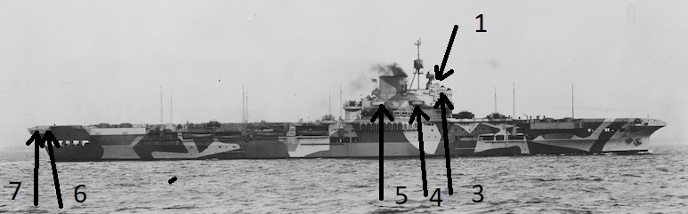

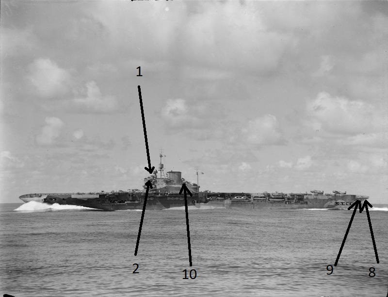

Here are my suggestions. 1-9 are pretty clear from various photos (others, not just these which are selected more for ease of labelling). 10 proved most difficult to locate. In the 4th photo I think that the barrel is horizontal and pointing to port about 20 degrees forward of broadside so that we are looking very obliquely across the front of the shields which are almost, but not quite, side on to the camera. (Formidable's 10 x Oerlikon's were in the same locations at this time.) Searchlights on bow sponsons retained at this time.

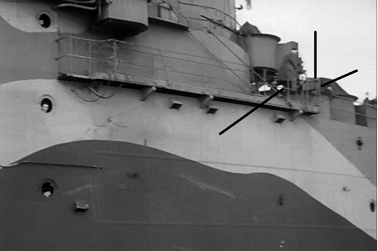

Quite right on the forward bow sponson Oerlikon's - I confused Illustrious with Indomitable.
On No.10, I'm not sure. Or is it obvious and i can't see it?
PostPosted: Wed Aug 07, 2019 7:25 am
Posts: 661
Location: UK
I know. It seems to be very hard to find clear photos of that location.
It was this photo of Formidable that prompted me to look closely at this location on Illustrious. The silhouette of the (shadowed) rearside of a set of 20mm shields there seems clear, and to the immediate left of them the silhouette of some box mounted on the railings at the end of that external walkway.
In your photo a similarly positioned box, the railings (particularly the third one down) and the chap standing there in a duffelcoat obscure and distort things but I believe that you can nevertheless discern the top and left edges of the left shield, and (in the dark) the right edge of the right shield.
In the 1941 USA repairs a new protected area/half tub appears there where none had been before. In the US dockyard starboard broadside photo taken 24 11 41 the back of it can be seen in silhouette with something in it of the right dimensions - but whatever it is was under a tarpaulin/canvas cover (as are other 20mm in that photo).
