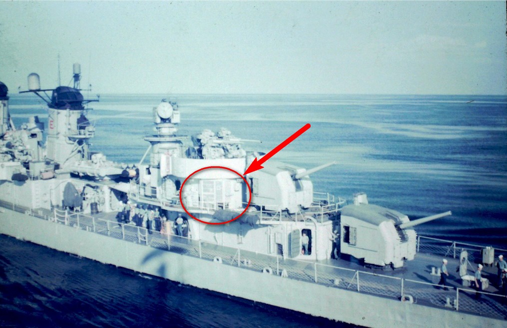

PostPosted: Sat Mar 28, 2020 4:50 pm
Posts: 681
Location: Vigo, Spain
Hi there all,
A question for you all experts, and please excuse my ignorance. What is this kind of cage that can be seen in some Fletchers, and could somebody have a close up of it ?
TIA for your attention and precious help, and very best regards from this side,
Willie.
PostPosted: Sat Mar 28, 2020 6:18 pm
Posts: 3841
Willie,
That "cage" structure was designed for capturing spent shell casings from the RFG 3-in guns. Trying to get good views of these is a bit hard. Finding a drawing is even worse. But, I hope these images help. I wouldn't be surprised if the construction of these cages varied from yard to yard and over time if an improvement was "found".
PostPosted: Sat Mar 28, 2020 6:44 pm
