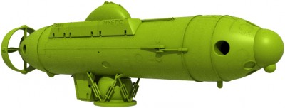

The original DSRV suitable for RC or static display is available here: https://www.thingiverse.com/thing:4676024

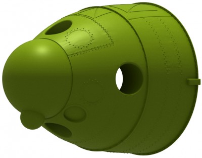

The majority of the green textured renders are the stock 3D pieces with the exception of the side-by-side screw comparisons at the bottom.

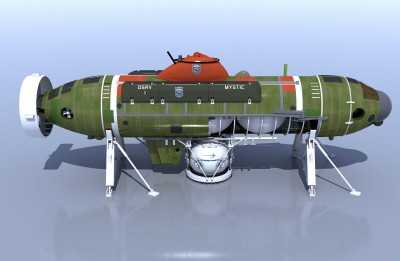

Carl has made an excellent boat that prints well with no support structure. After reviewing it, I decided to begin a re-design for a display model that will be double the 1/30 scale.
Since I started this little project, it has taken on a life of its own, and branched out into several areas:

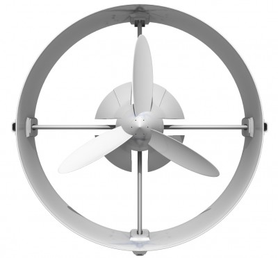

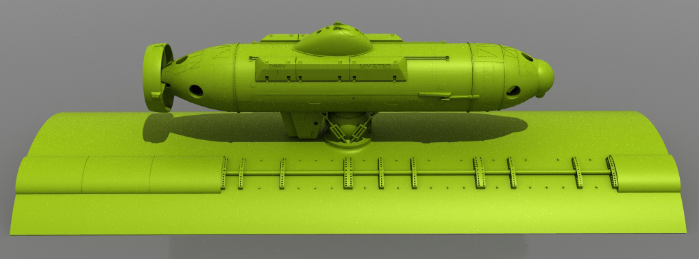

--A good model deserves a proper base. I modified the 3D printed pylons then created a 688 hull to perch it on.

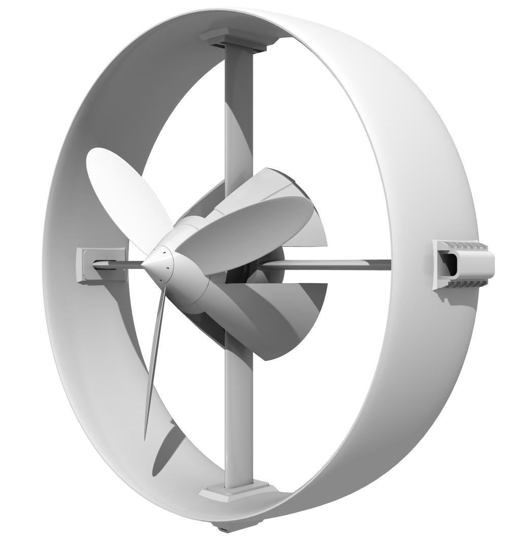

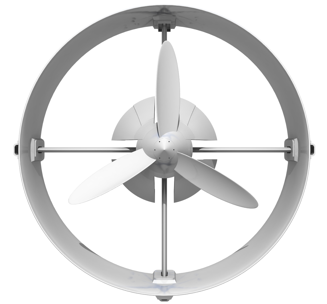

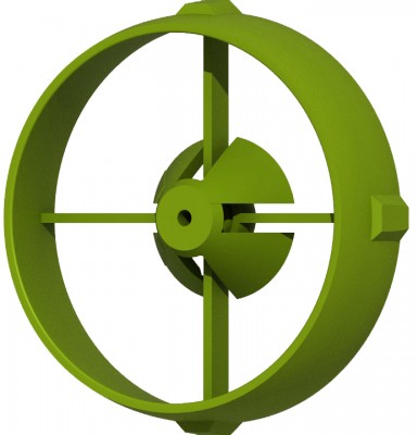

--The rear propeller shroud has been detailed, with streamlined leading and trailing edges, and revised mounts for the support arms.
--The original 3-bladed screw is perfect for 3D FDM printing and strong enough for RC use, but I wanted one that was thinner with less taper to the root, like the actual screw.
--The Transfer Skirt and Shock Mitigation System have been modified to closer resemble the real deal - mating flanges and hull penetrators were modeled in, along with hydraulics for the shock absorbers.
--The exterior will get a complete make-over; adding the remote manipulator, telescoping lower forward and aft cameras, a detailed upper hatch with removable sail, mid-sphere viewports, fiberglass panel lines, recessed light housings, sonar hydrophones and transducers, and a fully-detailed interior.
These are just a few WIP renders with more coming as it progresses.

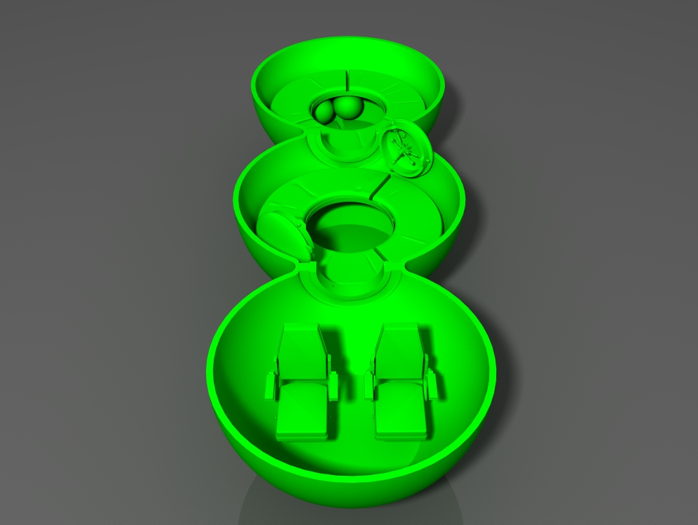

Two more - of the textured work in progress, and start of the pressure spheres.
CC

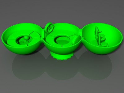

Taking a (short) break from the exterior to begin work on the interior. I've split the hull into two halves and work on it in thirds. The majority of the detail for the mid and aft spheres are in the upper half. The forward sphere has a lot of panels. Establishing these parts in each sphere helps to reference the parts that follow.
Here are some initial WIP renders:

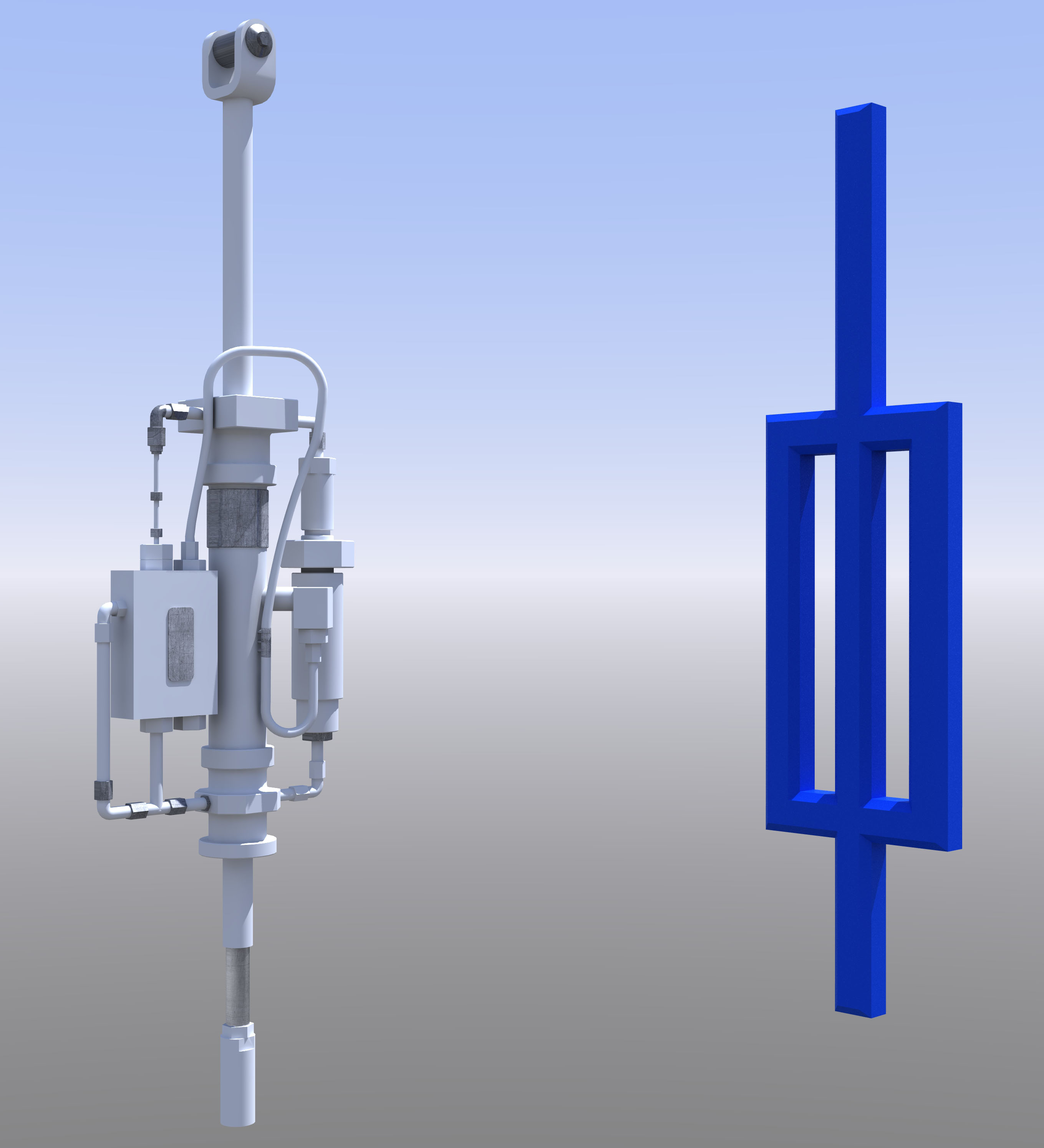

I found some additional reference material, (including the lower hatch hydraulic actuator) which never hurts, but it forced me to buff up the WT doors shown below.
- CC Clarke
- Posts: 75
- Joined: Sun Feb 01, 2015 3:15 pm
- Location: Crematoria (Arizona)
Re: 3D Printed DSRV and Subsequent Makeover
Finished the upper and lower hatches and animated their mechanisms as well. Both use a rotating hub to move linkages that move locking pins. Simple and quick-acting; the quick-throw handle on the bottom only needs half a turn to secure the hatch, and the wheel on the upper is about the same.
The lower hatch was more challenging because it uses a hydraulic actuator to swing the hatch 135 degrees from it's shut position - at least that's what was called out in my reference drawing. That's so the crippled submarine can open it's hatch and not interfere with the DSRV lower hatch.
Other than the manipulator arm, the mechanized components are complete and the overall pace of the modeling should go faster.
