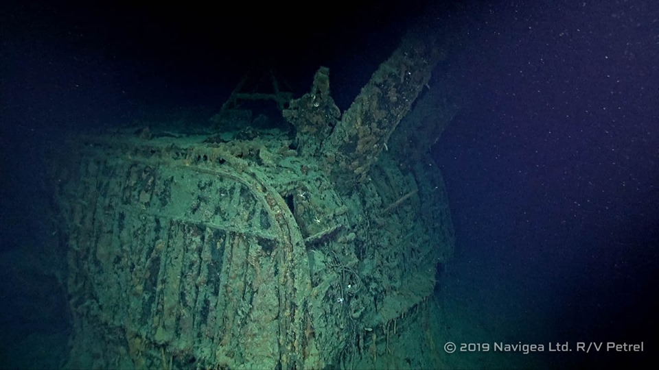

Furutaka was found by R/V Petrel in February, though just announced the other day, She's in three pieces.

PostPosted: Thu May 09, 2019 1:06 am
Posts: 140
Location: Corinth, MS
Three if you count the bridge structure as a piece. Looks like the bow broke off before the forward turrets. The main portion of the wreck is upright and in fairly good condition, it seems. They found Fubuki back in 2015, so that means both IJN wrecks from Cape Esperance have now been located.
