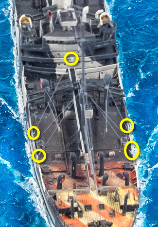

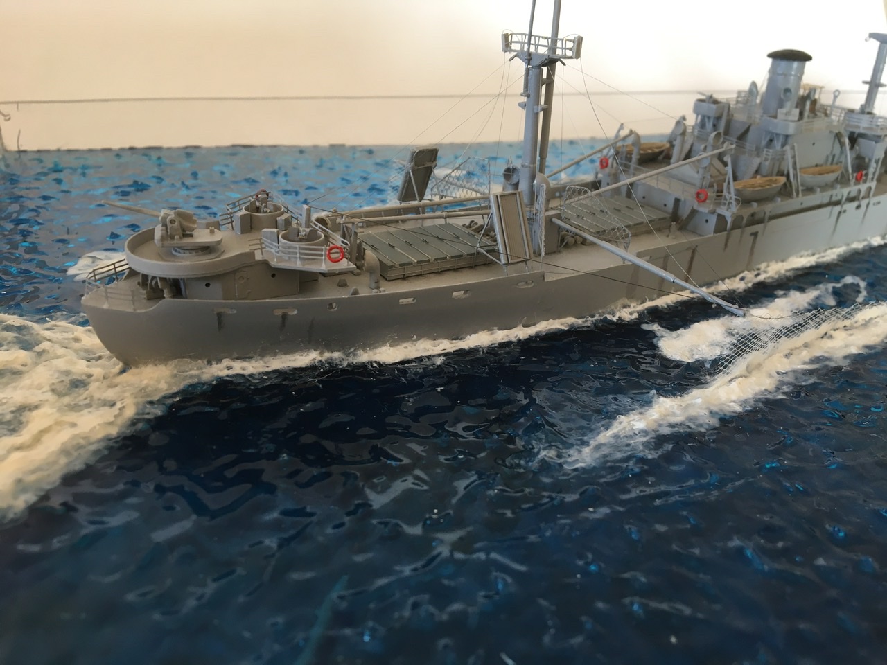

    Really like your model :thumbs_up_1: (wish I had your expertise yet). How do you connect the caenis thread at the mast (pic 1) and at the ship's side (pic 2). Looks really great in 1/700!!!
Jack
PostPosted: Fri Dec 28, 2018 7:12 am
Joined: Thu Dec 18, 2014 7:58 am
Posts: 155
Location: Oslo, Norway
I have the thinnest Uschi line but I haven't tried it yet. As I said, ask again in a week or two. That said, I do believe it is for all intents and purposes the same stuff as the fine flyfishing monofilament.
I have a long background in building wooden sailing ship models, so I use proper knots where possible, backed up with a bit of glue. At the ship's side this simply means tying the thread to the lower handrails. It is so very thin and fine that nobody can see the details of the attachment really. It is also tied to the mast or yardarm or whatever. The "clove hitch" knot is useful for this.
There is one line in the lower picture that is glued, the one that ends on the solid bulwark in front of the bridge. I used some kind of rubber cement, a small blob of it. Knots are better; far more controllable and much stronger.

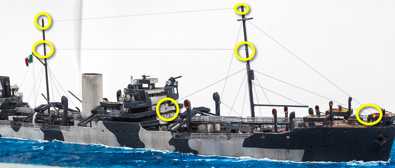

I used Usci Van Der Host 0,005 and 0,001. It proved great. It is flexible, elastic indeed, easy to fix and, being black, very realistic. See my Liberty Ship under torpedo attack in 2021 ship gallery (as Eugenio Lorenzini). It is 1/350, but works well as 1/700 as well
