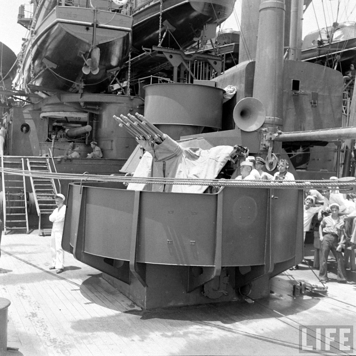

A question, and 2 comments regarding Maryland as seen in the August, 1941 photo below:
Is the raised tub sitting behind the 1.1" mount supposed to hold a .50cal MG? If not, what is it for?
The addition of that tub apparently required moving the projection booth inboard a bit.
Note that the halyards to the mainmast yardarms are no longer running down to the railings of the main deck break, but are anchored further inboard.

Thx, Jeff, for the pics. I agree that no director seems to be mounted in those particular tubs.
But, in the pic below from that August, does it not seem like there is a director in place for the forward 1.1s ?
To Sean's question
Quote:
Secondly, I see the inboard prop blades are truncated compared with the outboard. Typical of all the Big Five? All the Standard Battleships? Anyone know why?
I don't know if this was typical, but I'm guessing it had to do with excessive vibration from the tips relative to their placement at the stern.

PostPosted: Thu Oct 21, 2021 1:28 pm
Posts: 3841
The Mk 44 director was an "interim" install. The plans were for Mk 45 and Mk 49 directors to be available in first late 1941 and then in early 1942. So not many Mk 44 directors were made. (According to Friedman, a total of 85 were built) Since, USS MARYLAND didn't have the Power Drive for the quad 1.1-in mounts, installing a Mk 44 (or any director) was useless since the whole idea of the director was to point the mount automatically.
PostPosted: Thu Oct 21, 2021 7:52 pm
Posts: 8836
Thank you both. Those documents and Rick's points about availability and usability make their absence quite clear.
Love those little tidbits of information.
