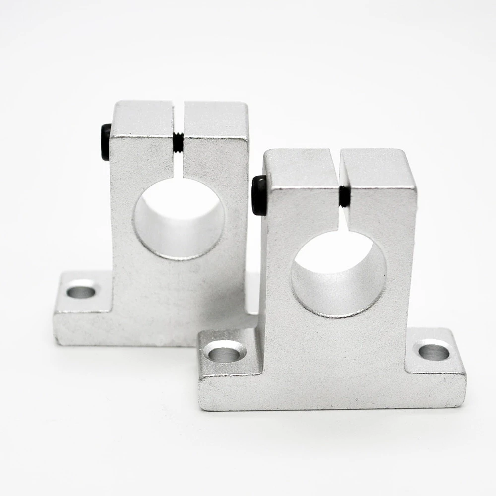

One tip that Wefalck contributed in my Hood build thread was the collet block:
The block can be clamped in the vice and allows for quick & accurate rotation of the workpiece. However, I've searched for an ER-11 collet block but cant find any?

Not sure they exist for ER11 collets. I don't use ER11 collets for workholding, as my workshop is largely built around (antique) horological machines that use either so-called B8 or B6 collets. I only use ER11 collets in the tailstock of my lathe instead of a drill-chuck, as this collet-chuck is smaller and gives better concentricity).
Another useful tool on the milling machine would be an indexer, but again, I am not sure they exist for collets smaller than ER32.
If one is willing to enter into tool-making, it may be possible to use some commercial parts and thus limit the amount of machining needed to make an indexer or dividing head. One could take an ER11 collet-chuck,
that are available with straight shanks in various diameters, a matching bearing bracket as now also available cheaply from vendors catering for CNC mills/routers, and a cog-wheel of suitable tooth number (dividable by e.g. 2, 4, 5, 6, 8, 10, 12 etc.). Then it is relatively simple to design an index stop. To lock the spindle a tapped hole through the bearing bracket with a thumb-screw in it works well. In some models the block is split and can be tightened.
Sorry for the huge images, but I just quickly picked them from the Internet.
