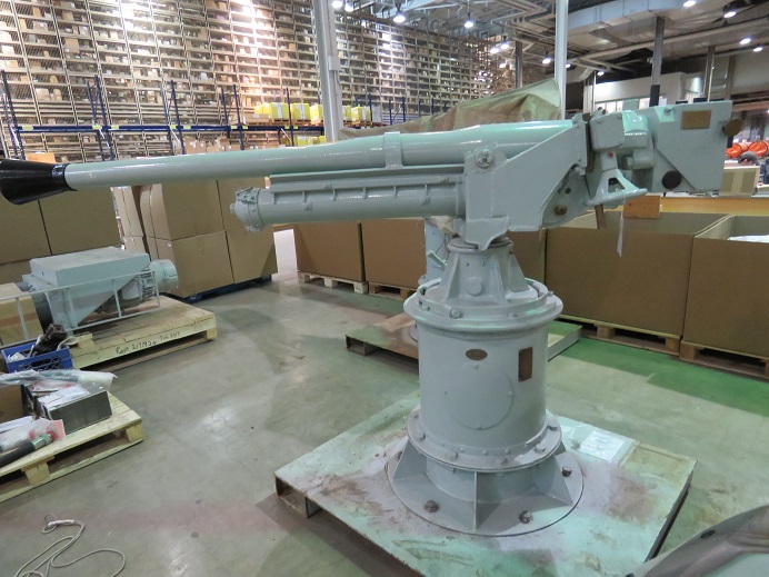

I believe this to be one of Bonnie's Saluting Guns. Still in use within RCN lines today.
It's a WW2 Ground mount 6Pdr AT gun, grafted onto a Pre-WW1 Vickers Sons and Maxim 3 pdr mount.
If you need more detailed photos, let me know.

Nice, thanks!

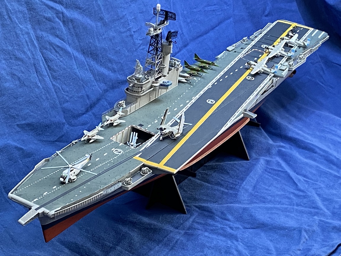

Hi Colossus lovers,
I have been quiet about this for a long time, but my 1:350 scale '25 de Mayo' is quickly nearing her completion, in time for the 40th anniversary of the Falklands War.
More to come within a few weeks.

Heller 1:400 kit: but with considerable surgery to make it 1:350. The fuselage plug for instance is 71 mm long.
The island is totally scratch built, and of course the flight deck extensions.

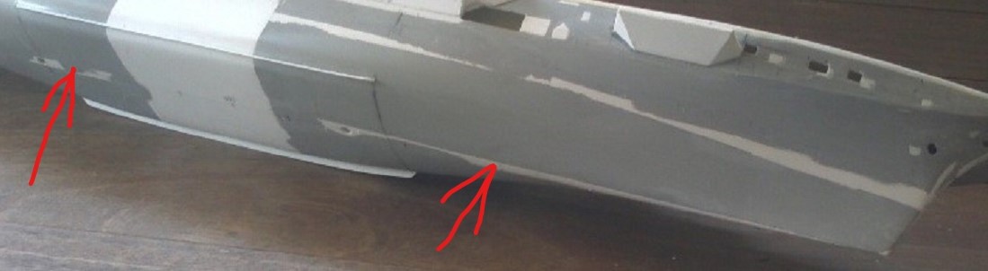

My model: sure I widened the hull, to 70mm on my model. I added wedge-shaped spacers where the halves joined, see the enlargement below. Since I used grey filler (Italeri) to smoothen the seams, the result looks a bit patchy.
I also increased the height of the hull to 55mm, by cutting at the waterline and adding strips there, but more importantly by replacing the flight deck with one made from 2mm polystyrene, on top of the hull (not inside on ledgers like in the kit), this was to make sure that the knuckles in the hull (fore and aft) will sit at the correct height.

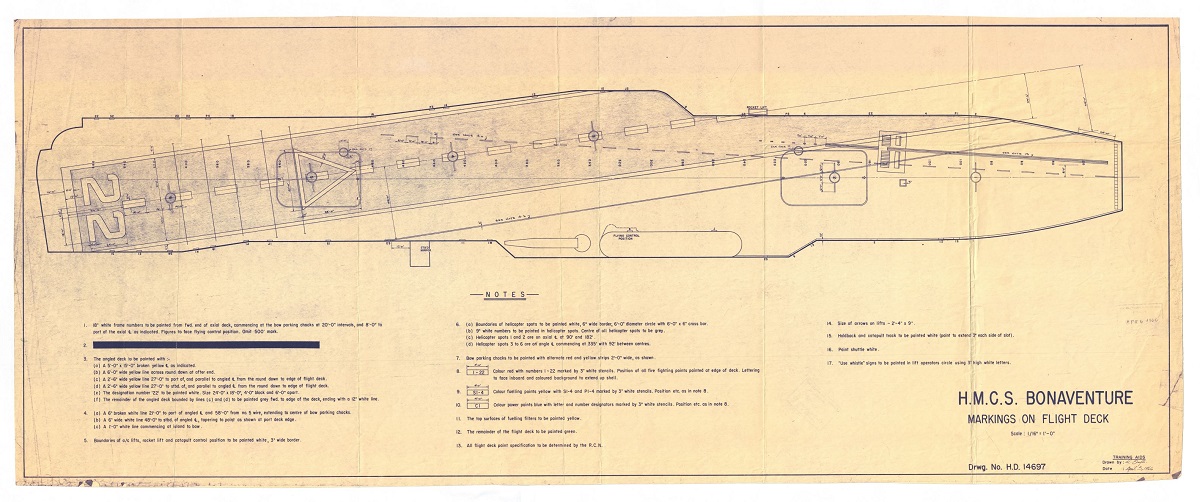

I have this file also in 3163x1325 size. Also a colororized aquarel showing top and side view, probably familiar to you. Right now I can't find the file, only a printout I made scale 1:400 in b/w. I believe the source of that one is "The Bonnie, HMCS BONAVENTURE" by J. Allan Snowie.

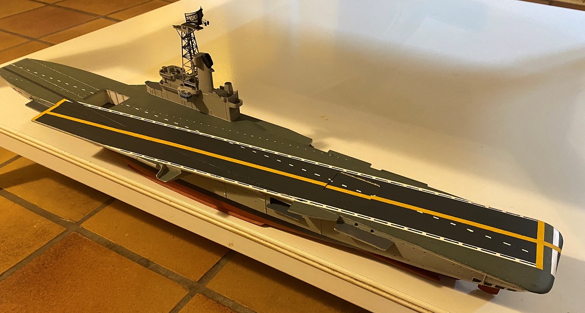

Two more updates, platforms and catwalks added, all painting essentially done. Now to add all antennas, railings, boats and floats, radars. And finally: the aircraft!
