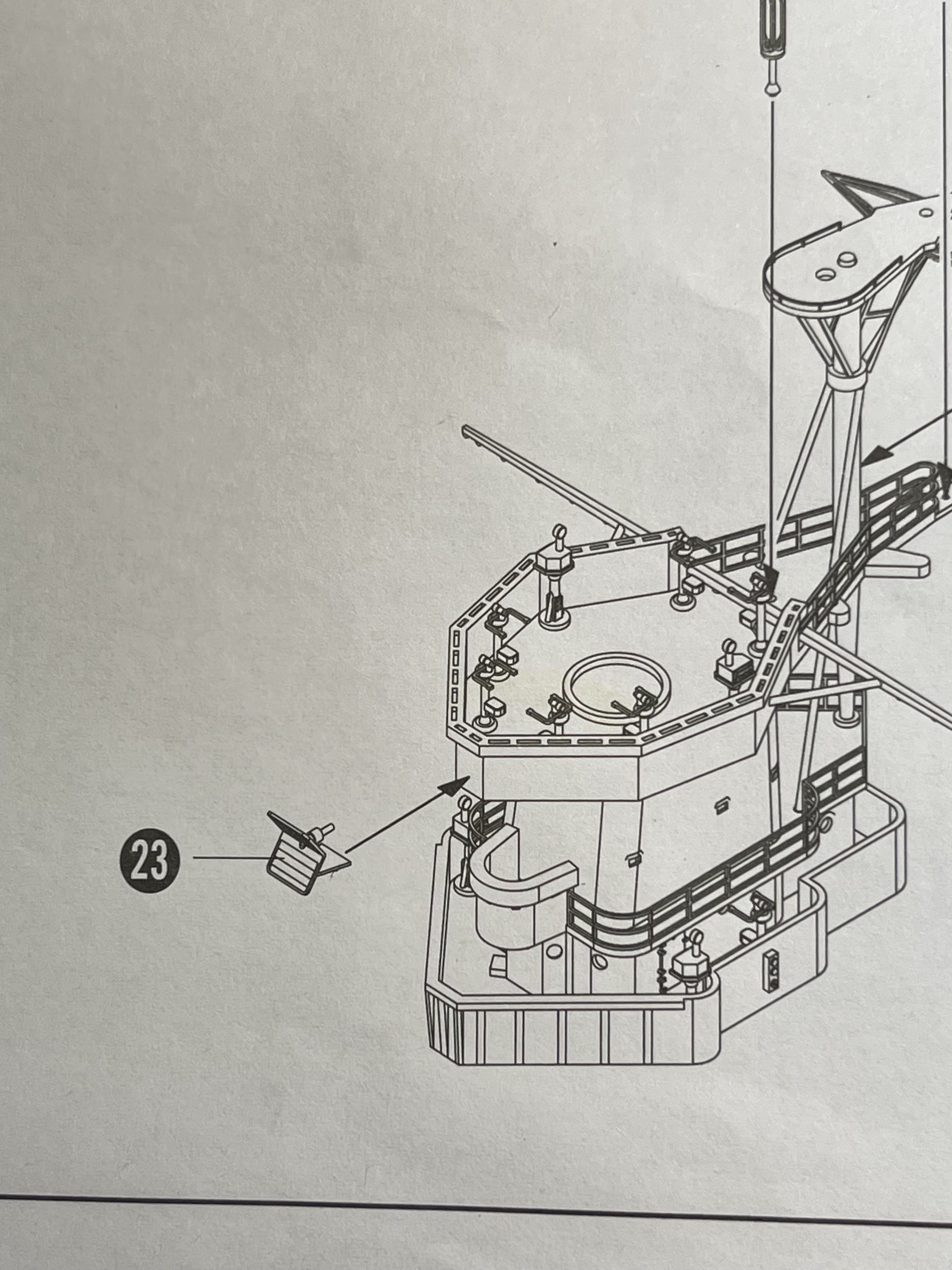

HobbyBoss would have you add the small antenna and platform seen in the instructions below to the face of the top level of the forward superstructure. Yet, I can’t seem to find that in pictures of Alaska during her 2nd shakedown cruise. I’m thinking I should leave it off. Anyone know for sure when it was added?

Thanks. I’m going to leave it off, but keep the parts in case photographic evidence shows up.

The object in question is the TDY-1 jammer antenna -- if you're modeling the ship at any point in 1944 (in camouflage) this antenna is not present. Photos of the ship in 1945 (in Measure 22 camouflage) show the new antenna added but I have not been able to find exact textual references defining when it was added. ALASKA's DANFS entry shows the ship arriving at Pearl Harbor 13 Jan 1945 and departing for the western Pacific on 29 Jan 1945 so I suspect this antenna was added at that time. Other changes to the ship's RCM fit that appear in the 1945 photos include AN/SPR-1 receiving antennas on the forward yardarms, DBM-1 radar direction finders on a yard below the foretop, TDYa S-band jammer radomes (transmitters at the deck edge near the catapults above the hangar and receiver bracketed to the rear of the foremast), and X-2A "Nancy" IR beacons below the upper fighting lights on the forward air defense station (10 level).
This photo shows most of the equipment very clearly: http://www.navsource.org/archives/04/1201/04020130a.jpg

Ian - that same photo is in Wiper's Alaska-class book. That's a much bigger photo - you can see the antenna there, but not in the photo in the book.
Appreciate the info - I am building her in late 1944, in camouflage, so I'll leave off the TDY antenna.

I don't have specific evidence of this, but wartime photos often had various electronic warfare equipment airbrushed out for security reasons so absence of an item in a particular photo isn't conclusive. Inclusion would be more substantive. As always, as many sources as we can find, but a ships configuration is always a moving target. It's a beautiful ship from it's clipper bow to the elegant profile.

Yes photos that were "released" to the news media were often censored for anything considered sensitive. However, many photos found at NARA from official USN files, are not censored.
Ian is likely right about when and where the TDY-1 and other RCM gear was installed. I have two photos of USS ALASKA at Hunter's Point Navy Yard "dated" the first week in January 1945. See attached. USS ALASKA went in for a brief availability. She has been repainted into Ms 22. A side note; Note in the second photo the cross marks at the top of the photo, this was done by the censor indicating that the antennas should be deleted in the "public released" images.

I have a two additional images taken at sea after leaving HPNY, dated 13 and 22 January 1945 (accuracy of dates in 80-G are always suspect), showing her painted in Ms 22. The HPNY photos and the one dated 13 January 1945, doesn't show the TDY-1 antenna or the SPR antennas yet installed. The photo dated 22 January 1945, isn't high enough res to see these antennas. PHNY starting as early as September 1944, was installing RCM gear on destroyers and I assume also on heavier units. At first this was primarily limited to "Radar Warning" systems, SPR-1, DBM, and early DBM "like" antennas of the "interim RCM suite". The "ultimate RCM suite" including TDY-1 jammer wasn't available until early 1945. Hence, I feel confident that the RCM gear on USS ALASKA was installed at PHNY in mid-January 1945.
