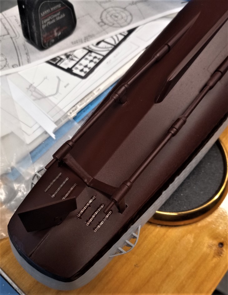

Got a bit of hull work done tonight - installed the corrosion coupons underneath adjacent to the screw shaft supports. These differ from Willie's JORGE JUAN in that there are only 3 rows per side and all in one line (per my photos of the ship in drydock in 1967):
Once they've been given a touch-up of lt. gray paint and the bottom of the hull oversprayed with clear flat lacquer, the small amt. of glue seepage along the edges will disappear. I'm expecting an order of gloss clear spray lacquer and then I'll be able to prepare the hull for decals. Once that's done I can then call the bottom complete and move on to getting the display board completed as far as the keel blocks are concerned.

Hi there Hank and all,
Excellent update. Once painted, a hull looks completely different. I have compared your paintwork with the picture of USS Stoddard in dry dock, and your choice of color matches the pic perfectly. It is a way darker color than the one I will be using in my own hull, that is much more red than brown, but the satin finish you have achieved is the tone I have always seen in ships in (or freshly out of) dry dock.

Willie,
Thanks, I appreciate your comments!! Actually, the color in the photo is quite a bit darker than the ship was painted after they finished the shaft work - but it was a quick overnight spray paint over just about everything on the hull (barnacles, dirt, sand, etc.) - that red was almost "bright" red and simply didn't look correct to me. Usually, the yard sandblasts the hull over a 1�3-day period (depending on size of ship) and then primes and sprays the final red paint as a last step. This was not done at the drydock period in which I referenced. It was also not done when we sustained battle damage in March 1967 and had an emergency yard visit in Sasebo, JN where my last photo of the depth charge rack was taken. That was also a quick & dirty paint job. It doesn't take long for a ship's hull to show the effects of sea water, salt air, and all the other climatic elements to ruin a new paint job!! Harbors are notorious for being nasty, dirty places where anything and everything floats around and can get caked on the ship's sides/bottom.
