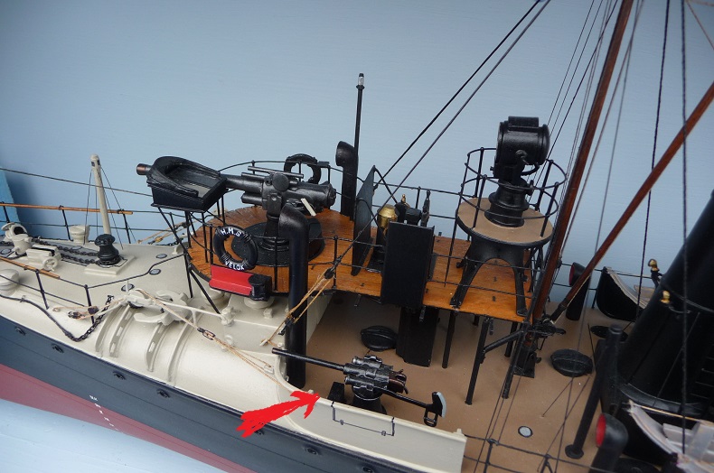

The navigation light is one option, but I'm not sure of it. I'm more leaning towards a part used for hoisting those funnels, perhaps with a wooden block attached somewhere forward or aft, depending on which direction they folded.
The picture you show with the Arrow is a pretty large scale picture, a navigation light at that bracket would most certainly be seen. So either it's just missing because they remove it during lowering or uprighting of the funnels, or to put it "on" if it's a real lantern, or it's just not meant to be there.

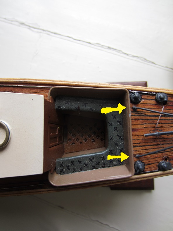

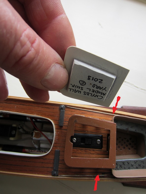

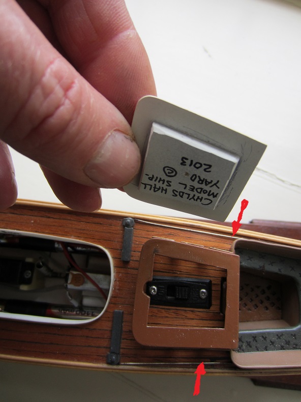

Hi all
These two pictures show clearly how I managed to make a �dog�s dinner� of what should have been a simple task. The two stay bars for the ensign flag staff should have been attached through two holes drilled in the aft lip of the cockpit (arrowed) not into the deck.
As the flag staff on the real vessel could be dismantled one assumes these stay bars threaded through the metal edge of the cockpit and were locked on the inside some how.
If I had got it right in the first place I would not have had to shorten the tiller slightly to get it to clear!
The pictures also show the seat cushions. One assumes on these vessels they were covered with either leather or �oil cloth�. I painted them a very dark grey/green but I am sure colours such as black or brown would also be suitable. The buttoning was reproduced with a fine DVD marker pen.
Dummy rudder control rods/cables were added along the deck edge (arrowed in blue) joining the two sets of deck mounted pulleys. These were made from fine wire and ran along side the cockpit edge.

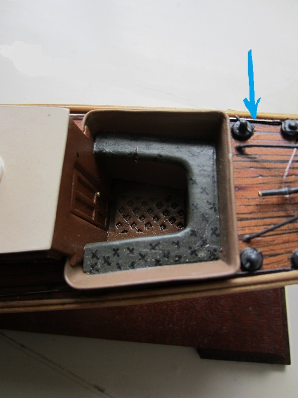

Hi all
I have already out lined how the boiler room roof was made removable so as to gain access to the internals.

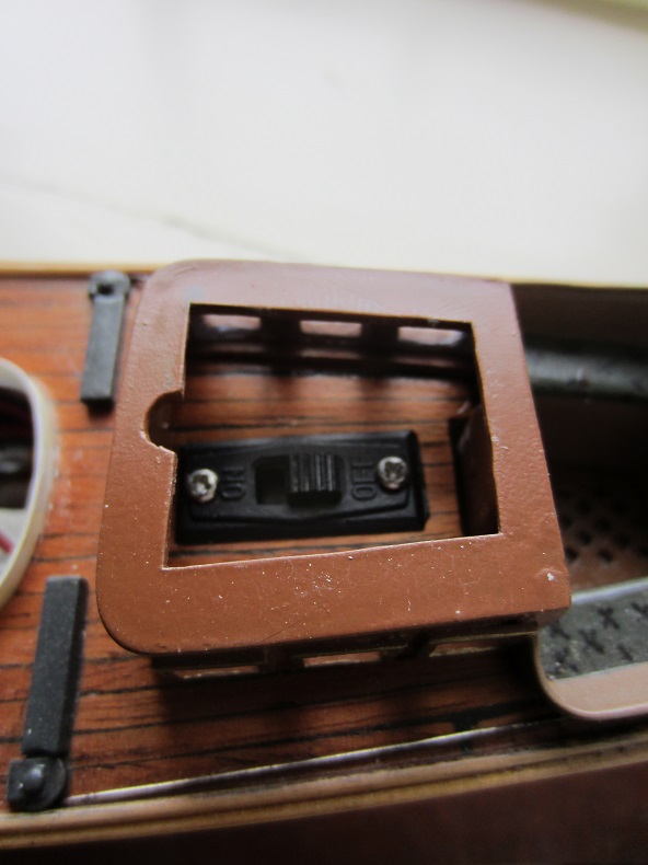

The roof of the cabin was also removable to gain access to the main on/off switch. I wanted to make sure the roof of the cabin did not get lost while sailing. I also wanted to make sure that the power switch was kept away from water which would certainly not do it any good.
To achieve these aims I cut a small panel of 4mm thick �Foamex� board to fit neatly into the hole in the cabin top. This was CA glued under the cabin roof. After a small amount of trimming it became a tight push fit. Cutting the �Foamex� with a slight taper helped and its in built flexibility helped keep the cabin roof fixed in place.
In these pictures you can also clearly see the dummy rudder control cables along the deck edge (arrowed).

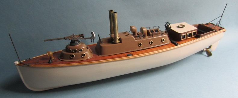

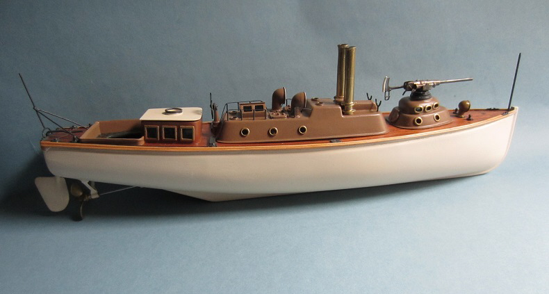

This forum based �on line build� is rapidly catching up with the real build. The final bits of detail, and the finished �on the water�photos will be posted, but they will take a little longer, so keep watching.
The one major item still missing from the model at this stage is the 3 pound QF gun mounted forward on the �fustrum�.
As I have previously said, in practise these weapons were not fitted unless they were absolutely necessary so I could have easily left it off the model. They were intended as anti torpedo boat weapons, but when mounted, their weight dragged the bows down in the water and must have affected the vessels performance considerably. How easy these guns were to use, and how accurately they could be, aimed from a small boat bouncing up and down, is questionable.
In modelling the gun I referred to line drawings/plans and photos I had of a 3 pound Hotchkiss weapon of this period. In fact I had already made a master and mould as I had previously resin cast five of these weapons at 1/48th scale for a model of HMTBD Velox. The picture shows one installed on Velox and arrowed so as not to be muddled with the 12 pounder on the conning tower roof.

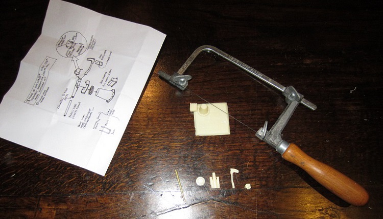

Hi all

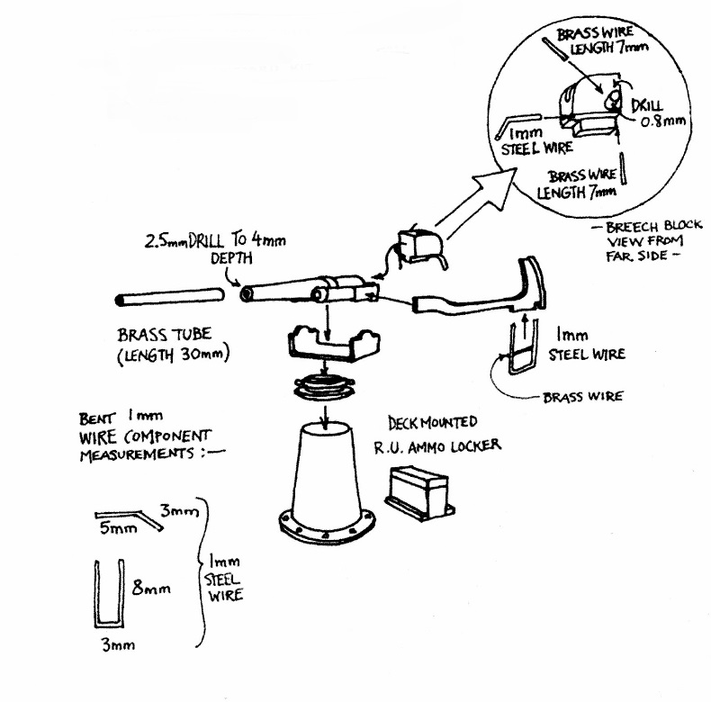

Here are just a few notes on casting the 3 pound QF gun in resin. These notes apply to any weapon/searchlight or free standing technically complicated unit or deck fixture.
Having obtained plans/drawings for the weapon I thought carefully how it could be dismantled into individual components.
These were not necessarily the individual components that were bolted together to create the original weapon.
I was important to think from the point of casting the components. If all the parts are cast on one casting base then you have to think carefully where each component�s flat surfaces will be. These are potentially the flat surfaces which will be in contact with the casting base and will therefore have to be sawn off. Generally (but by no means a hard and fast rule) these are assembly surfaces or faces. So when a component is saw off the base, the sawn surface, after sanding, will be the surface which is glued to its neighbour or possibly the deck or other part of the completed model.
That�s a complicated paragraph. Basically I�m saying �forget how the original gun was assembled and explode it into �castable� components� with their main flat surface in contact with the base.
I hope you understood this.
I have included a drawn sketch of how the 3 pound gun was divided up into its component parts.

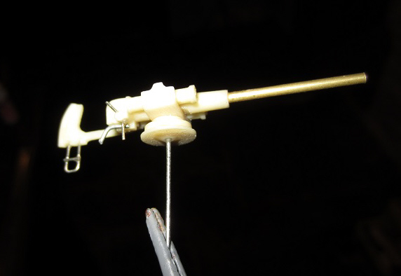

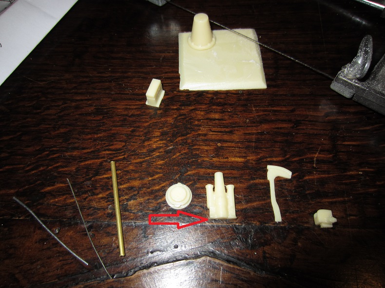

Hi all

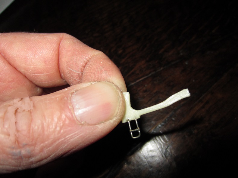

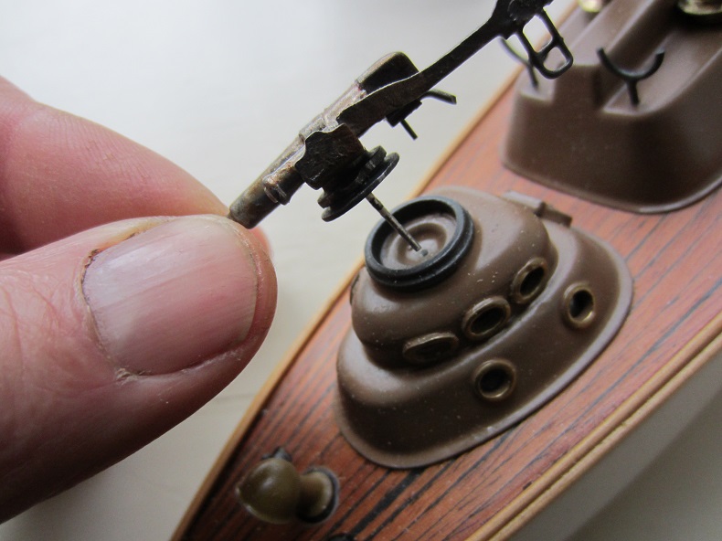

Here are a couple of pictures showing the one piece casting for the main components of the 3 pound QF gun. As with all these resin castings I found that a fine fret saw blade removes the fittings from the base easily.
The casting included a cone shaped gun mount and a deck mounted �ready use� ammo locker, both of which were not needed in this instance.
Lined up in the picture are the bits and piece to be assembled. From left to right:-
1mm soft steel wire.
0.5mm brass wire.
2mm brass tube.
Resin gun mounting ring.
Resin main body of the gun (the red arrow indicates the flat where the stock is mounted).
Resin stock.
Resin breach block.
Assembly was with CA glue and as many holes as possible were drilled with a pin vice before the component was removed from the base.
All pretty basic stuff really.
As this is 1/48th scale (technically large scale), I used the different bits of wire to create the detail on the gun. If this gun was being modelled at a smaller scale, PE fittings would have been better.
I have no immediate plans for learning the �dark art� of PE as mastering all the other, casting and moulding techniques is already giving me a bit of a �brain burster�.
0.5mm brass wire.
2mm brass tube.
Resin stock.
Resin breach block.

Hi all
The cast resin components of the gun went together very quickly. The thin and slender shoulder stock looks pretty fragile but it is surprisingly flexible and strong enough for the job. Lets face it this is a small scale model, so its not going to get knocked about (hopefully), even if it is a working model.
The wire components were glued in place and the gun was mounted on a short length of 1mm wire. This is useful for holding it during the painting stage and will also be used to mount in on the �fustrum�.

Hi all
The three pound gun was painted in a smart "Edwardian" polished gun metal colour with a slightly different bronze colour for the breach block, operating handles and barrel tip. The shoulder stock had a padded roll along the part that fitted into the gun layers shoulder. These were sometimes covered in a rope binding or sometimes a padded canvas roll. They would often be "blanco white" to make them smart. I painted it off white on this model.
A small hole was drilled into the "fustrum" so that the wire threaded into it. I did not glue mine in place, but I left the wire quite long to reduce the chance of the gun falling overboard. I could therefore sail (or display) the model with or without the weapon. I could also remove the gun if I was carrying out any internal maintenance to give me a bit more room.

- PICKETBOAT
- Posts: 474
- Joined: Wed Jul 21, 2010 2:44 am
- Location: Dumfries, Scotland
Re: RN Steam Picket boat (1900) 1/48th Scale
Hi all
Well after the brief look at the civilian version of a steam picket boat, here are a couple of pictures of the nearly completed RN version I am building.
It only remains for me to add some minor small fittings and these will be covered in my next few posts.
Hope you like it so far.
